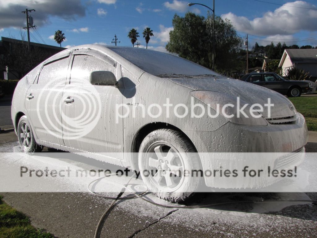

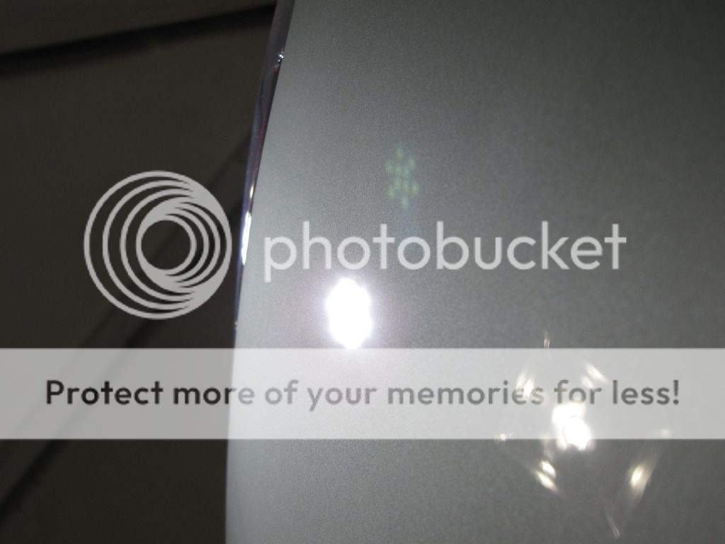

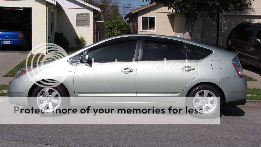

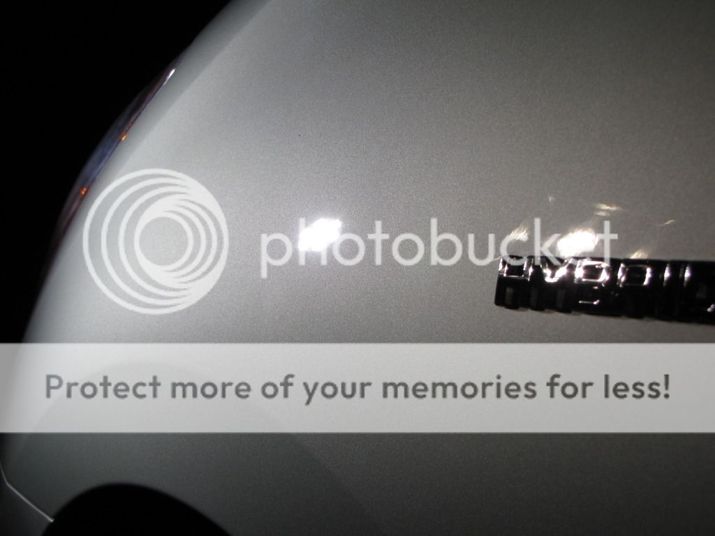

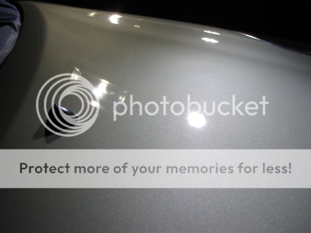

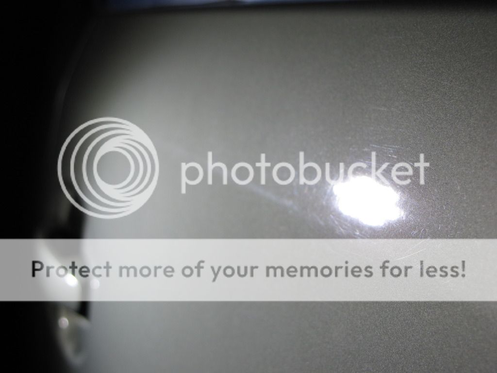

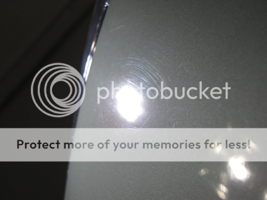

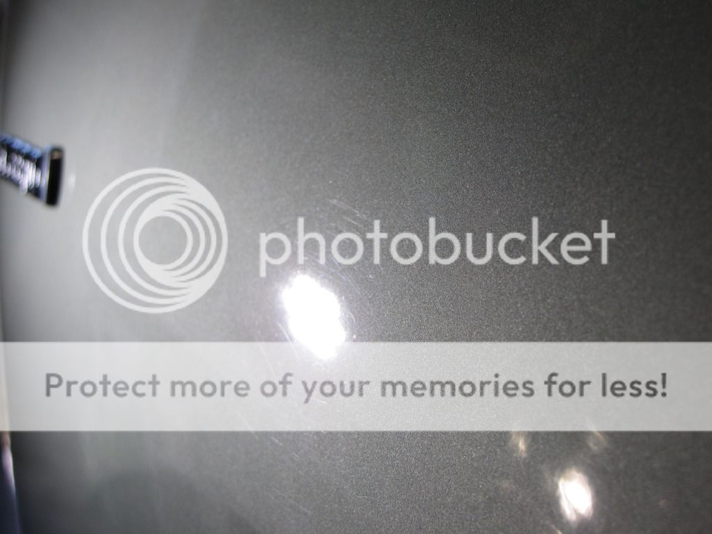

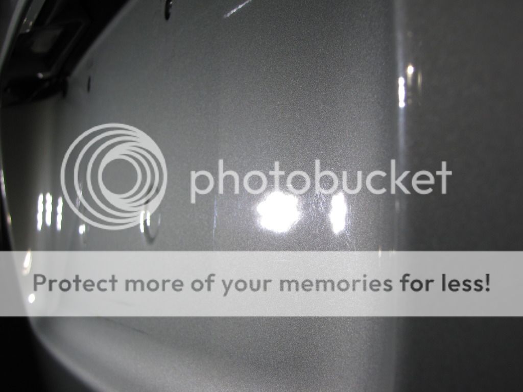

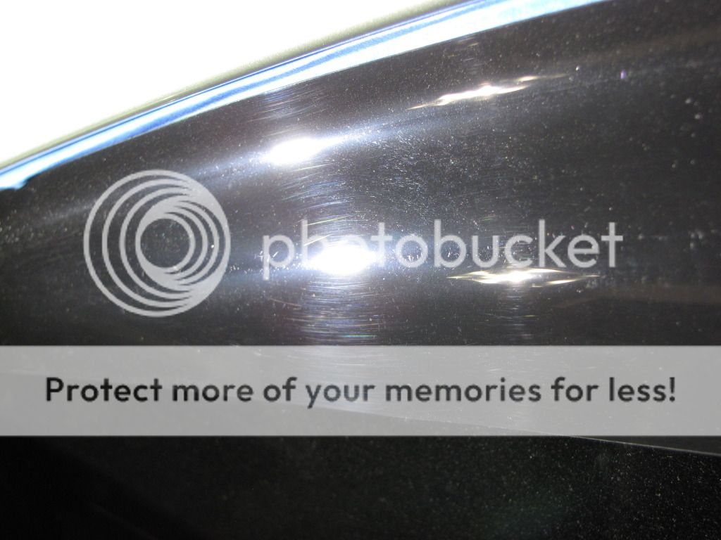

    Some pics for now. She used to like having the dealerships wash the car after it was serviced under warranty before I started detailing cars. So all of the damage was created by them.​
    Full write-up on my portfolio site. ;)

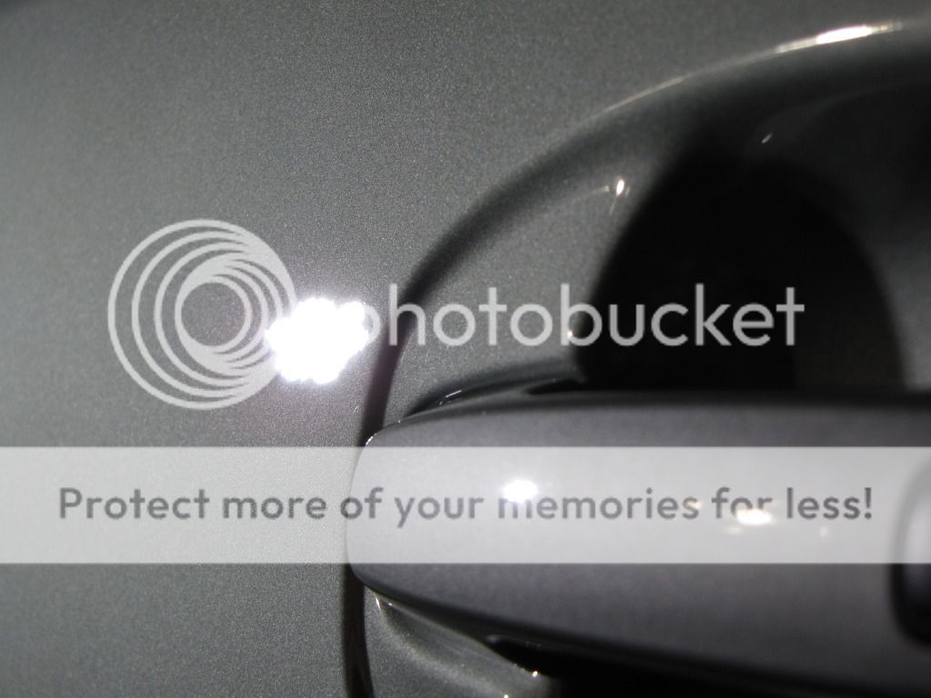

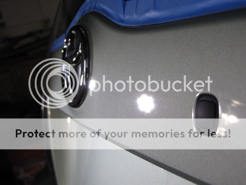

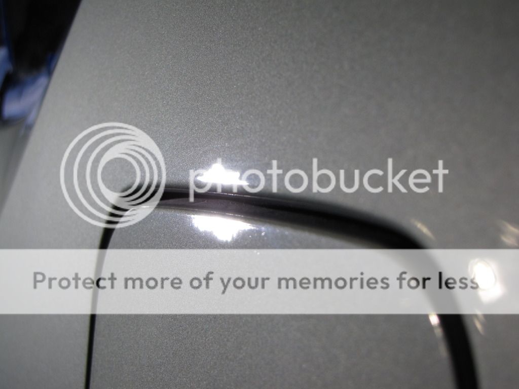

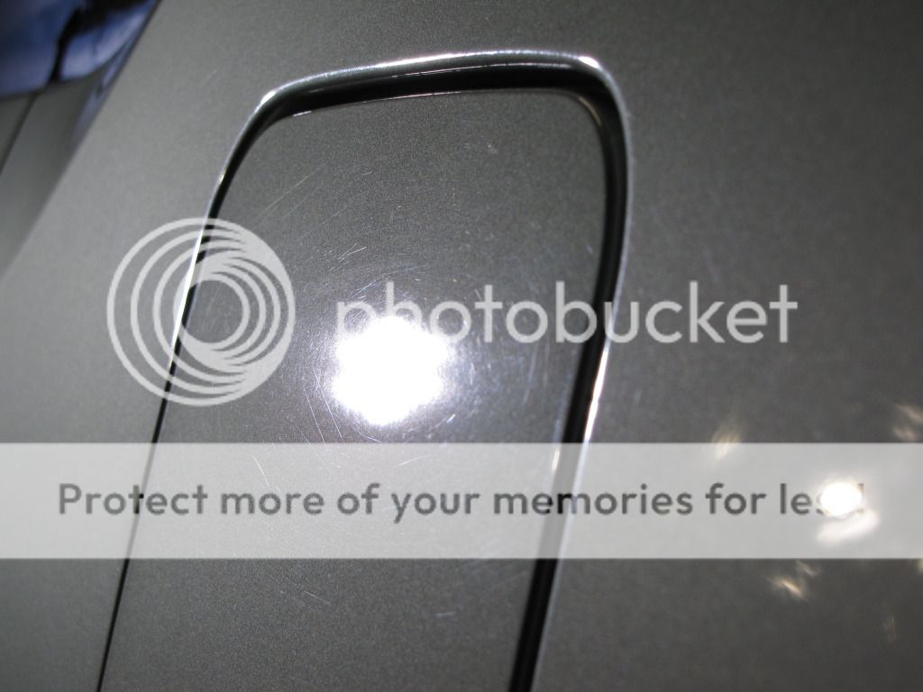

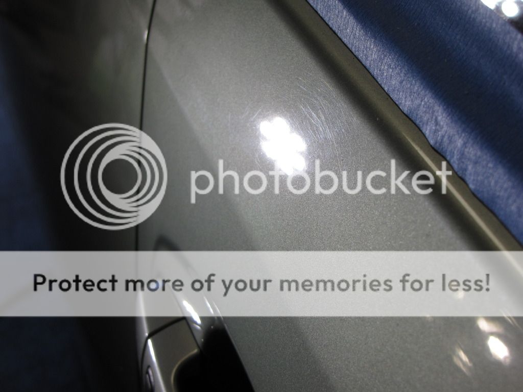

    Starting with the wash and decon

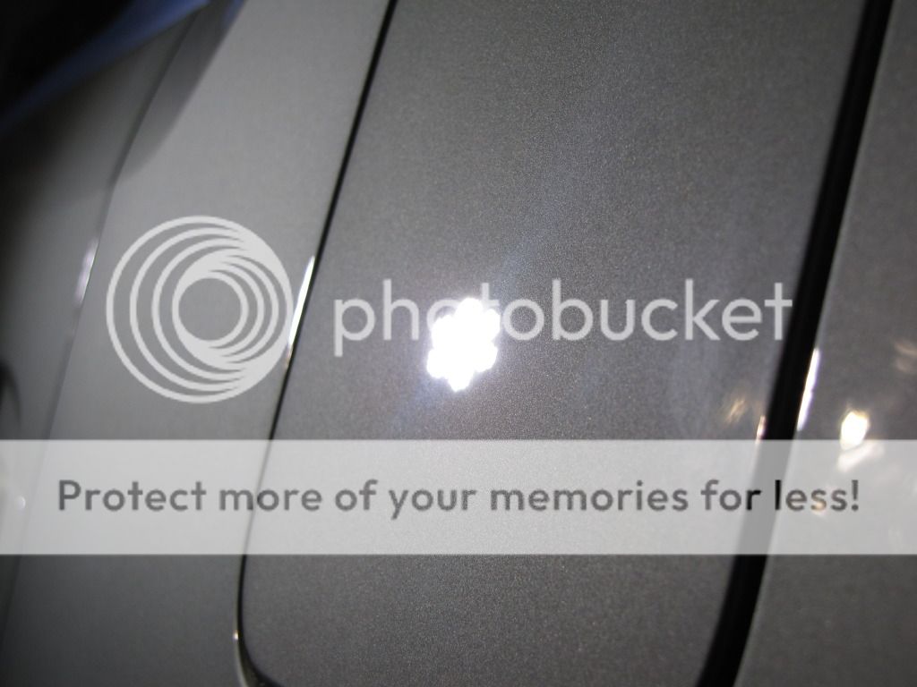

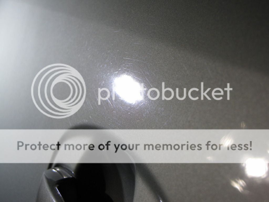

    Swirls and marring in the paint. Hood before
    After

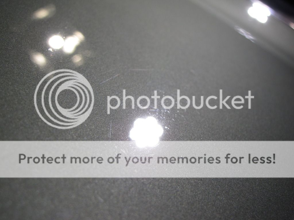

    Fender before
    After

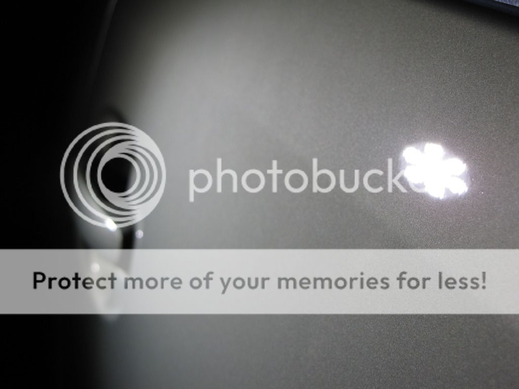

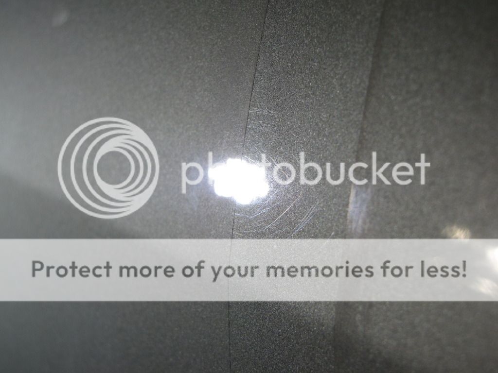

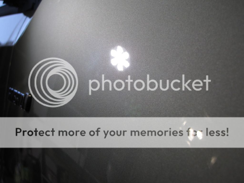

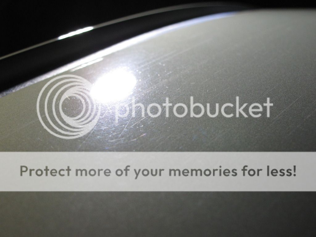

    Driver's door before
    50/50
    After

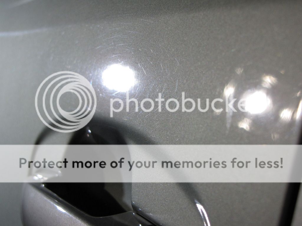

    Rear door before
    After

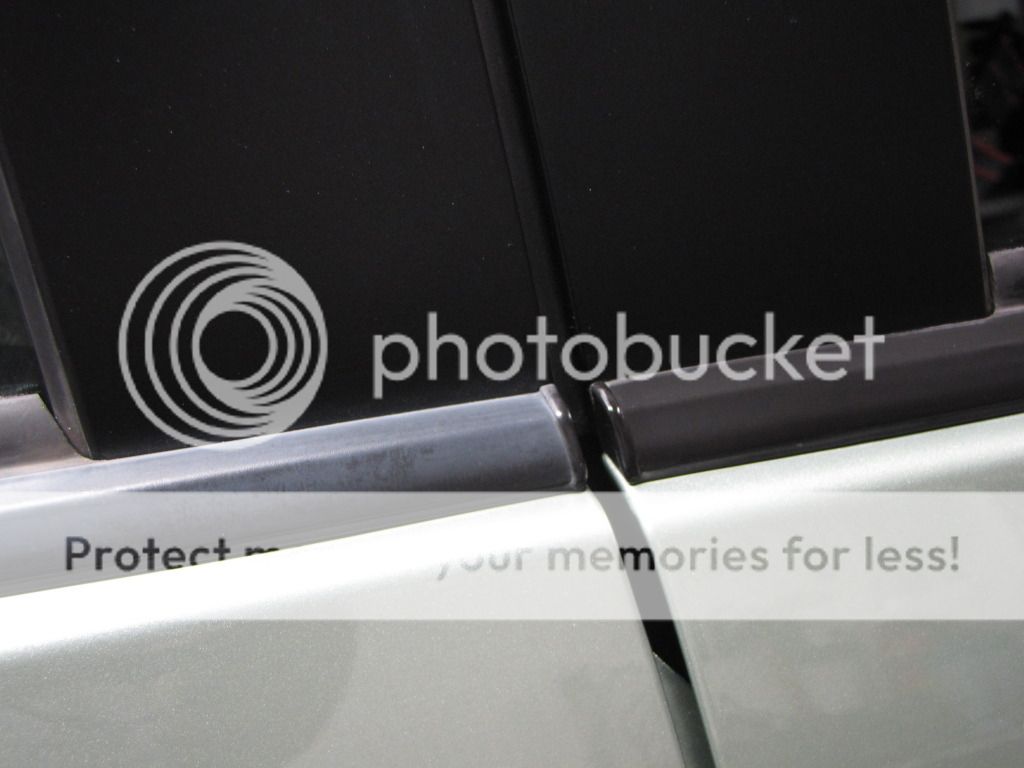

    Windor visors to be corrected as well

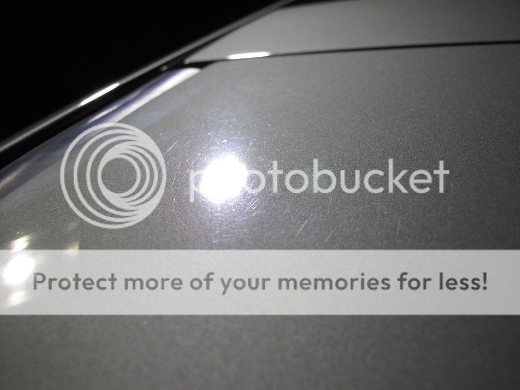

    Marring on the roof pillars

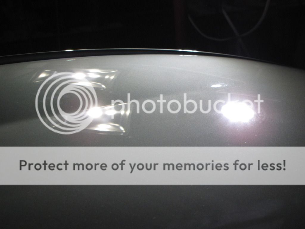

    Roof before
    After
    Qtr panel area before
    Corrected

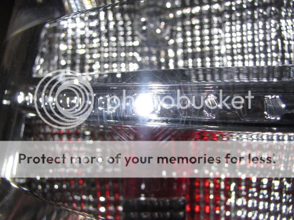

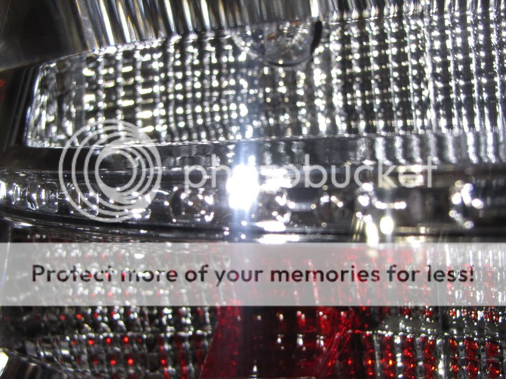

    Tails before
    Corrected
    License plate area
    Upper half
    After
    Right qtr panel
    Corrected
    Right side roof pillar
    Corrected
    Right side of roof
    Right rear door
    Corrected
    Pass fender
    After

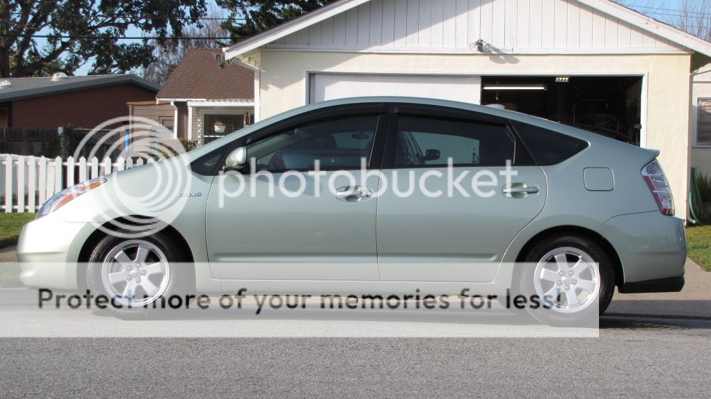

    50/50 of the trim dressed

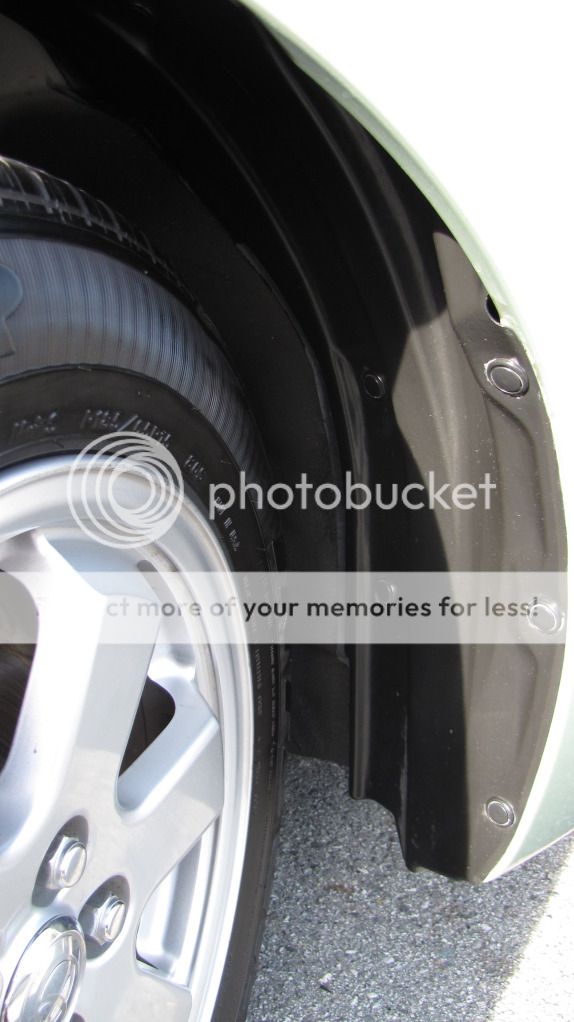

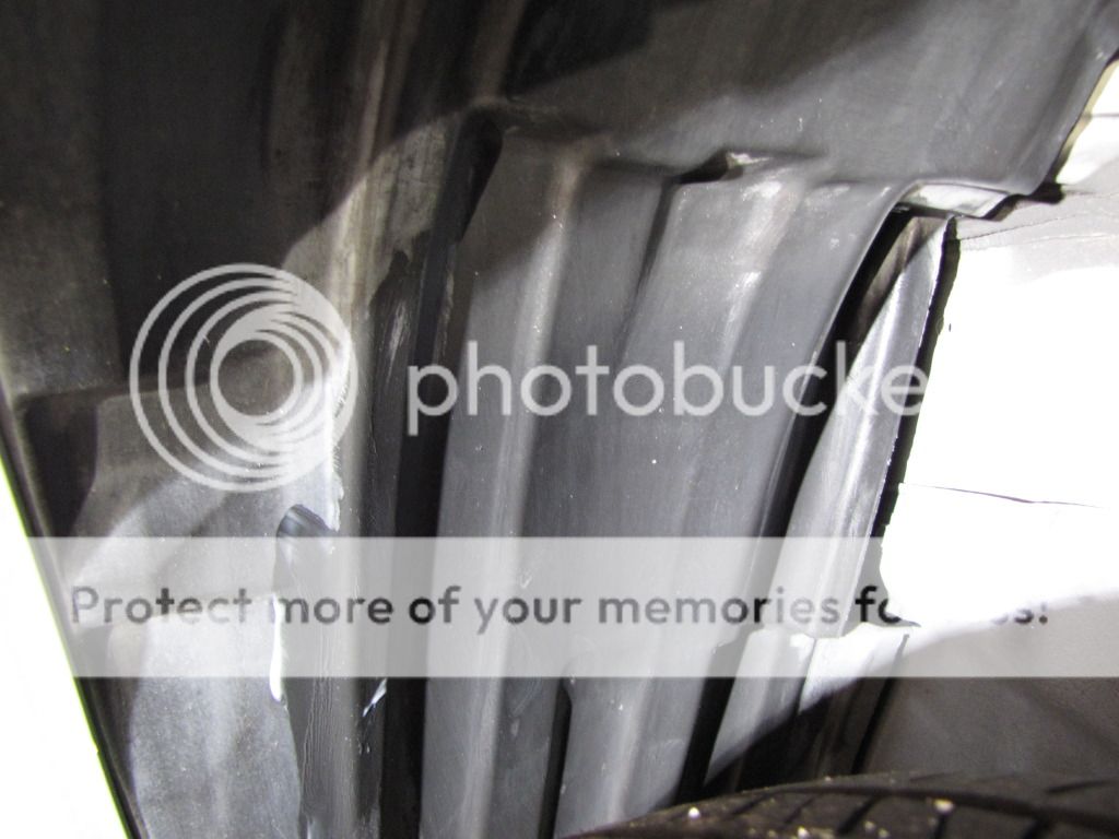

    Wheel well covers gets dressed as well

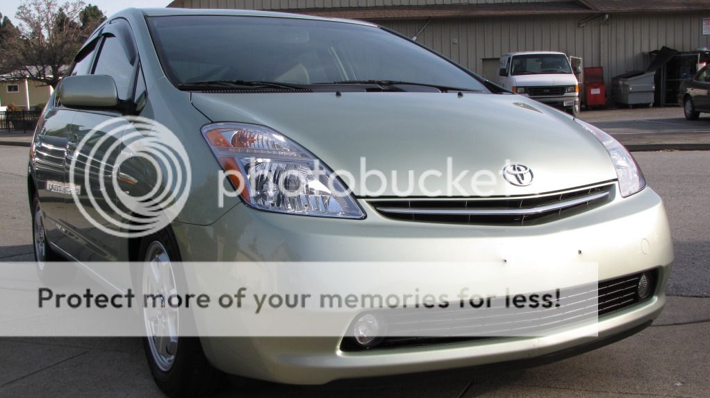

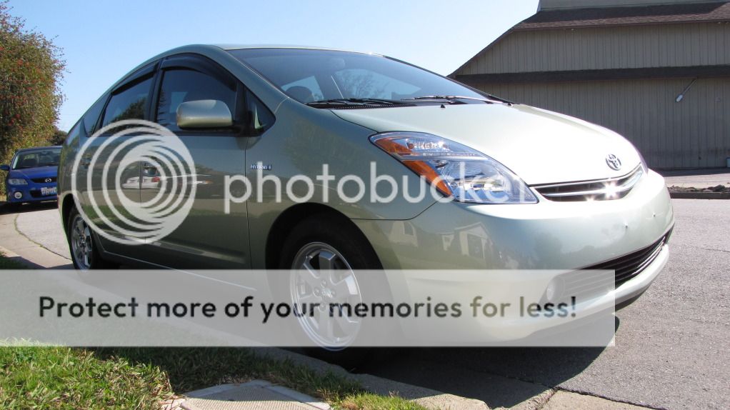

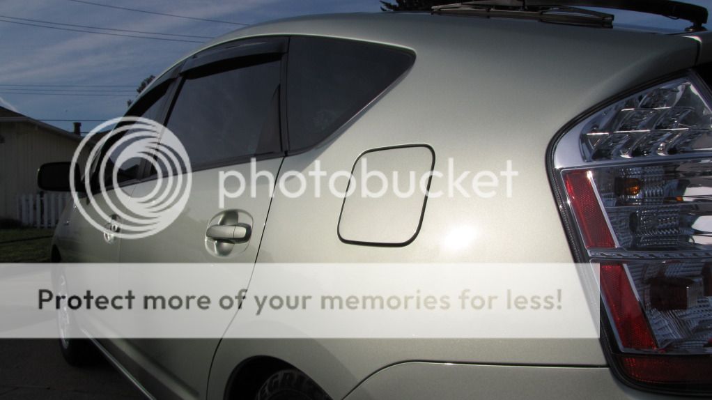

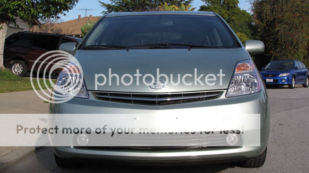

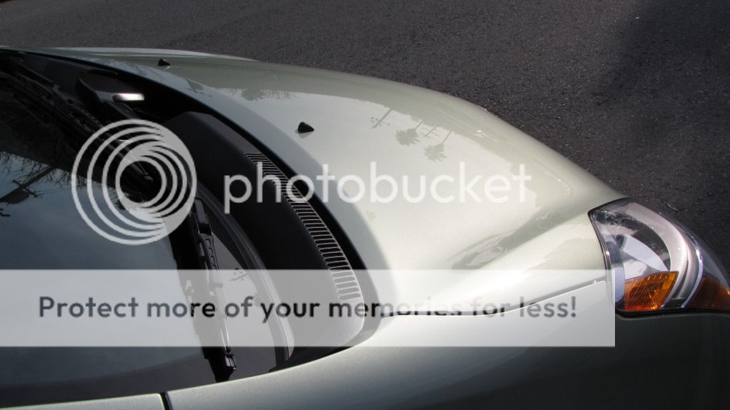

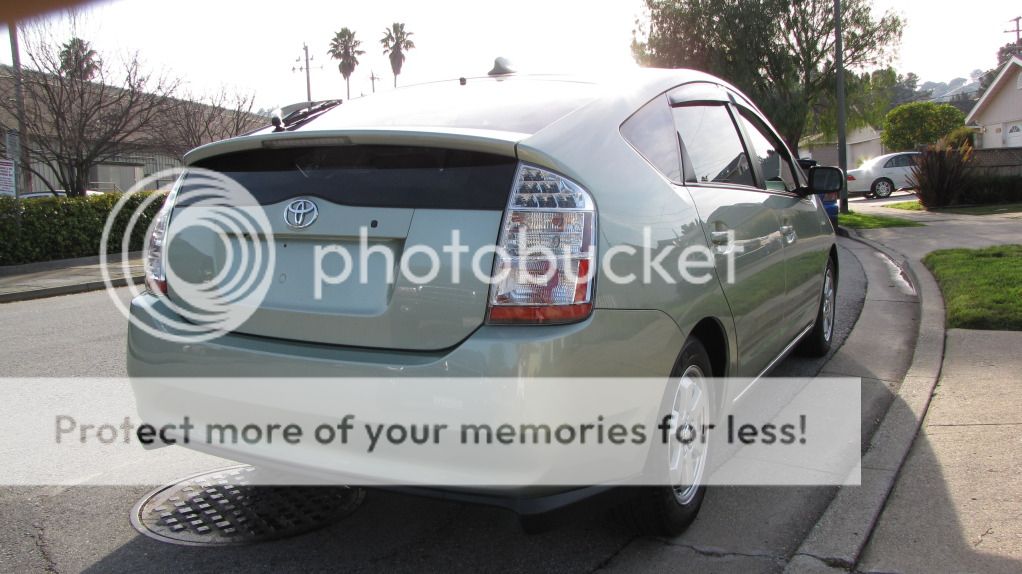

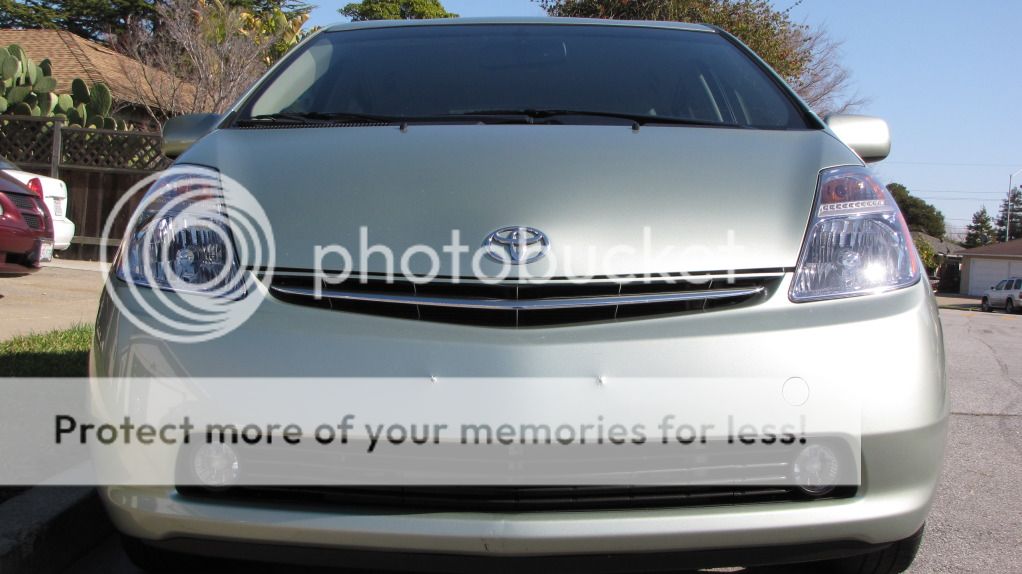

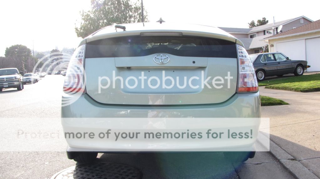

    After Opti Coat. Grill is dressed as well

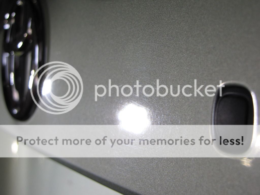

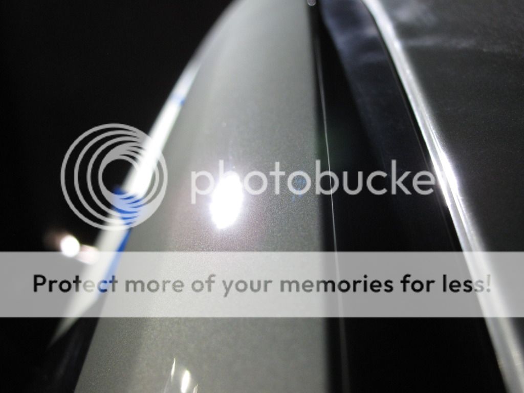

    Nice. How do you get it to not have hazing like the second picture?
  3. drew935
    drew935 Member
    Jan 22, 2011
    168
    23
    Nor Cal
    Thanks!
    The second pic shows swirls done by the dealership. Hazing looks a lot different.
    The paint is corrected with a DA polisher.

    Last pic is like my car. Tint and no wheel covers. Looks 100% better.
    That opti coat is the shizzle. Wish you lived by me.
