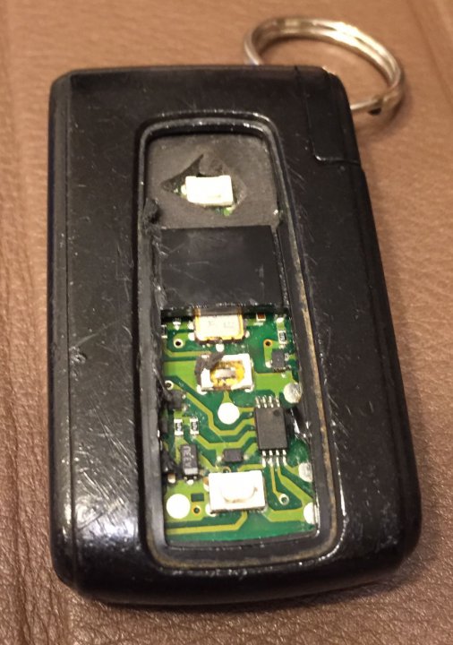

  18. daschick
    daschick Junior Member
    Jan 11, 2008
    San Carlos, Ca
    THANK YOU THANK YOU THANK YOU!!!! And what's more this thread is linked to on Amazon. I was concerned about buying a FOB on eBay and not being able to return it and then I found one on Amazon with Prime! Got it in two days, went to my car at lunch, checked the moon phase, did my dance and IT WORKED! THANK YOU.
    The only difference in my experience was I didn't hear the last lock/unlock confirmation, but the remote lock/unlock works fine as does everything else.....
    We have been living with this slowly deteriorating FOB. But now I will dissect it, replace the switch and see if I can print a new case.....
    Thanks again for this post!
