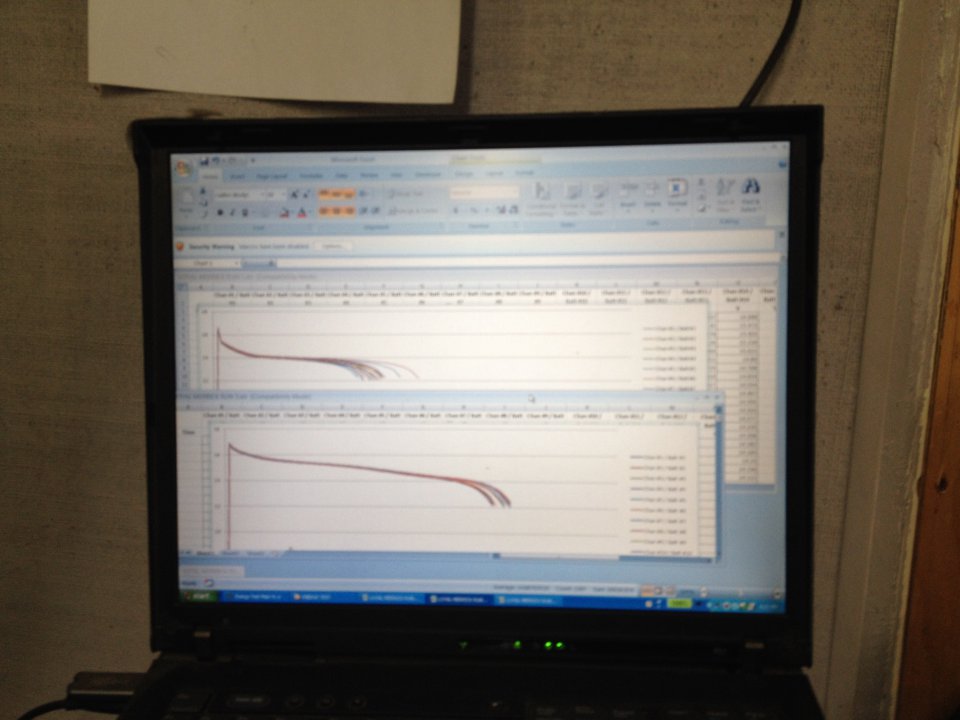

    So, Mile Hybrid Automotive here in Denver sold me in the idea of a "battery reconditioning."
    They took it out, completely discharged it, charged it back to 100%, and then back down . Or soemthing to that effect. This is supposed to rebalance and therefore breath new life into the pack as a whole.
    Below is a picture of the before and after discharge curves. Each line is a individual battery in the pack. Notice the spread before: the batteries are drifting apart. Notice the reduction of spread in the after graph.
    bwilson4web, Robert Holt and giora like this.

    Doesn't the car do this automatically itself? I'm sure I've had times where it does some jiggery pokery with he battery similar to how you describe - right down to 2 bars for a long time, then slowly slowly charging upto 7/8 for a long time.

    I have read that this deep discharge-rapid recharge cycle can be done to NIMH batteries and I believe that the effect is that the heavy charge rate tends to "melt out" the accumulated metal spikes leading to the anode or cathode, which gives the battery a renewed lease on life. (I have done this, but only with tiny AA sized NIMH batteries). The effect is not permanent, however, as in a normal use cycle the metal will slowly re-deposit and ultimately kind of short out the cell.
    The alternative approach is to replace just the defective cells in the Prius battery pack to return it to "balance", and I think that is a viable approach if you are willing to fool directly with the 200 volt battery.

    No the prius only goes down to like 20% then up to 80%. This was a total discharge among other things.

    They charge $400. Ouch. And no this is a proprietary process. These guys are pros.
