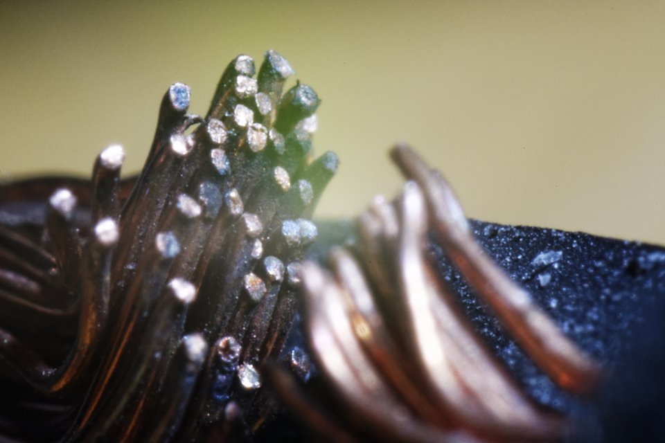

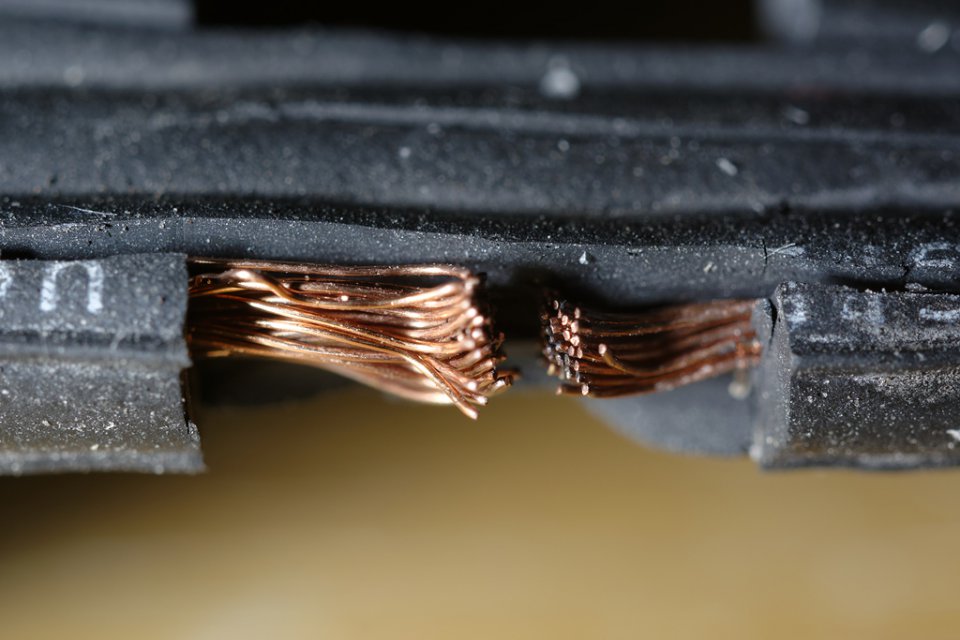

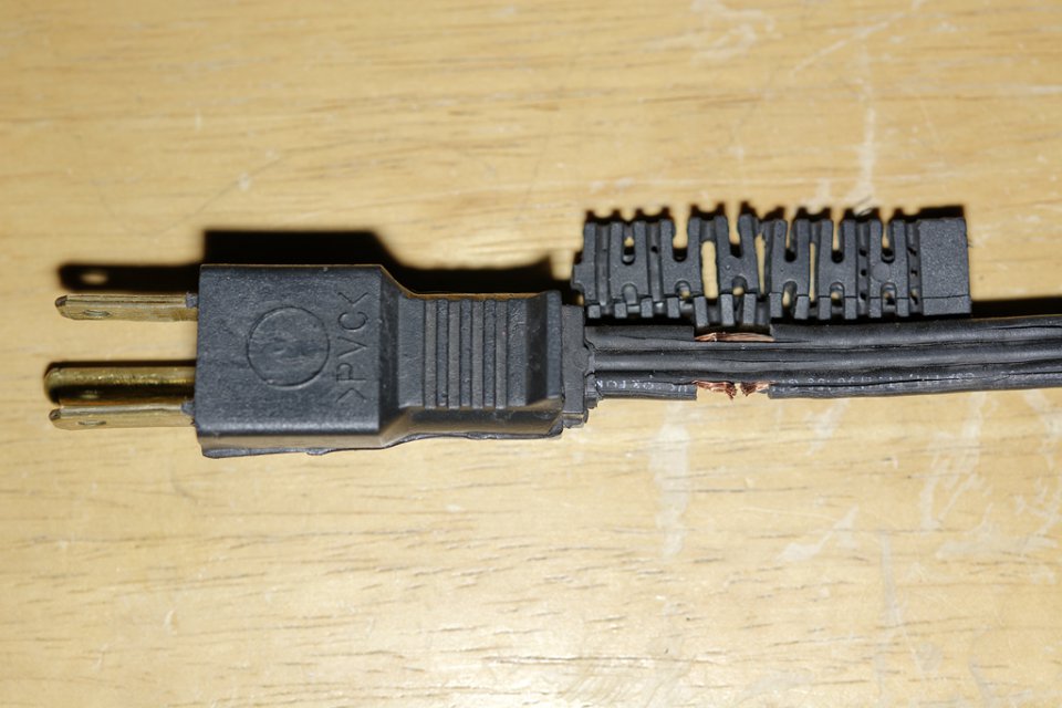

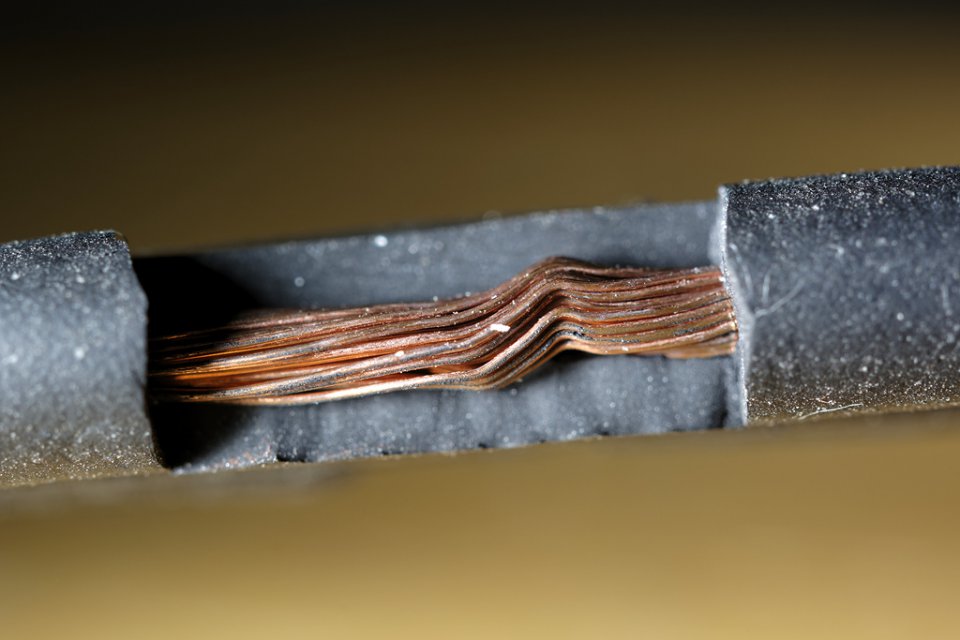

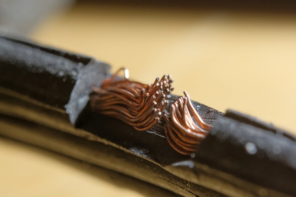

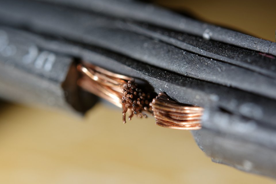

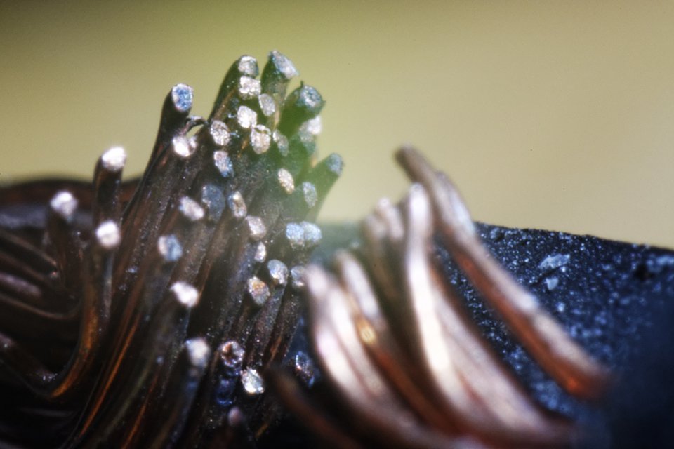

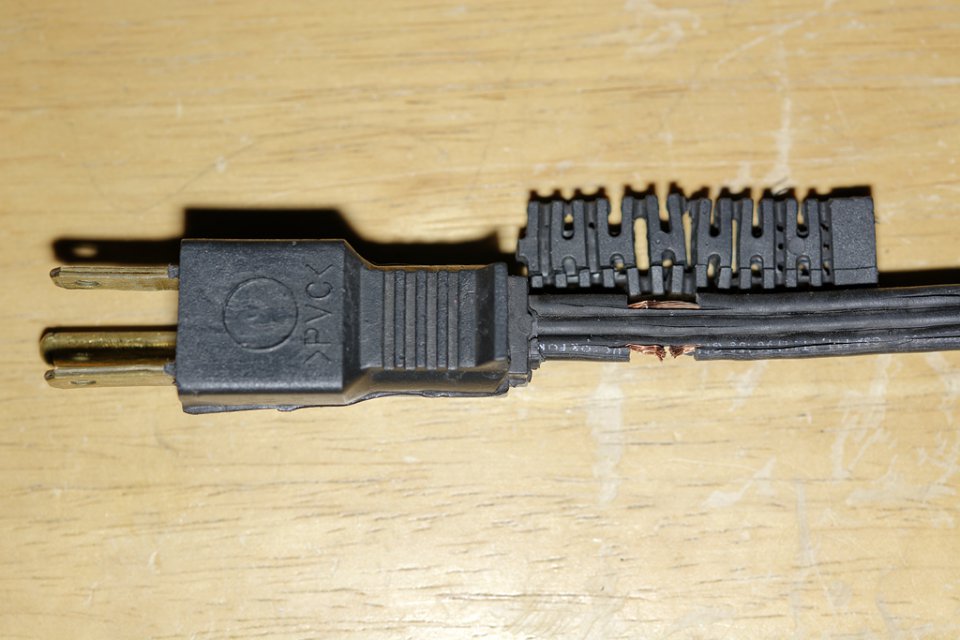

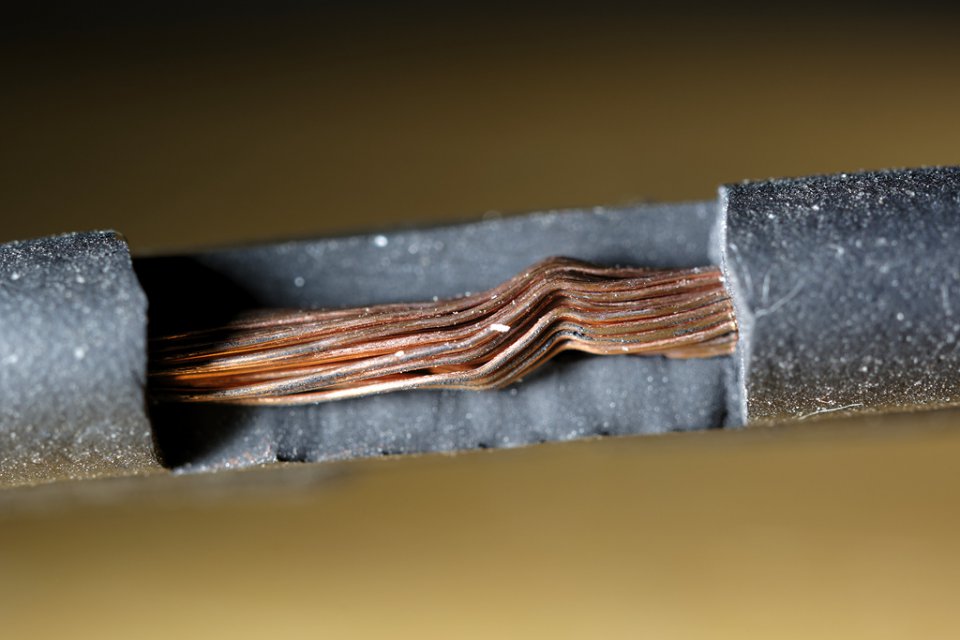

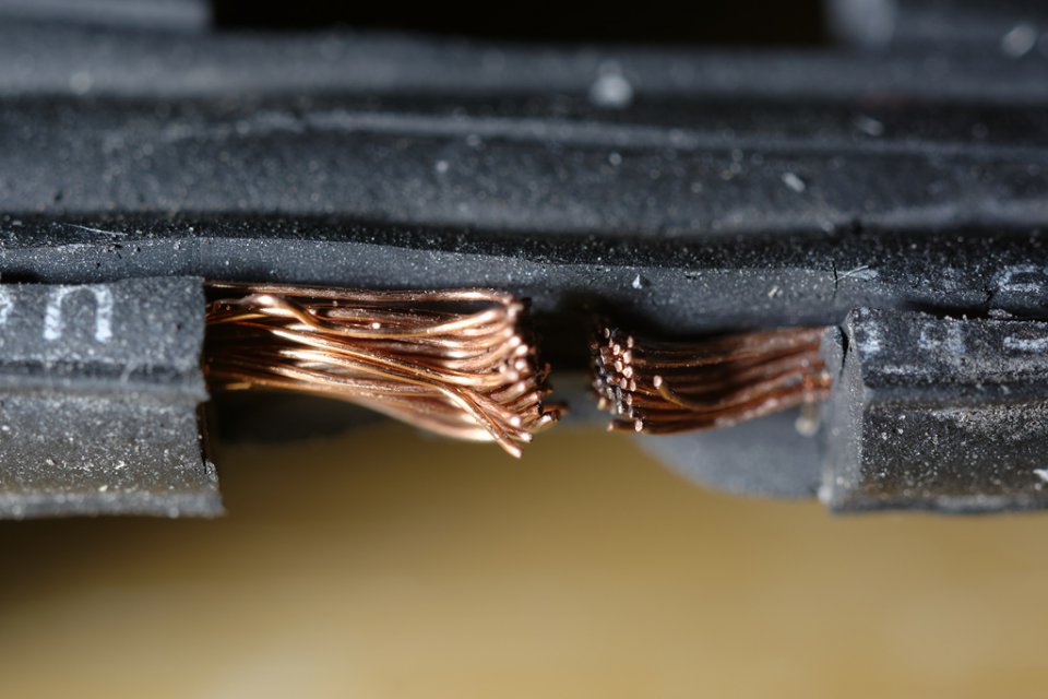

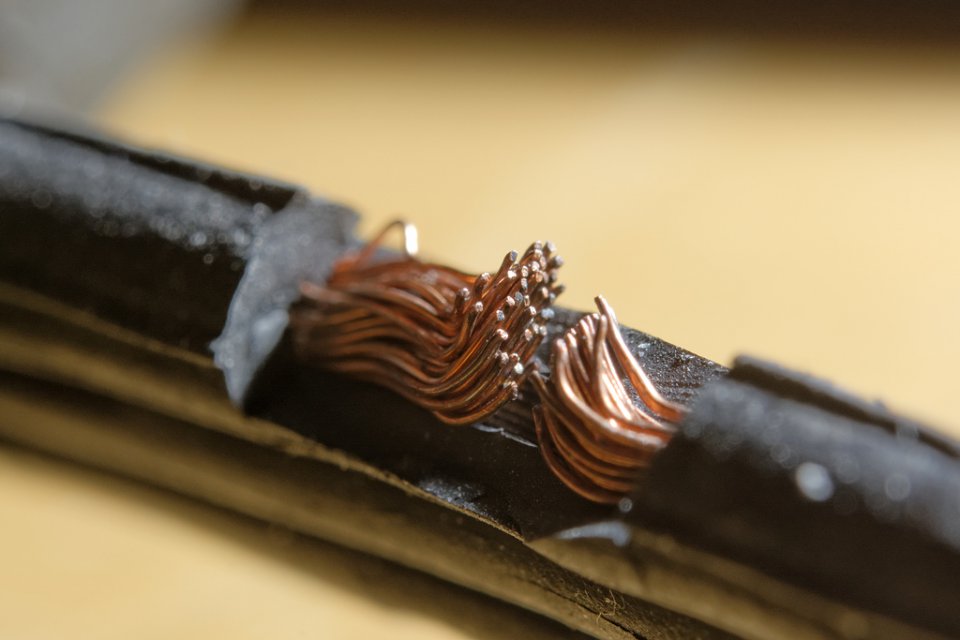

    Ok, here is something interesting... I found the original plug with the suspected severed wire inside. True enough, one side sort of snapped upwards and had small burns on the ends, while the other side was unusually deformed. Could they have been that way from the factory originally?
    At first, I started slicing lengthwise after the ribbed support. Since I found nothing there, I took off the rubber support and saw a small bulge obscured by the ribbed support near the body of the plug. When I sliced it open, I saw the cut and but relieved it didn't escalate into the adjacent wires to become a full blown short. [​IMG]:eek:

    Which is why I added a short heavy duty extension to eliminate stress on the hard wired cord to the EBH. The EBH plugs into the extension eliminating daily use of the EBH plug.
    What about adding an integrated 5 or 10 amp breaker to the power supply line? The EBH only draws about 3.5 amps at start up which would drop a bit after the unit heats up.
    Lastly after speaking with Toyota about my situation they are sending a forensic investigator over on Monday to see if they can determine a cause.

    "A full blown short" is exactly the kind of failure you want. It is the easiest to detect, and exactly what the breakers in your electrical panel are made to detect. A full blown short would have sent a couple sparks, the breaker would have tripped and the entire circuit shut off. In the morning you would have woken up to a cold car with a blown breaker. Flip the breaker back to turn it on (as most people do without thinking why it was blown in the first place) and it would immediately trip again. Not until you unplug the offending appliance would the circuit come back to life. That is what you should wish for, not a quasi-failure that causes it to have thermal runaway.
