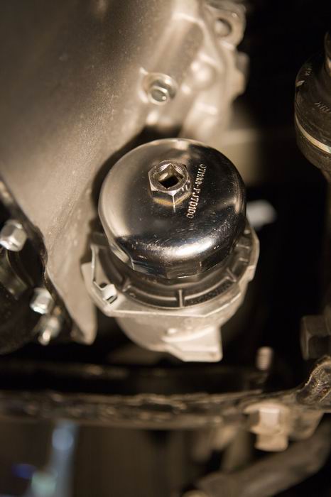

    Is my memory failing again ? I thought the Prius oil wrench is 64 mm ?
    I admit that 65 and 64 mm sound about the same to me, but I remember complaints that generic 65 mm wrenches did not work well.
  7. Mike500
    Mike500 Senior Member
    Mar 1, 2012
    2,593
    767
    Some are marked 64, while other marked 65 mm, will fit. The only real way to know is to try it on a filter cap.
    While quite expensive, this "OFFICIAL" Toyota factor service tool is the only one that is "guaranteed" to fit.
    Toyota - OIL FILTER WRENCH Part Number: 09228-06500-02
    And, it pushes the "locking tabs" out of the way automatically. The Assenmacher TOY640 and many others do not.
    I do NOT see Toyota changing the size or design for many years.
    I've used mine twice, and I think it is worth it.
  8. Mendel Leisk
    61,379
    42,239
    A plain steel socket works fine too. It covers the 14 faces to maybe 1/2" depth, doesn't have the extra extension and slots, does not seem to need them. Seriously, that locking tab might as well not be there, never holds things up for me. The Toyota socket works fine, to be sure, but it's not a necessity. This is Honda socket, the same 64mm inside dim., 14 face:

    I would search this site for the oil filter removal tool. Do not buy the cheap plastic one, but the better metal one.
    Oil is cheapest at WalMart.
    There is a plastic cover for the engine under the car. Getting to the oil filter requires removing some clips which are easy.
    The most dangerous thing is getting the o ring in the correct place. There is a grove in the plastic oil filter cap about 1/8 inch up from the base. This is where the O ring goes. Make sure you thoroughly inspect where it is on the part before you remove it. If you screw this up, all the oil from your car will instantaneously drain onto your garage floor and you will / might do damage to your engine.
    Also, there is a metal clip on the plastic cover for the filter that needs to be moved out of the way so you can unscrew it. Do not forget to do this.
