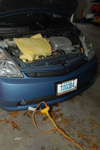

    <div class='quotetop'>QUOTE(FireEngineer @ Sep 10 2007, 10:00 AM) [snapback]510014[/snapback]</div>
    I use two different sizes. It is more a matter of personal taste and available materials. I use the larger diameter insulation cut in half lengthwise and folded in half cut to fit the individual upper grill opennings. These are force or "compression" fit and are almost completely unnoticeable. I use the smaller diameter insulation uncut and placed around the lower grill. The two lengths are twist tied with black ties to ensure they don't blow off (as had happen on Barbara's).

    I just reinstalled both the upper and lower. I used the same method as before except now I have an EBH. Tomorrow morning will be my first go at using an EBH for a trip.

    I've been using both the engine block heater and the blocked front grills now, this is my second winter season. I've had absolutely NO issues whatsoever with either of those interfering in any way with the Defrost or compressor. Actually, the air from the defrost gets hotter faster with the EBH, and engine temps don't cool down as fast with grill blocked.
    i believe there is still sufficient circulation throughout the engine with the grill blocked. The block just minimizes the direct flow of cold air directly onto the motor. I'm actually going to install my block again tomorrow. I've been using the EBH now for about two weeks, but without the grill block, the engine temp drops very very quickly after startup.
