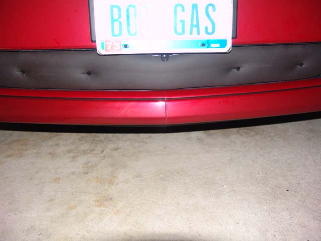

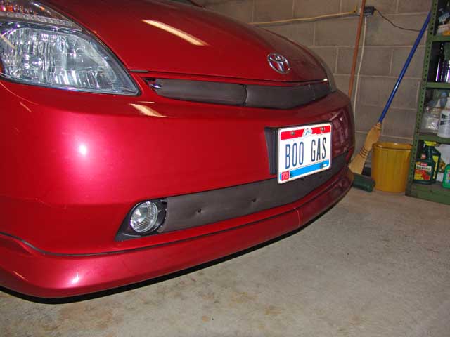

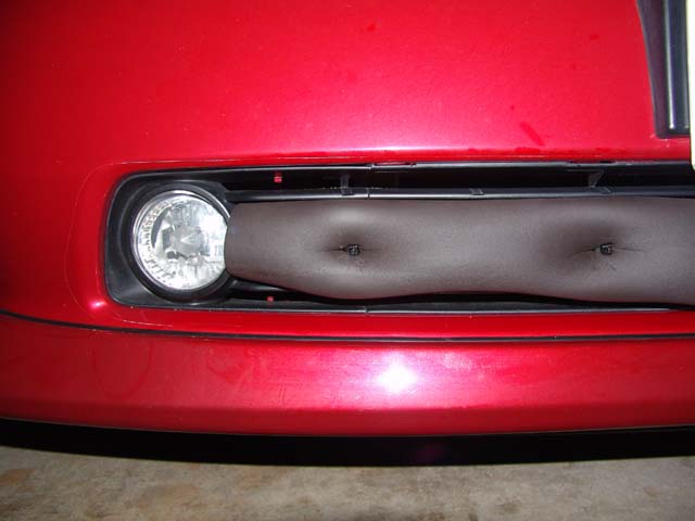

    Well like I said a few pages back I would do this when I got a Can-View sometime next year. Well its next year and I have a Can-View :D Plus the temps finally look like they are going to be below 60 degrees for a change. Looks like the next 10 days will be around the mid 30s.
    I did whats now known as the efusco method or as I like to call it the Super-Cool-Ultra-Mile-Per-Gallon-Gas-Saver-Winter-Time-Block-Grill-Jay-Groh-Method-Superfly. :D
    I went to Lowe's and bought one length of the 1" smooth black stuff with the sticky stuff. Cost about $6 after tax.
    I cut the stuff in half and it was the perfect fit for both top and bottom.
    On the top I just stuffed it in and zip tied it to the chrome grille.
    The bottom piece I put zip ties around the center slots so I could adjust the foam as needed. I can open the top and bottom slots if the temperature gets too warm.
    Lessons learned on this project.
    1. The sticky stuff that comes on the foam pipe insulation is worthless. At least after you pull it off. I tested a piece and when you peel it off the sticky stuff sticks to the car and rips off the foam. I just left the plastic peel off stuff on the foam.
    2. When you lay on the ground in front of the car near the horn be sure to take the FOB out of your pocket so you don't accidentally press the panic button. You may go deaf for a while and have to change you pants.
    I will report back on my results.
    Here is what it looks like.
    Close view of the bottom grille.
    Here is the bottom open up for the top and bottom slots.
