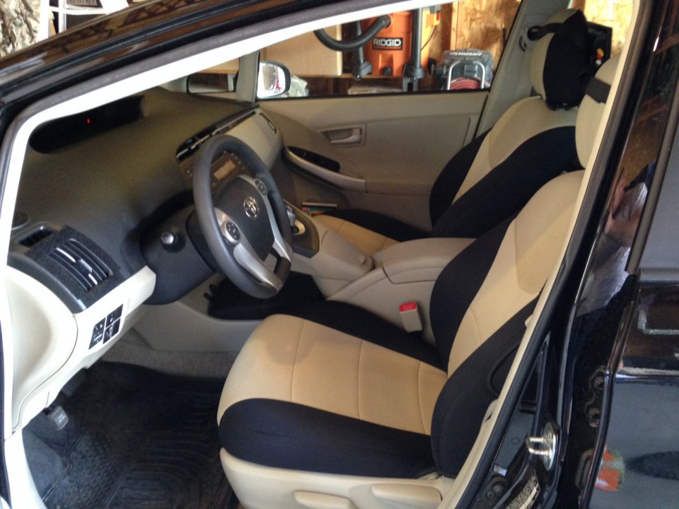

    Since the first few months of ownership I made a few modifications to help the interior survive my Army life. Husky molded floor liners keep the mud out of the carpet and Cover King Neoprene custom seat covers keeps the fabric clean. The windows were tinted to include a UV blocker clear layer on the front window to keep the heat down. That is about it until about two months ago.

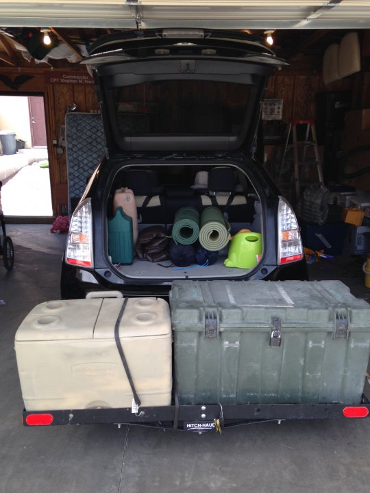

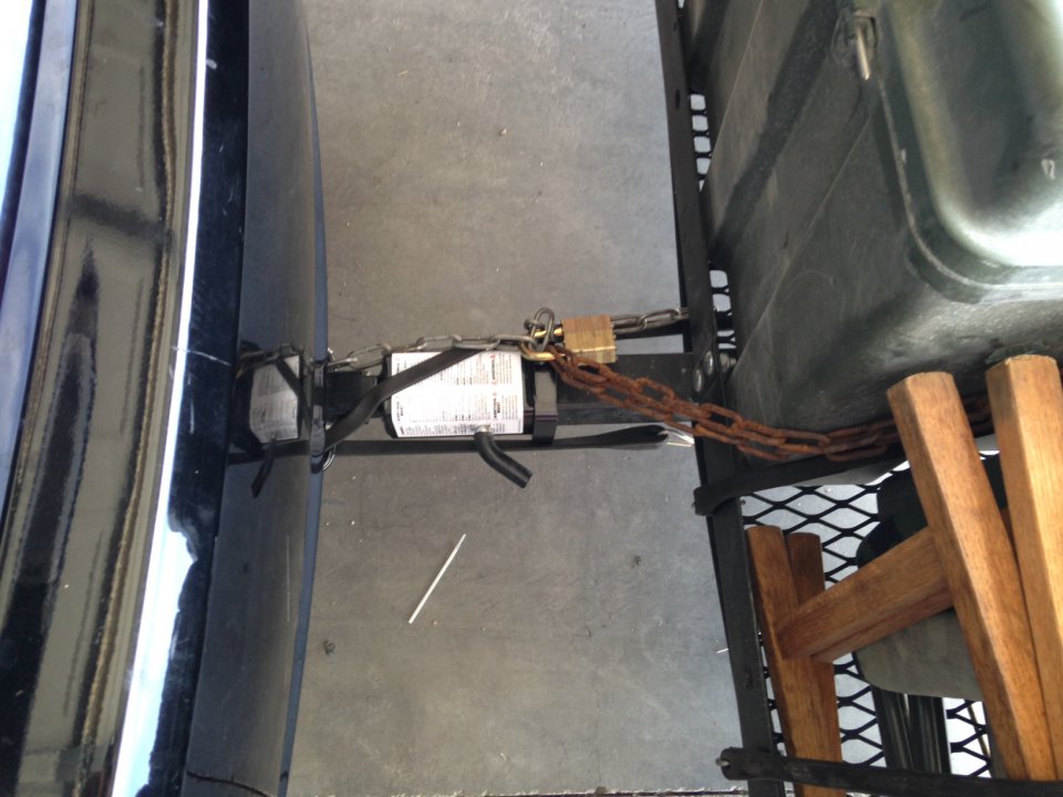

    • Installed Reese Towpower Hitch from Amazon for $109 (I installed it myself in about 15 min)
    • Purchased 2" to 1 1/4" adapter from Amazon for the cargo basket we already owned for $24

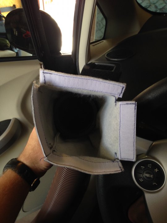

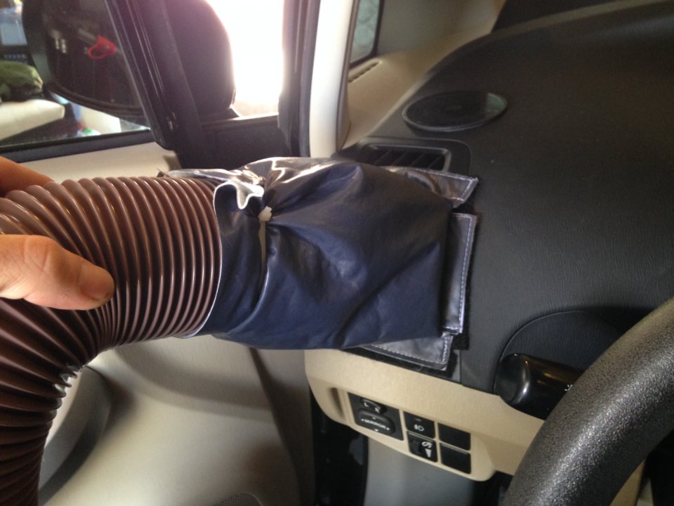

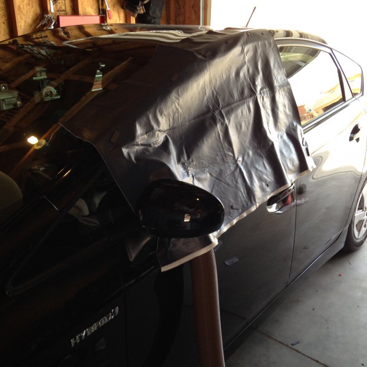

    • Purchased 20 feet of sewer hose from Amazon for $13 for a tent HVAC system

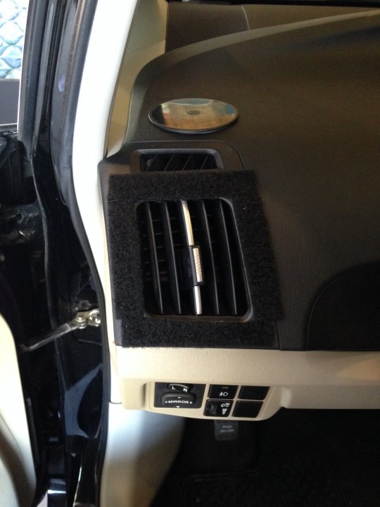

    • Added Velcro to the Driver Side A/C vent
    • Spouse built a custom "adapter" from the A/C vent to the 20' sewer hose from scrap vinyl
    • Used scrap vinyl for a window cover
    • Installed the adapter, basket and added a tough box and cooler I already owned

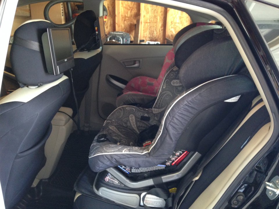

    • RCA DVD Player $95 on Amazon

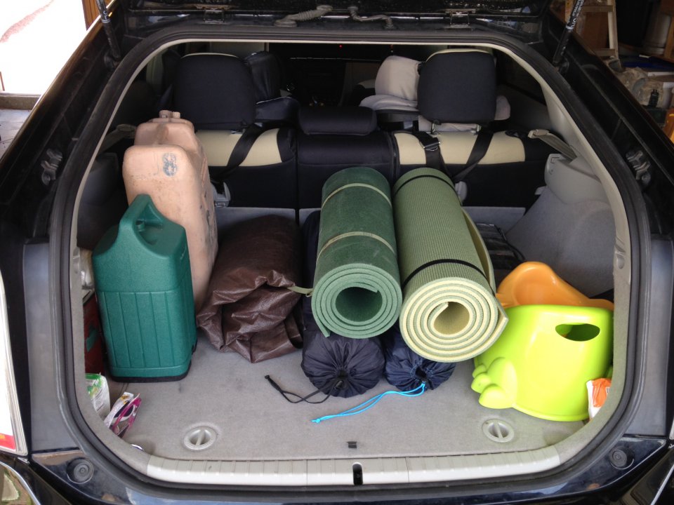

    We will test this setup this weekend. All we are missing in the photos are our three duffels with clothes. Most our food fit under the cargo area floor and the cooler. The green tough box is full of cooking and camping supplies that won't be hurt in the rare chance they got wet.
    With a few hundred bucks and some imagination we will have A/C in the tent, electricity at the campsite (many of the ones we have reserved for the summer have zero power), and room to move all our gear. Security isn't a problem. You'll notice the basket and tough box are chained to the car. It isn't going anywhere unless they have special tools.
    I'll report on how well the hose vents to the tent. All my experiments at home have proven it works great for cooling a tent. Gas expenditure will be minimal whether using heat or cold, and the 20' hose keeps us plenty far away from dangerous exhaust. I've used the sewer hose idea on my HMMWV in the winter and it works great but you have to run the diesel engine all night to stay warm. Same idea here, but with a fuel efficient system. It is amazing how much air flows out of the hose after closing off all other air vents.

    I got 43.9 mpg on the way to the Grand Canyon. 409 miles one way (almost a full tank of gas). Even with the cargo basket and an estimated 1,100 lbs of cargo! The back end was almost on the bump stops and I think we hit them twice going over big bumps. The trip home got 43.1. Both of these measurements are from fill up to fill up divided by mileage. Not trusting the computer. The 43.1 on the return trip is overall and included about 12 total hours of running the Prius at night, at idle. Negligible difference in my opinion! Especially after going from our 16-18 mpg Pacifica for this family trip. It ended up being 42ish degrees both nights and heat was needed over A/C.
    Using the A/C heater hose...
    Our tent is too big! It is a 7' tall dome and is 10' by 10' on both sides. Massive! The other problem I haven't considered (this being the first time we used the tent out of the package) is that it is 75% mesh. It is a summer tent that uses a rainfly and about 2" of space to keep the tent ventilated. No way to heat or cool that much space with it being all mesh. What someone would need is a smaller tent (4-6 person) designed for winter, or with the ability to close all vents.
    As an alternative this works great: Get everyone in their sleeping bags and cover up with a tarp or large quilt (I have twin 3 year olds remember, so too easy) and put the hose underneath. Plenty of warmth then! We used a sound machine (running water) to cover up the noise from the engine cycling. No complaints from other tent sites (fairly far away) and we were very comfortable. Running heat at full blast caused the car to cycle on about every 10-15 minutes for 2ish minutes in 40ish degrees. I think it was cutting on more to maintain coolant temperature than to keep the battery charged. It doesn't come on near as much with A/C.

    While I appreciate the ingenuity, I don't think the A/C or heat is going to work well. It looks like you're only ducting air from one vent, and you're doing it through a 20' non-insulated tube. Even with all of the other vents closed you are still losing a lot of your cool air to them, and there will be a substantial thermal loss through that long hose.
    If you get the chance, could you measure the air temp coming out of the hose into your tent?
