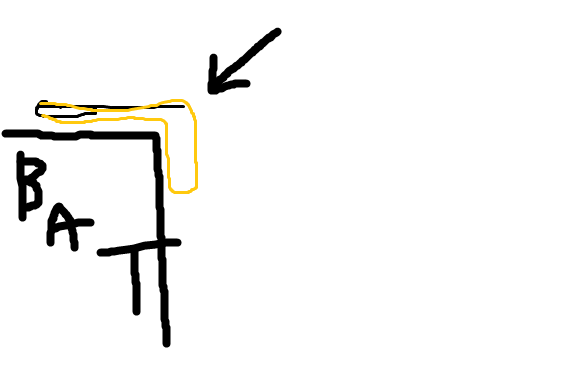

    I got the Ritar 12-55 battery from BritPrius ' link in this thread. While I have been pretty excited about the thread (I have spent a few late nights reading this), I have run into some installation issues: (disclaimer: im not too knowledgable about cars, or the prius)
    1) I thought that as I have a Gen II with a MFD, I would have a bigger 12v battery size. But when we placed old battery next to the Ritar 12-55 , the Ritar was about half an inch wider. makes me think the smalled size is in there- (maybe like BritPrius wrote about some US prius' with smaller battery size?). but the mechanic guy said it might be able to be dealt with.
    2) posts- I didnt get the posts, didn't piece that together till i saw the top of the ritar.my battery has an overhanging thing (see attachment) from the tops. It doesn't seem compatible with the layout of the top terminals. I have afeeling I rip off the overhangy things and would screw on the posts I buy to the top= just want to get a confirmation i'm on the right track.
    3)/white circuit board thing:i think i talked ot the mechanic guy about 'well ok, what if the posts were on top' and The mechanic guy says that while one of the terminals can be just hooked on to a post (positive terminal?), but the other terminalcan;t because it has a white retangular circuit board-thingy that has to attach to it, and that 'it needs to attach the way the previous battery did." I do not fathom this issue, I said why not just tag it onto the post anyways, but the mechanic guy says "if we 'just attach to the post, it won't be connected the way it was previously, all those important things that the circuit board replays for, won't get powered"

  18. dolj
    dolj Senior Member
    May 14, 2012
    8,645
    4,396
    Wellington, New Zealand
    Your "overhanging thingies" are a different type of terminal that are called (I think) side posts. I doubt you can just "rip them off". Are you able to take the battery back and exchange it for one with M6 terminals? Then you could just purchase a set of M6->Japanese pencil post converters.

    Dolj, I got the battery online; I'm guessing the store would let me exchange it, though I may have to pay for shipping, at least one way.
    But mechanic guy also said 2 posts won't do the trick because the negative terminal needs to supply power to the white circuit board. I will look at the white circuit board connection to see what he means, but is anyone on here familiar with the concern of : "the terminal with white circuit board attached can not be hooked up with a post terminal ?"
    my apologies for any circuitry/connection inaccuracies. I am a beginner with cars and circuits- slept through most of physics (and drivers ed).

  20. dolj
    dolj Senior Member
    May 14, 2012
    8,645
    4,396
    I'm not exactly sure what your mechanic is getting at, but if suitable converters are attached to the battery, it is then no different from a standard JIS pencil post automotive battery, so the post clamps should just attach straight on. Make sure your battery has the positive terminal on the left-hand side as you look at the battery with posts nearest to you.
