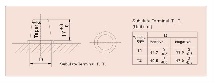

    I'm not sure what you mean when referring to the "white box thing", but if you are meaning the attachments to the positive terminal, and/or the regen control box in front of the battery, then no, you cannot just disconnect them.
    This is the reason I recommended you try and swap the battery for one which has the M6 connectors and then purchase the M6 to JIS pencil post converters.
    When you fit the converters the battery becomes just like a normal JIS pencil post auto battery and so the installation is more or less a standard install.

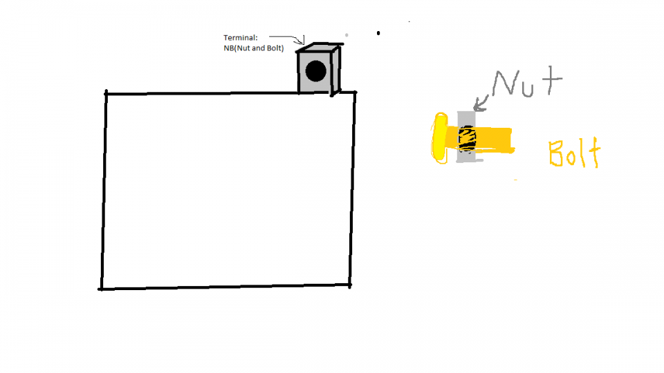

    Exchanging for different Ritar not an option. Its make it work with this "side terminal nut and bolt teminal (correct?) or reutn it and whatever the dealership service does (optima, I would guess).

    Dorji, will any of these adapters serve my purpose, or something like them?Quick Cable: Conversion Adapters

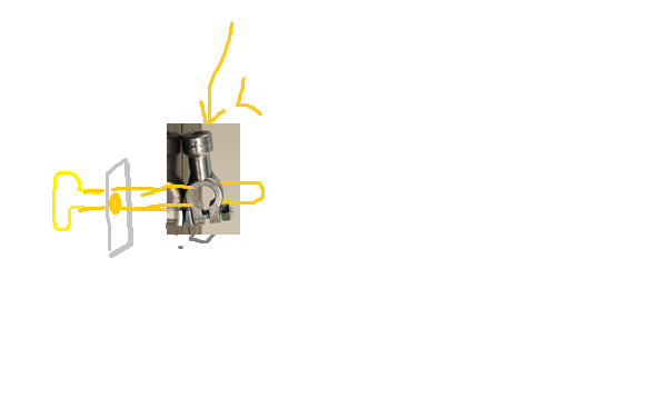

    I attached a picture of an idea. Where the arrow is, can I attach some adapter to that thing to get to pencil post? Assuming this can be done, and the right adapter can be found, I do not know if the terminals need to be in specific locations or if "an inch here- inch there" variation is fine.

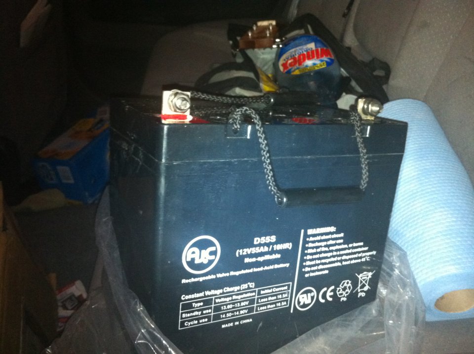

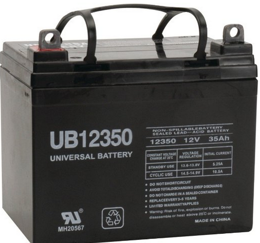

    Here is a pic of my battery, I can take more, just ask.
  13. getwellsam
    getwellsam Junior Member
    Jul 8, 2010
    22
    Pittsburgh
    heres the battery pic

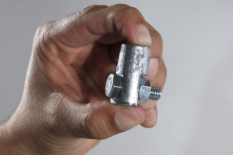

    EDIT - OK, I did some more research, and it seems like these are L type terminals and a pair of flag to post adapters would do the trick. Any feedback would be appreciated.
  15. dolj
    dolj Senior Member
    May 14, 2012
    8,633
    4,386
    Wellington, New Zealand
    Ok, so you have a battery with flag posts and the positive and negative terminals are correctly oriented, so the options I gave relating to a battery with flag posts will work for you. If it were me, I'd go ahead and purchase the flag to JIS PP adapters. If you could only get Flag to SAE post adapters, I would take these to an metal engineering shop and ask them to turn them down on a lathe for you. I'll attach a drawing you can show them that gives the measurements of the posts.
    In a previous post you asked how exact things need to be, and while there is not a lot of room to play around with you should have no problems fitting the battery once you have your adapters altered (if needed) and attached. Just be aware that the positive and negative terminals are a different size, so you will need one of each and make sure the correct one is fitted to the correct terminal. The positive terminal is the larger and the negative terminal is the smaller of the two.
    One last thing, for your info, measure the voltage of your new Ritar battery out of the box, then prior to fitting, charge it up overnight.
    Good luck with your project.
    getwellsam likes this.
