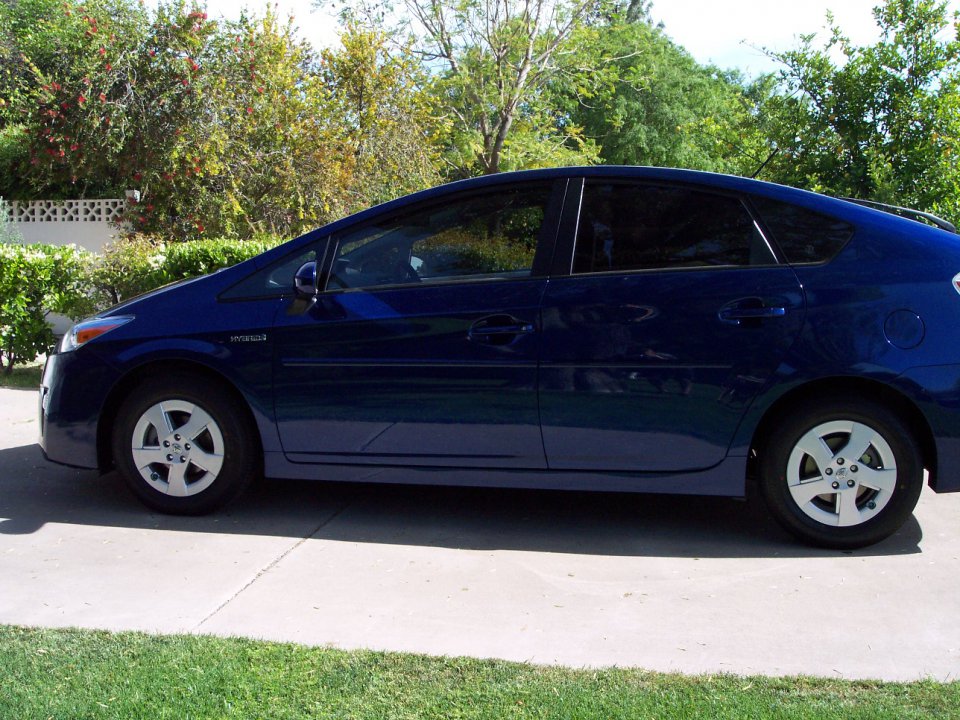

    Hope this helps, in the OEM version it is slightly angled downward to the the front. IMG_1022.JPG

    Yes, needs to be lower in the front to somewhat follow the angle of the accent line near the top of the doors.
    Then extend an imaginary line through the back. It should line up with the seam between the rear quarter panel and rear bumper cover.

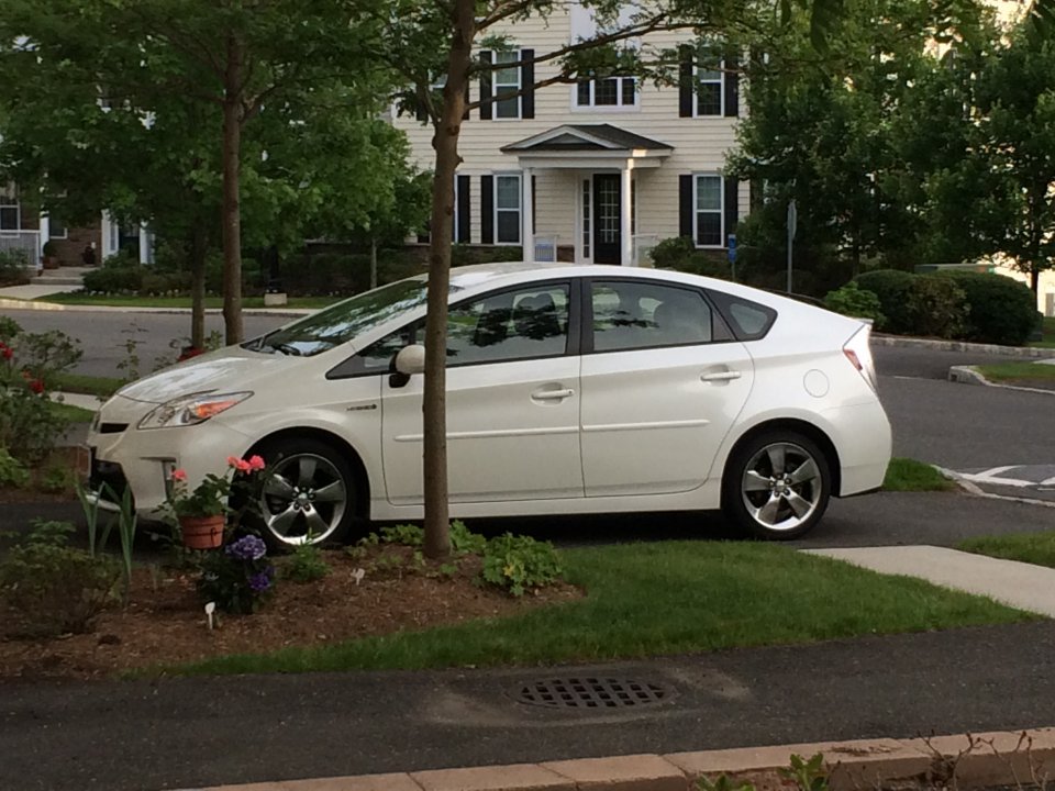

  9. edwardob
    edwardob Member
    Sep 26, 2009
    227
    ireland

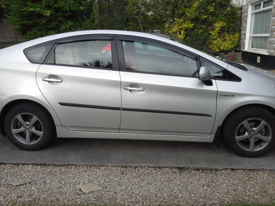

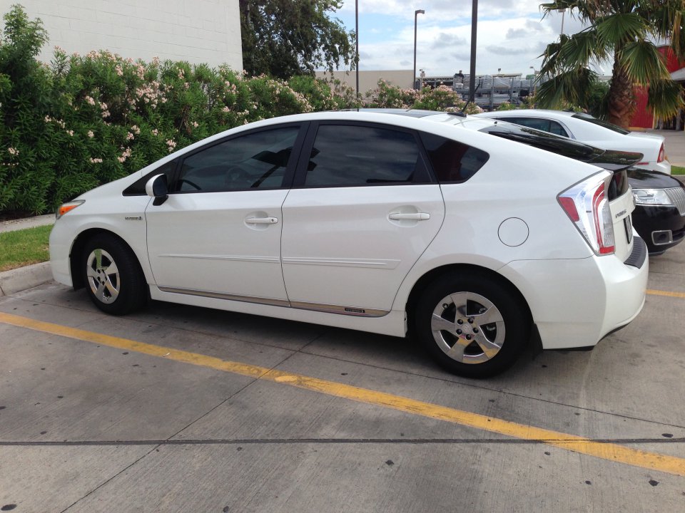

    Looks Great! Nice job! Nice to throw in a bit of BBC's "Orphan Black" into the dull clone mix! A little "Helena" to spice life up!:eek: I too would like to do "something" to make our car less clone like, as we so often see other exact Prius clones, everywhere out there!

    I also removed all the blue pieces from the emblems.{look closer picture} ...... replaced blue/black plastic behind ^T^ @front and rear with plain black....
    might paint mirrors all black!
    cheap mods

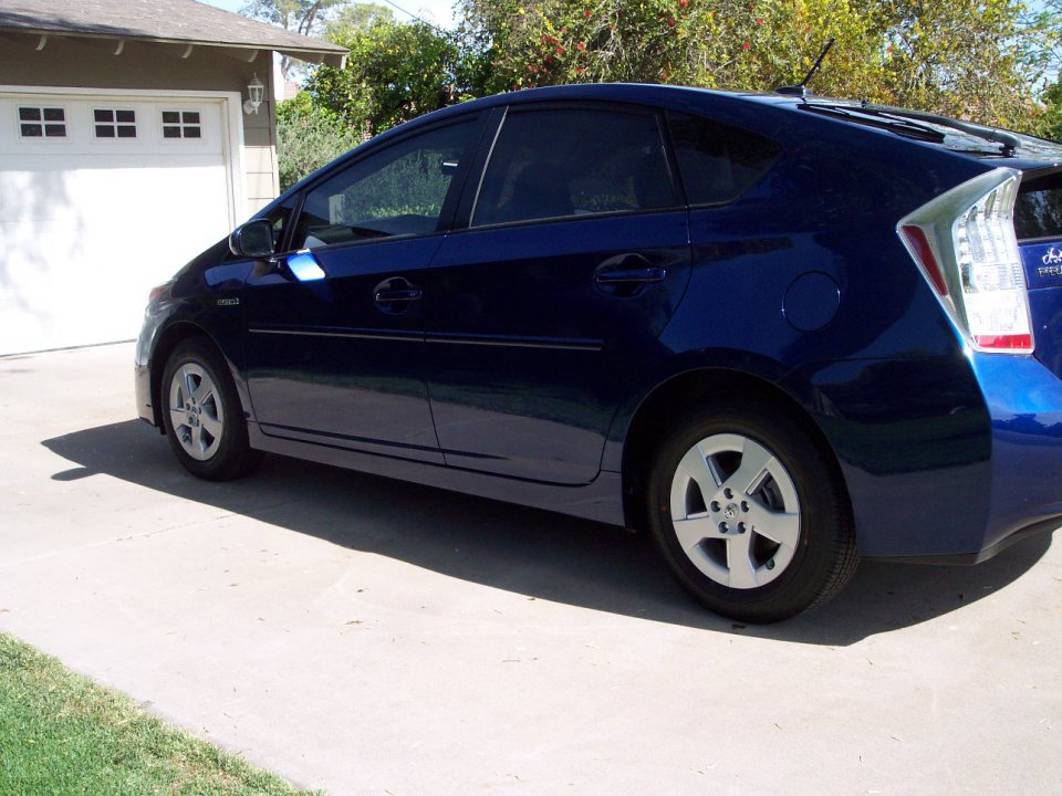

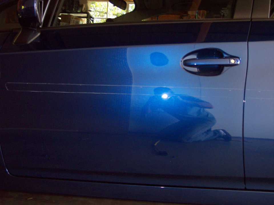

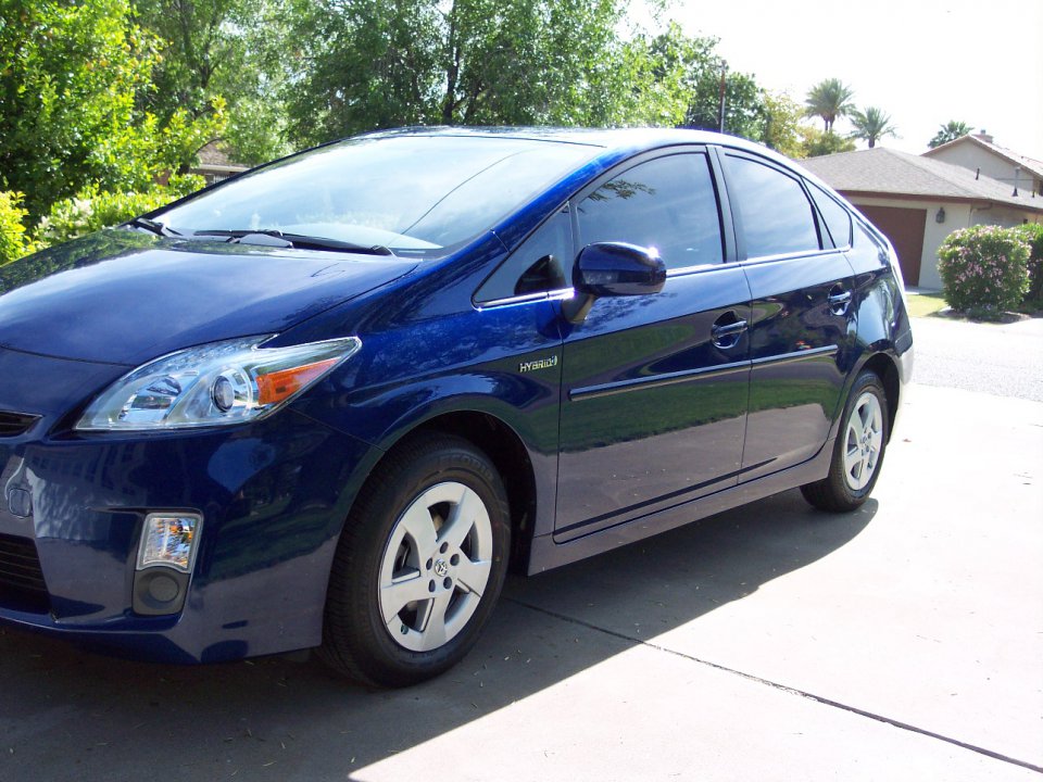

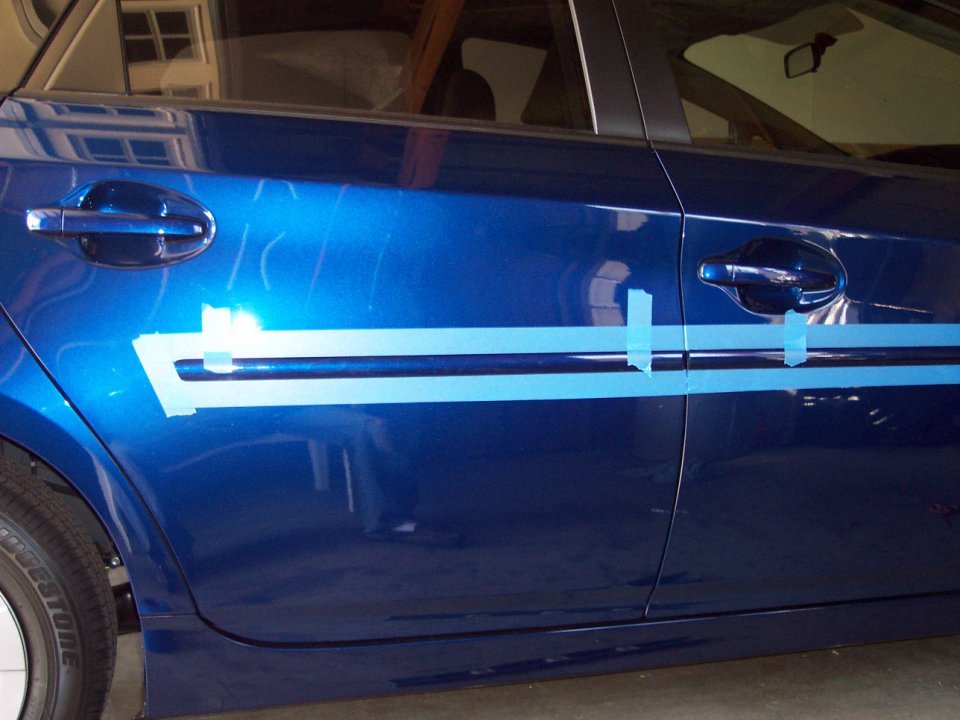

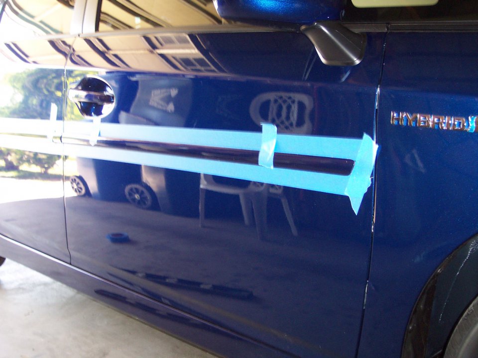

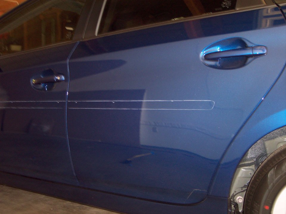

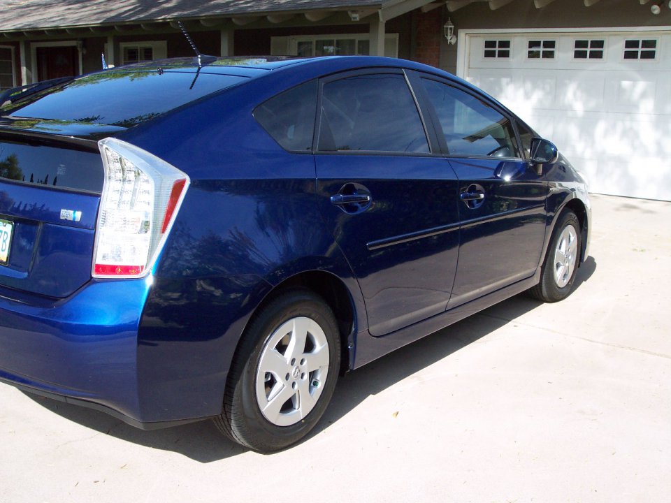

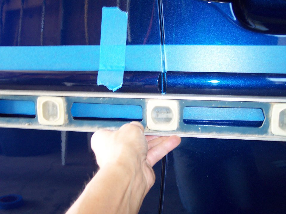

    Here was my molding mod shortly after getting the 2010. I mounted mine high:
    100_1076.JPG 100_1077.JPG 100_1078.JPG 100_1079.JPG 100_1080.JPG 100_1081.JPG 100_1082.JPG 100_1083.JPG 100_1084.JPG

    IMO, the molding looks much better when mounted with a bit of rake, higher at the back than the front, because of the accent line above it.
    Mounting it level throws the proportions off.

    Since my moldings are an exact match to the paint, the contrast is very low. This height is for protection and not style. I have to say having them for 4 years now...no side dings that I can see. As for the "glass jaw" - that's a different story :)

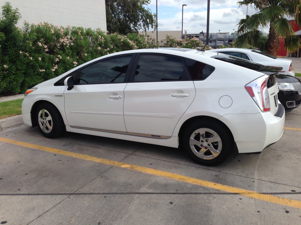

  20. mcmmotorsports
    mcmmotorsports Junior Member
    Jul 8, 2014
    37
    Greensboro, North Carolina
    I will disagree. My neighbor has this white Persona with level moldings and I think it looks awesome.
