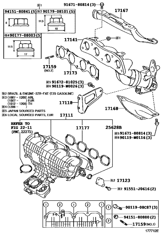

    woah they are obsessed with putting your exhaust back into your engine
    why can't we just rig it up like the Brazilian prius that does not have the egr?
    can't we remove the egr plumbing, then play with the computer and program it the same as the Brazilian version
    so that it runs fine without the egr nonsense?
    also more reflection:
    you don't think you saw a radiator cooling down your Japan investment
    is that true? that there is no radiator? woah
    in the new age, your manufacturer cannot afford to give you a radiator, since they are bogged down by fees/lawyers/egr crap
    so now, when you buy a car, you literally have reengineer their system so you can protect you asset/gold,
    unbelievable
    plan:
    experiment with your part prius to get to the bottom of: running your engine without it taking in exhaust into intake
    when you do the heart surgery on your main prius: your fixing to install a big ol radiator with the plumbing and everything,
    just too cool down your Japan hybrid robot covered in plastic, inhaling its own fart, woah
    summary:
    experiment with prius software to try to make it run like Brazilian prius without inhaling fart, and
    add you a big ol radiator to protect you gold/Japan engine
    you think if you figure out the Brazilian software to get around inhaling fart, then a radiator will make your Japan hybrid bulletproof
    now: Japan hybrid running fine, just burning 2 quart oil per month, but it has not left you yet stranded
    keep you thinking and planning the big surgery
    theory: if you get your engine to run without inhaling its own fart, and you add a big ol radiator, your Japan hybrid will be bulletproof

  12. rjparker
    rjparker Tu Humilde Sirviente
    Jun 6, 2008
    11,119
    6,977
    Texas Hill Country
    Ok I will play along
    Because you need all the Brazilian ecu software for multiple ecus and likely their wiring harness. Toyota USA is not going to sell you that because it's a technical problem for them to execute at a dealer level (no real gurus there) AND it would be a federal and Cali state offense.
    No one has "jailbreaked" Prius software and network integration, no matter what one individual here claims he plans to do.
    So you either block the egr flow (no need to delete) and live with a check engine light OR you realize the egr flow is only a problem when your car burns two quarts a month. Solve the oil burning with options a, b or c above and you get a smooth running, no oil burning engine for 100k-150k more miles.
    And that is not irrational "spitting hot fire".
    Of course it has a radiator, several in fact. One for the engine coolant, another for the inverter coolant, with other coolant heat exchangers for fast warmup and of course, the cabin heater.
    The gen3 cooling system works great and can take 110f with full ac all day long without breaking 200f. The light comes on at 248f and should say "Stop Now or Else".
    The reality is gen3 head gasket and oil burning problems do not need overheating to occur. In most cases failed engines have never overheated.
    The cooling system has two electric water pumps which on occasion with high miles "might" fail. Some will preemptively replace the engine water pump at ~150k or so. However others including myself just change the coolant every 50k and have the original water pumps 320k later.
    . This, in my humble, non-spitting opinion is the heart of your problem. Fix this with options a, b or c and you also get engine reliability along with reduced carbon clogging up everything.

  14. rjparker
    Jun 6, 2008
    11,119
    6,977
    Texas Hill Country
    Yes Brazil probably doesn't need it to meet emissions laws. Which is the purpose of egr (exhaust gas recirculation), not to warm the engine. Some efficiency gains are possible but typically in turbo charged engines.
    Gen2 Prius have no egr and they meet emissions primarily due to a very expensive catalytic converter people like to steal. Gen4's egr was redesigned to take cleaned exhaust after the cats and never needs to be replaced or cleaned.
    Another system most people don't know about helps the engine's throttle body warm up quicker. It's called the Exhaust Heat Recirculation System and is under the car behind the catalytic converters. It is pretty elaborate but since it's reliable on gen3s no one complains about it. Even if it fails it can be bypassed without generating codes. Gen4s sometimes have that problem.

    European laws are also against toxic exhaust gases, but in Europe, Prius Gen3 was also sold without the EGR system.
    I think that there were two development options. One required environmental compliance, the second simplified the design.
    On the GEN3 without EGR, in addition to the absence of EGR, another electronic engine control unit was installed, which did not light the check engine light due to the lack of EGR and it had a different fuel map for different operating modes.
    89660-47460
    Computer, Engine Control
    [11.2010 - 12.2011] ZVW30..EUR EXHAUST EMISSION CONTROL-EUROPE WITHOUT(ON BOARD DIAGNOSIS)
    89660-47541
    [12.2011 - 10.2012] ZVW30..EUR EXHAUST EMISSION CONTROL-EUROPE WITHOUT(ON BOARD DIAGNOSIS)
