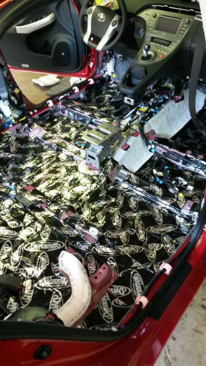

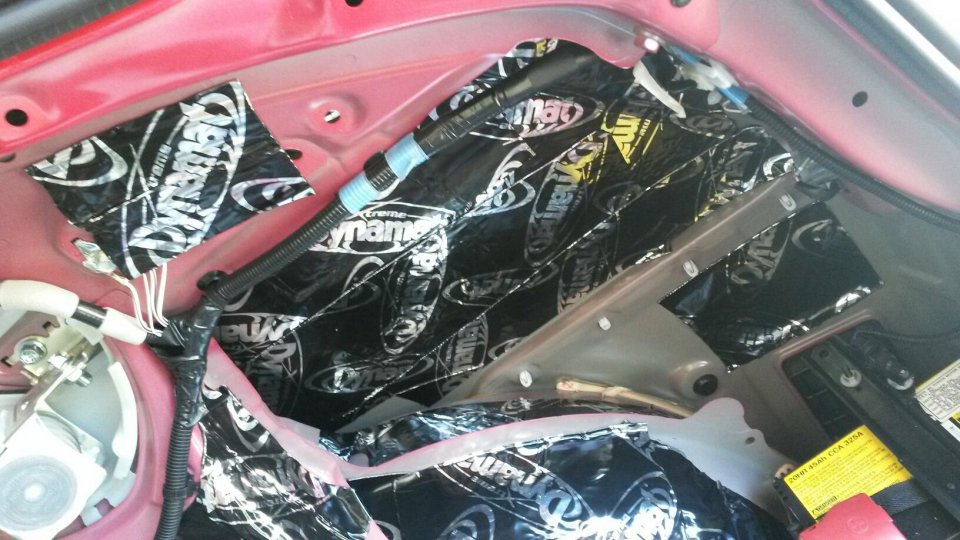

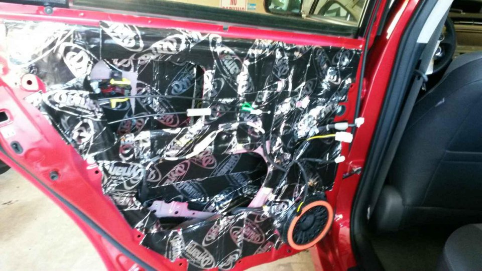

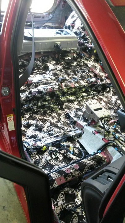

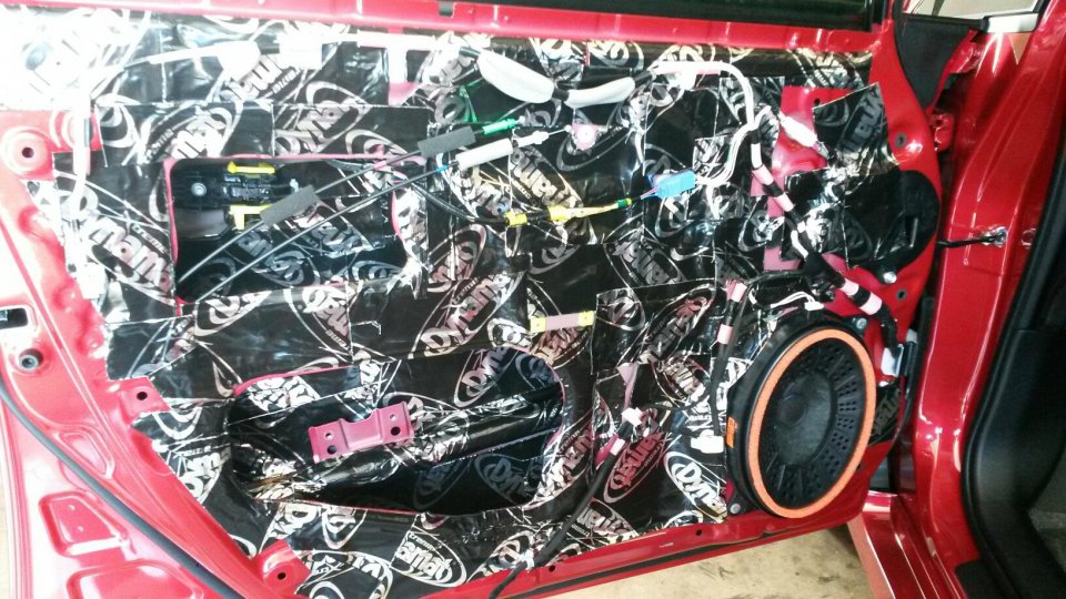

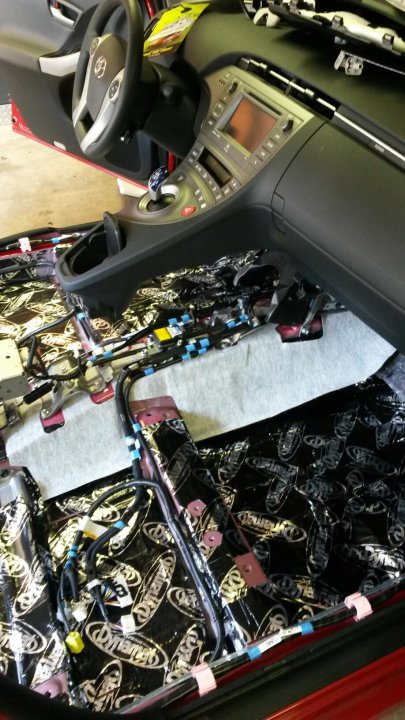

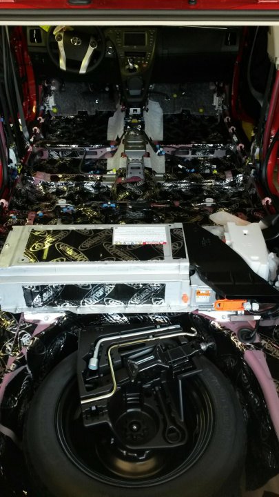

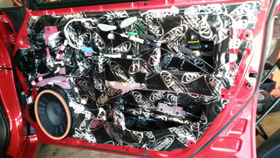

    Just purchased a 2014 Prius Four and although I love my car, the road noise was unbelievable. After doing quite a bit of research, I decided to have Dynamat installed throughout the car. I live in the Portland-Metro area and found an installer on Craigslist. The company name is Allrite Mobile Installation and the Owner is Tony. I checked all references as I was leaving my brand new car. I purchased the material through Amazon as it was 1/2 the price charged from Car Toys. It took 3 boxes of 36 sf each. Cost of materials was $440 and install along with spraying material in wheel wells was $600. Worth every penny of it!! In this day and age of blue tooth phone calls, it is unbelievable quiet. Plus my doors now sound and feel like my old BMW! If you're in the area and looking for a solution to the road noise, I highly recommend Tony and Allrite Mobile Installation. His number is 360-567-5042. It took him 12 hours to completely install the material and reassemble the car but it's magnificent! Wanted to share as my car's interior sound is night and day difference.

    The added weight was 45 lbs. As I'm not a large person, I figured it wouldn't compromise my gas mileage much. For reference, I weigh 110 lbs. But even if you're larger, 45 lbs. isn't a lot.

    I'm attaching the pictures of the car taken apart so you can get an idea how much was involved and how great it came back together!! photo.JPG photo1.jpg photo2.jpg photo3.jpg photo4.jpg photo5.jpg photo6.jpg photo7.jpg
