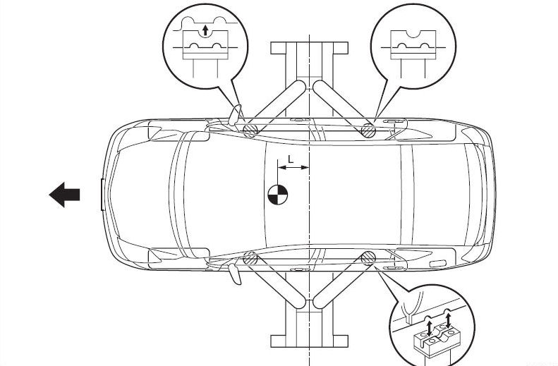

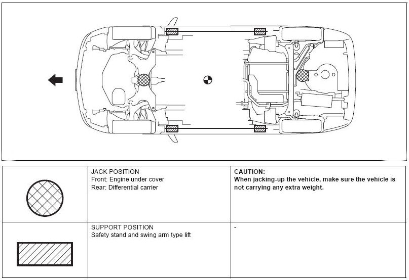

    I just want to clarify, since I'm not sure what you mean by this statement. The floor jack and scissor jacks lift the car in different ways, though that should be obvious, and it really doesn't change what you're doing. The most important difference, though, is the jack point. The floor jack is intended to be used along the midline of the car to lift the left and right sides simultaneously, while the scissor jack is intended to be used at one of four specific jack points -- one near each tire (the rectangles in the following picture):
    The top of the scissor jack should be placed between the notches at the respective jack point:
    GKL likes this.
