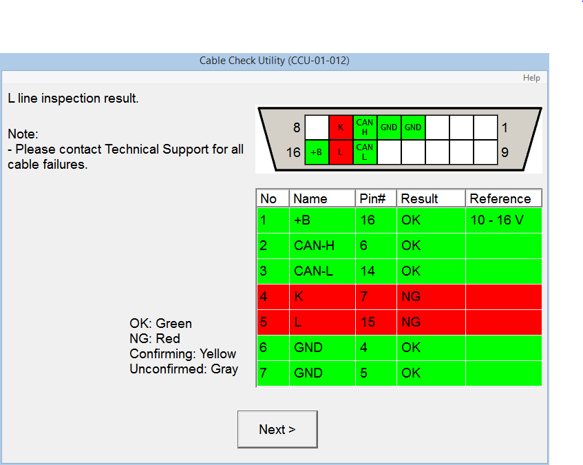

    Have you run the DLC3 Cable Check in Techstream? Did it come back looking something like this?

    Yes, first step confirm your Techstream setup is functional with another Prius?
    Also, it's good to keep an OBD2 bluetooth reader in your glove box so you can use Dr. Prius App to clear codes to try to see if your car will let you drive it home if it goes into limp mode. This would also help to confirm if your cars ECU's are functioning. Here's buyer's guide: priusapp.com/obd.html

    Yes the car still operates. Not sure how well but seems okay. New battery is in. Tested at 12.7 up front. I need to check my techstream with the other prius. I will try this other test too.
