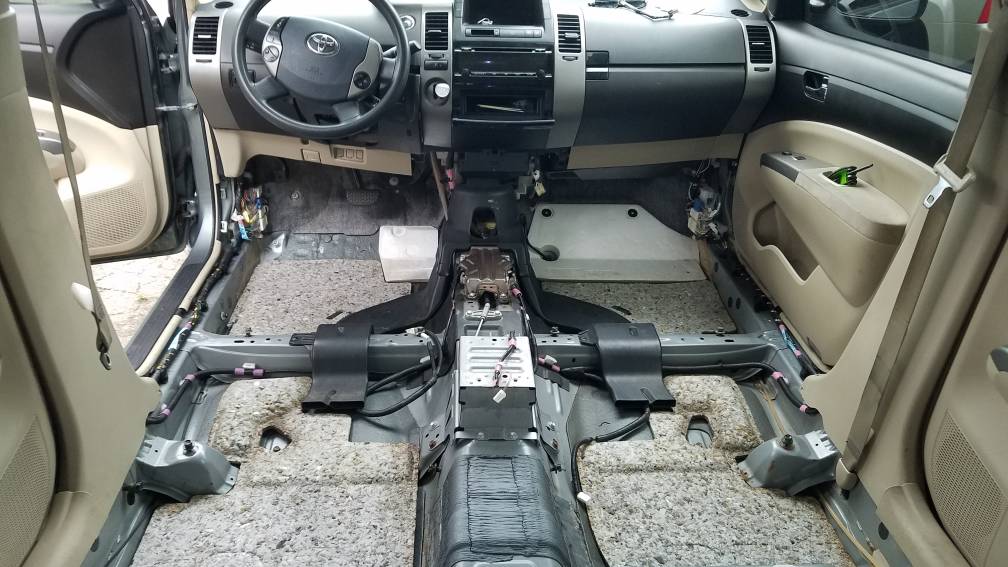

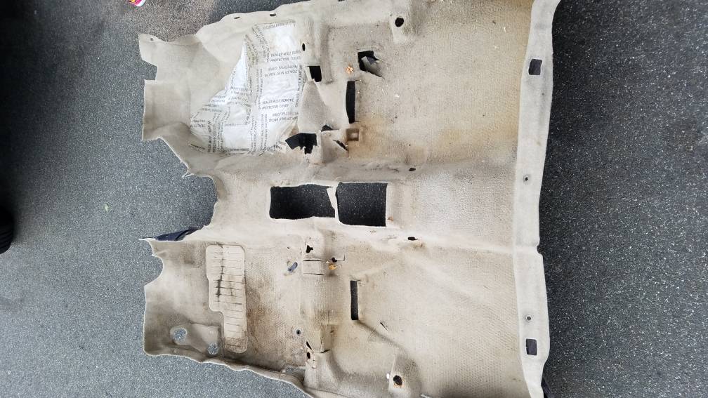

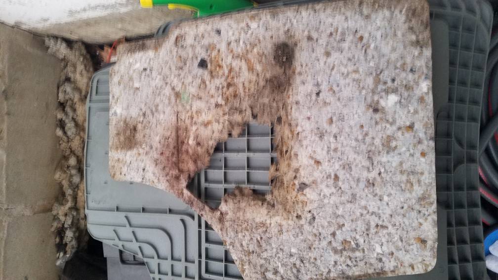

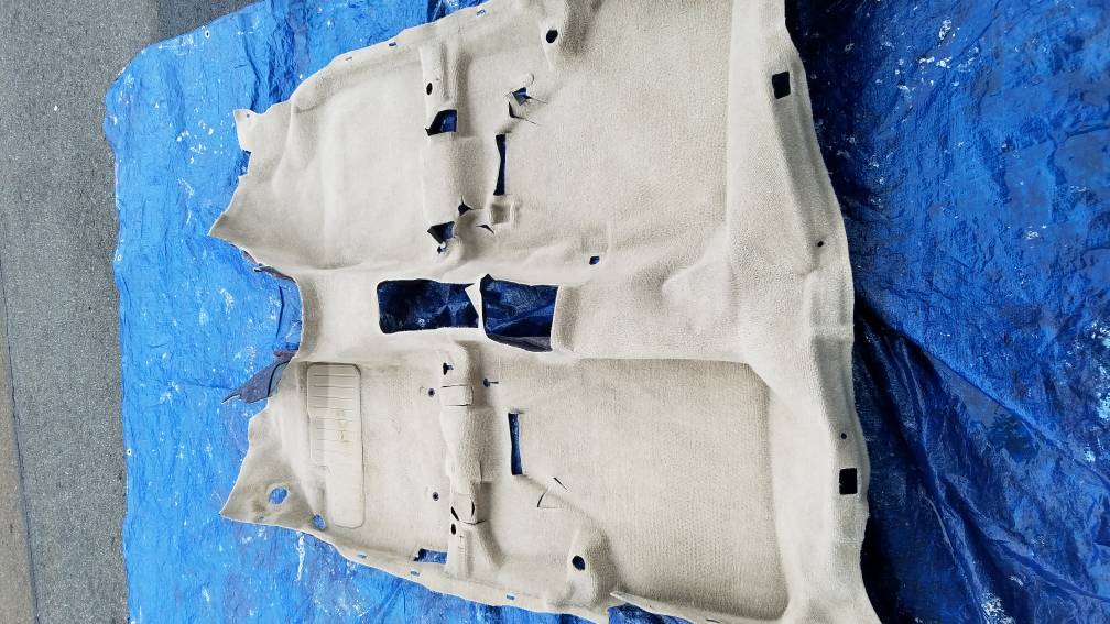

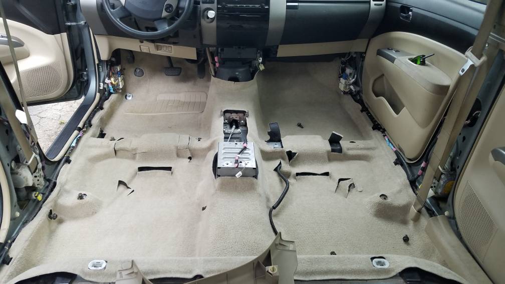

    Don't give up just yet. The carpet can be saved if you remove it. It's not difficult as I have done it myself but it is time and space consuming.
    1.Remove the carpet and wash it with soap on the interior side and you'll get out all the stains you had if any in the process. I washed mine on a blue tarp because of step 2.
    2. After rinsing throughly, flip it over and hose it down with water and soap but avoid scrubbing as it's not really possible and really unnecessary.
    3. Try and squeeze out as much water as you can by hand and then use a wet vac to soak up as much water as you can from the back side first. Do it it small sections to avoid tearing the matting. Once your happy flip to the interior side and do the same. It should be easier since this side is thin and has a hard rubber backing so vac away.
    4. Set the carpet with the the matting side up facing the sun on an open surface for a day or two or more. Allow to dry and flip as often as you want but I only did it twice for each side over two days if direct sunlight. I used my other cars roof rack as the drying table.
    5. Remove the interior sound deadening and honestly discard it as it will not be worth saving. You can replace this with junk yard pulled pieces or none at all but noise inside may increase. It's worth at least installing some carpet backing from Lowes, home depot etc. I opted for a junkyard pull for all the above parts because I had a huge hole in it from the previous owner. See sound deadening picture.
    The results were fantastic and no mold has grown in the last 2 months or so.
