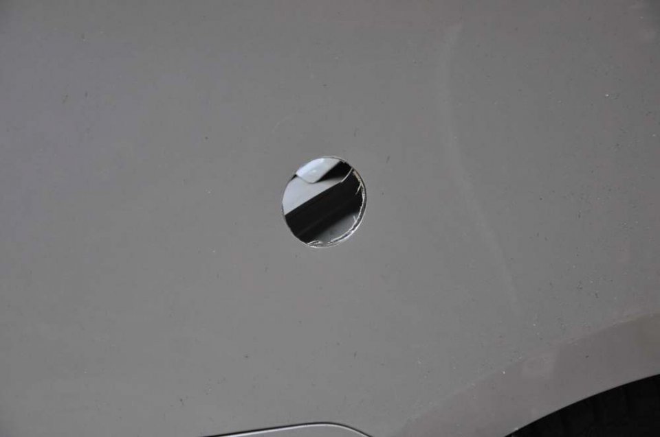

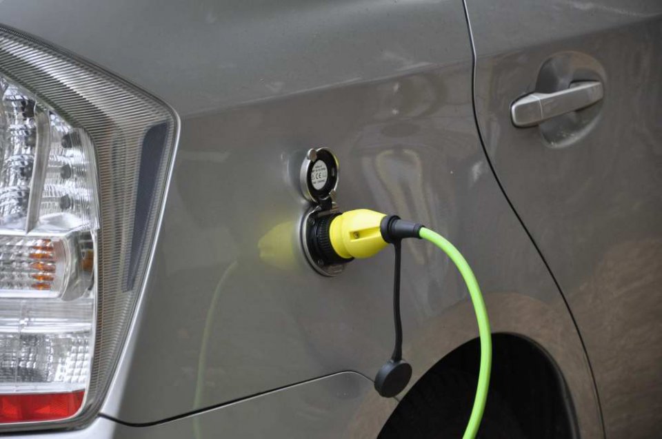

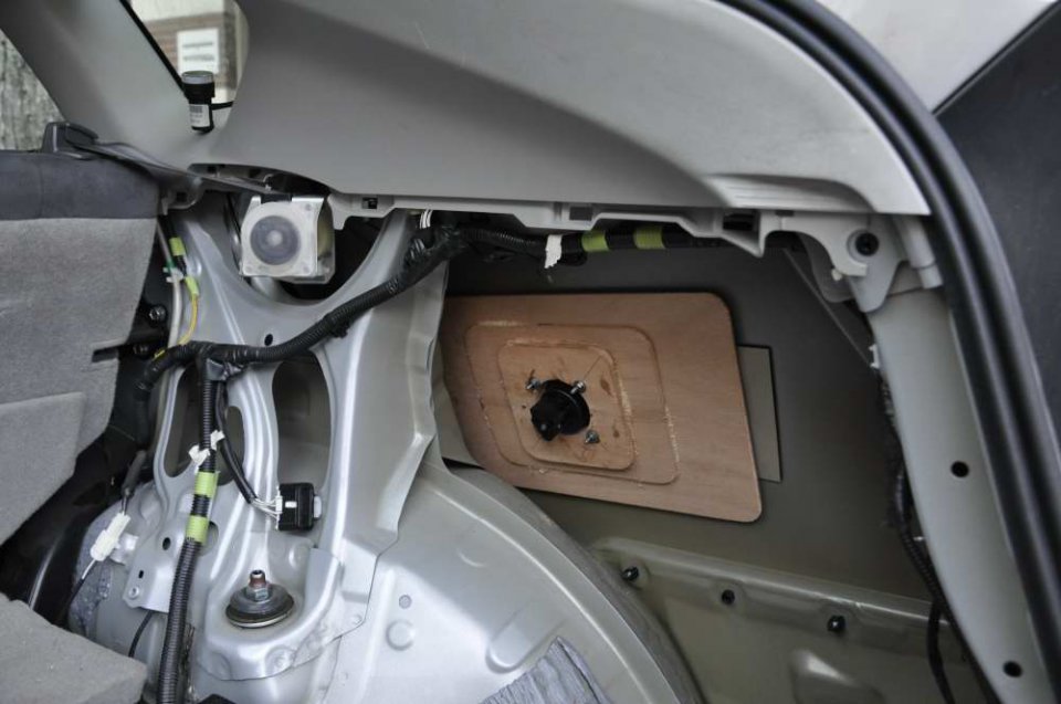

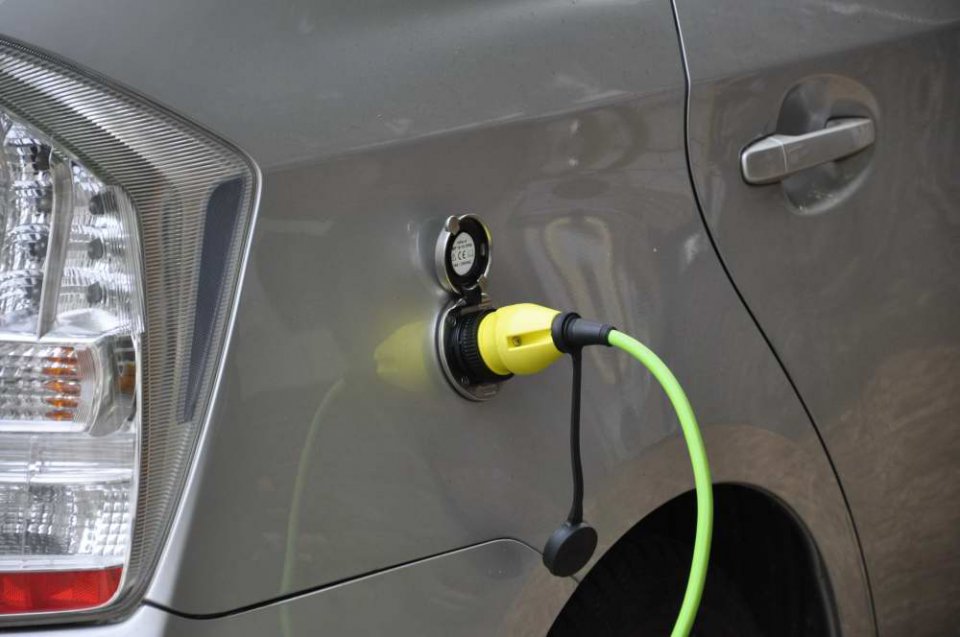

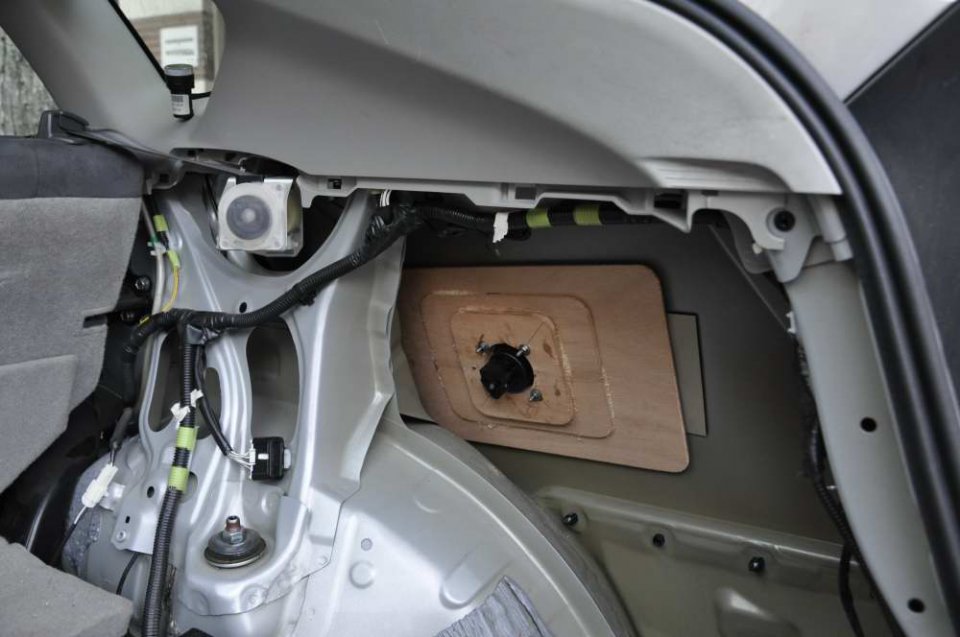

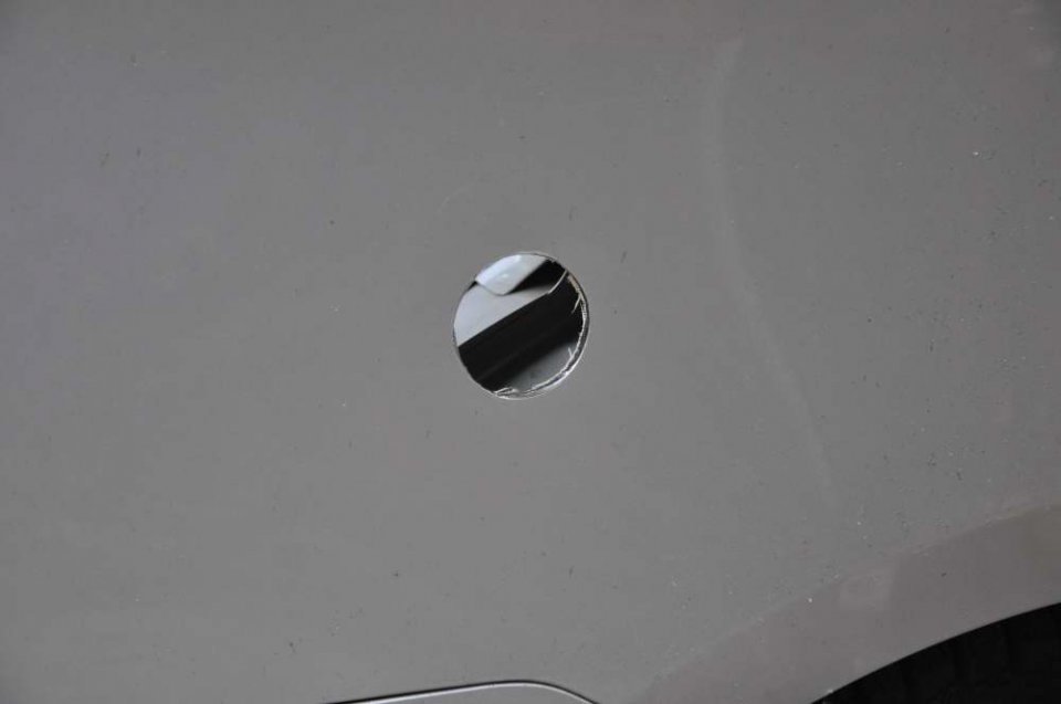

    Mine is now ready for a public charge pole. I have just drilled the hole in de side of my Prius. And mounted a Ratio Electric connector on the car. The side panel of the car is from aluminum. I have reinforced this backside with waterproof multiplex wood on the inside. See pictures.
