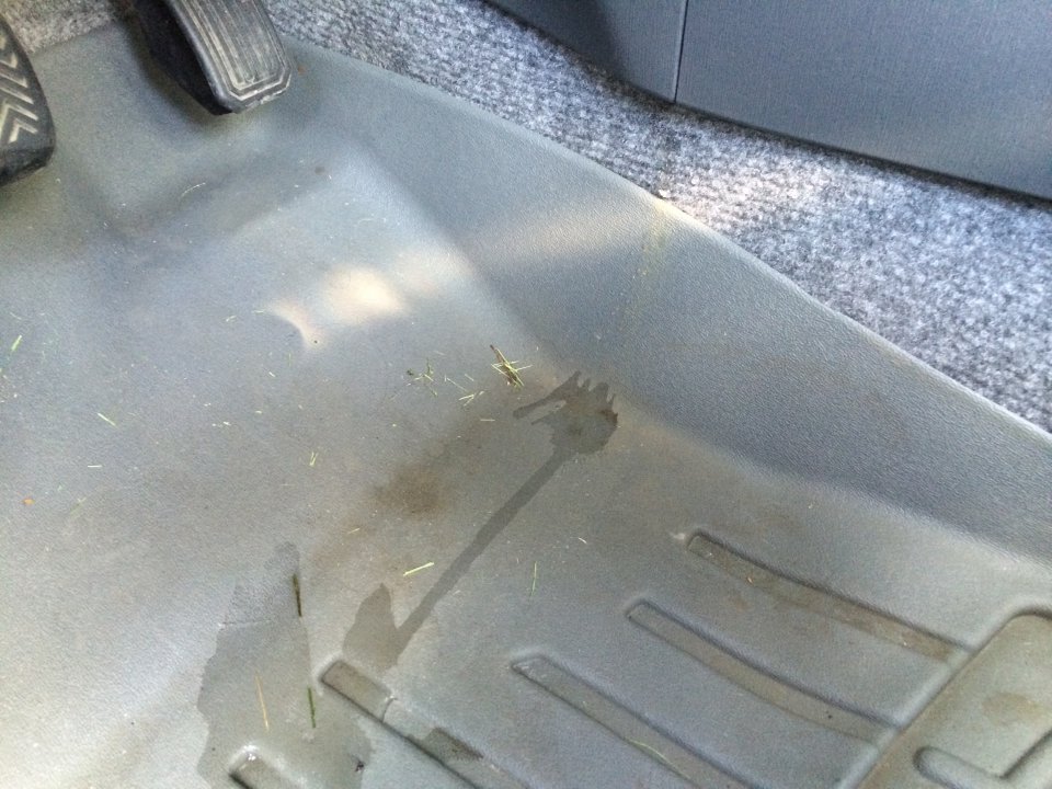

    Hi everyone,
    I've seen posts about fluid showing up on the passenger side floor mat. However, I have been experiencing fluid (assuming water) showing up on my driver's side floor mat for a couple weeks. I've attached a picture of where the fluid seems to be originating from (I had wiped up most of the fluid when the picture was taken). The fluid appears to be coming from underneath the plastic and onto my floormat. If I had to estimate how much fluid shows up on the floormat, I would say a good 5-6 tablespoons.
    Any ideas? Thank you

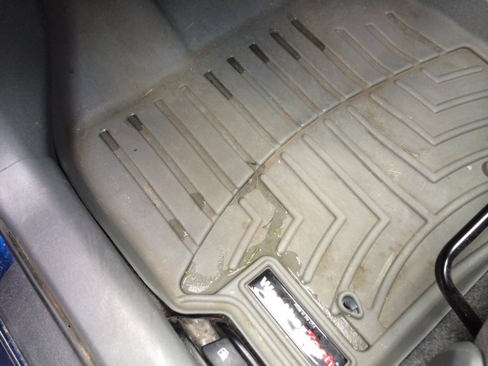

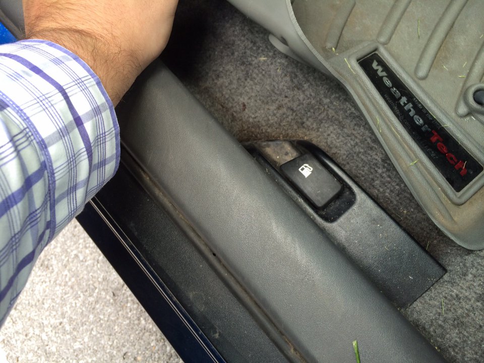

    as a followup, i just went out to my car to check things out. 2 hours ago, I returned to work from my lunch break and had wiped up all of the water. In two hours, here is what is on my mat in terms of the fluid. Oddly, the carpet around my gas door release is pretty damp.... I have no idea what thats about....
    PS - no judging the dirty interior :)

    the source of the water is not where you pointed on the first picture.

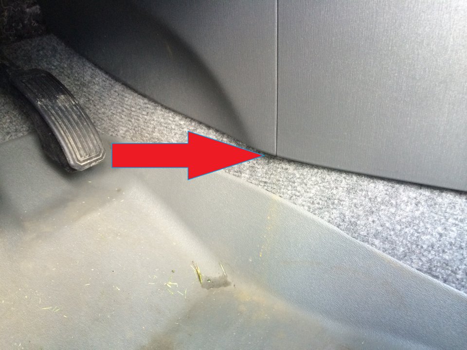

    The first picture does indeed show the source. I confirmed while driving home from work today. I started my commute with a dry mat. After 40 minutes, water was dripping down from the area shown in the first picture. The water is dripping down from underneath the plastic onto my mat.
    I attached another photo taken just 10 minutes ago
