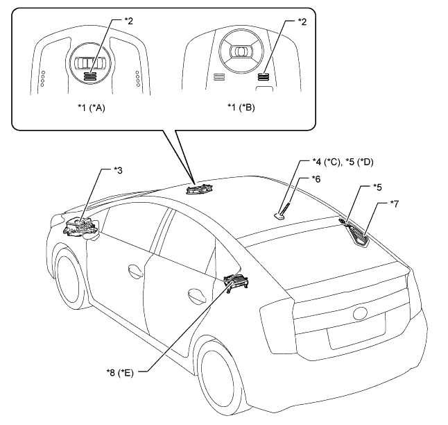

    Just to clean-up the discussion about FM radio components. The image is valid for the car production after Dec/2011.
    *A Models without Sliding Roof System, *B Models with Sliding Roof System, *C Models with HDD Navigation System for Europe or Australia, *D Except Models with HDD Navigation System for Europe or Australia, *E Models with 8-speaker System
    *1 Map Light Assembly
    *2 Telephone Microphone Assembly
    *3 No. 1 Integration Relay
    *4 Amplifier Antenna Assembly - DAB Antenna
    *5 Amplifier Antenna Assembly
    *6 Roof Antenna Pole Sub-assembly - AM/FM
    *7 Window Glass Antenna - FM sub
    *8 Stereo Component Amplifier

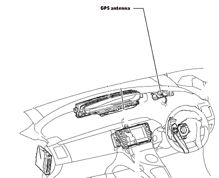

    [FONT=Tahoma][SIZE=3][COLOR=#444444][FONT=Tahoma][SIZE=3][COLOR=#444444][FONT=Tahoma][SIZE=3][COLOR=#444444][FONT=Tahoma][SIZE=3][COLOR=#444444][FONT=Tahoma][SIZE=3][COLOR=#444444][FONT=Tahoma]the GPS Navigation antenna position - it is for RHD, so LHD will be mirrored.[/FONT][/COLOR][/SIZE][/FONT][/COLOR][/SIZE][/FONT][/COLOR][/SIZE][/FONT][/COLOR][/SIZE][/FONT][/COLOR][/SIZE][/FONT]
