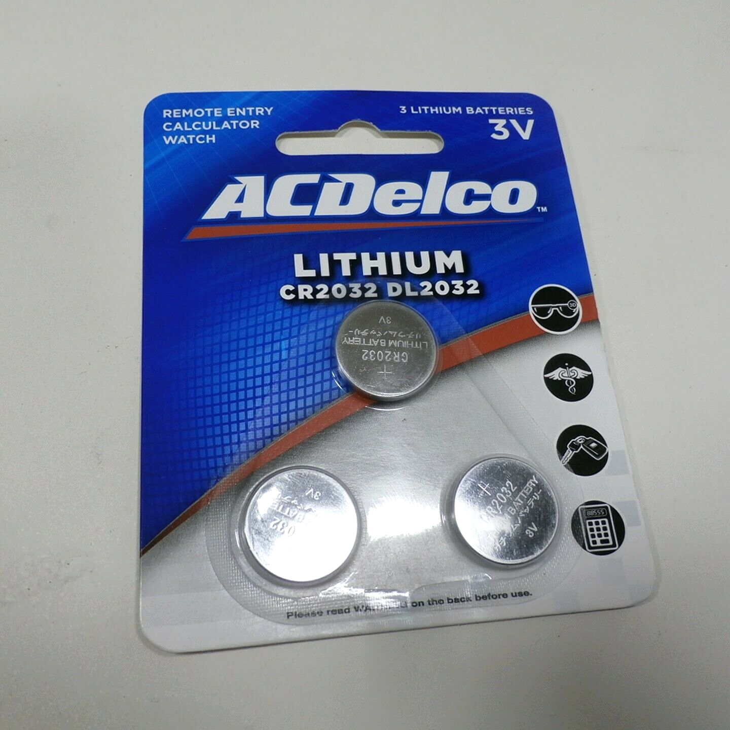

    99-Cent Only Store sells three ACDelco CR2032 lithium coin cells for a dollar. You can probably find them in other dollar stores as well. Try a jump start for the 12-V battery as others said as well.
