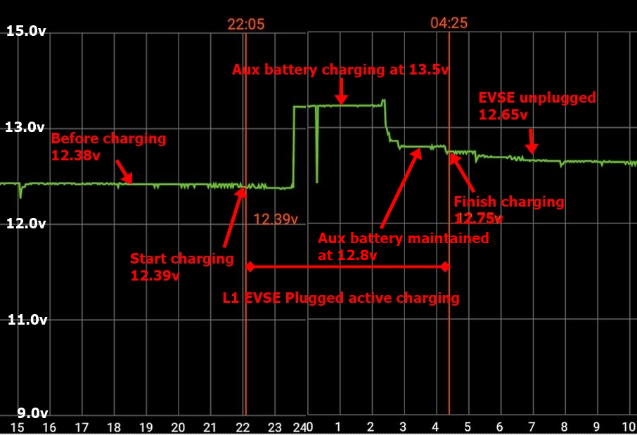

    To be precise, there are two different levels of charging that occur while the traction battery is being charged. One is as shown in my comment #20 above, and at ~13.5v. This actually charges the 12v battery SOC to almost full. The battery stays at 12.65v after resting.
    Another level of charging occurs at ~12.7v. This is more of a maintainer mode. It does not bring the 12v battery SOC any higher than before the start. What I don't know is how the car decides which way it charges the 12v battery. Certainly, if the 12v battery voltage is well above 12.4v at the time the charging session starts, then maintainer mode is used. I think there is a threshold level of the 12v battery voltage that starts the Active charging mode at a higher 13.5v, but at ~12.3v, either mode can be used.
    Again excerpt from my comment on this thread: Hopefully, ultimate 12v battery charging system discussion on PP | PriusChat
    EVSE Maintaining: The second is ~12.7v maintainer mode charging that just keeps the 12v battery at near a full level without actively bringing the SoC any higher. This too only happens during the time the traction battery is actively being charged. I explained this observation in this thread.

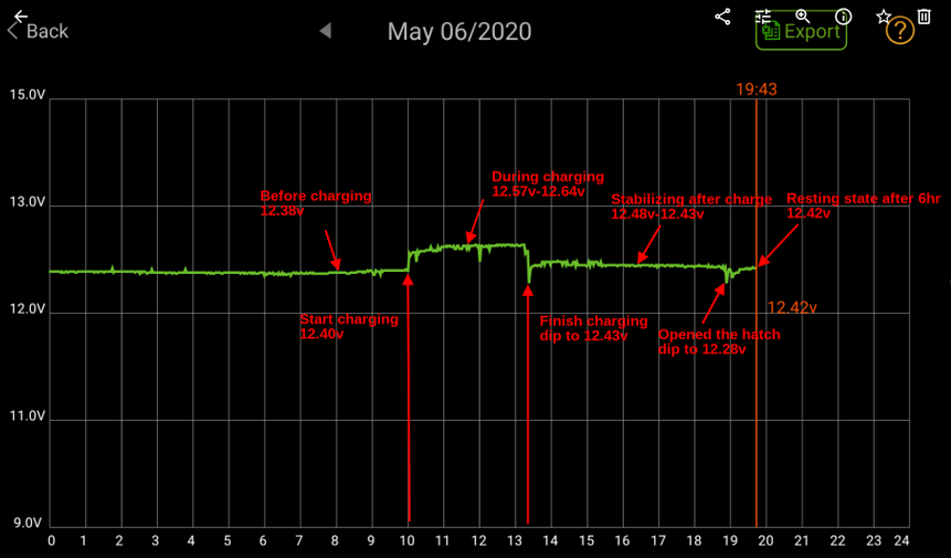

    I am not saying after 1 mo all 12v batteries in every PP are going to die. The point is longer the car sits undriven, the lower the 12v battery SOC is going to be left in the battery. Sitting for one month or even longer in a garage after the 12v battery was fully charged may be fine if done once in a great while when the battery is still fairly new. But if you continue to repeat that practice over and over, after several years of use, the 12v battery is more likely to die sooner than later. Then there is the quality of the battery itself and user-induced draining, such as leaving lights on or keeping too many accessories.
    I have not had my PP battery problem yet (fingers crossed), but my son's hybrid CRZ which was driven every day for ~40 miles had a dead 12v battery. It was less than 2 years old battery. And it was a second after-market 12v battery replacing the OEM battery in a then 3-year-old car. The battery was totally shot and not holding the charge even after fully charging it with a charger, so I had to replace it with a new 12v battery, which made it the 3rd battery in 5 years. Then, we have a Nissay hybrid Pathfinder that was purchased 5 years old with an original 12v battery. This car is driven only once every 2-3 weeks for less than 20 miles most of the time and occasional very long haul of over 500 miles. This battery lasted another 3 more years after our purchase until one cold morning temperature at -26F when the car would not start. Checked the battery, and it had a 12.6v resting voltage, but upon load test, CCA was too low to start the car in that cold temp when the hybrid traction battery could not be used to start the engine.
    The point is, every car, every battery behaves somewhat differently. Not all PP batteries behave exactly the same way, but we all know it has a finite life span. If I want to prolong my 12v battery life, then I would not let the car sit for a month without the battery maintainer connected.
    I don't know what you consider 100% SOC on PP's 12v battery. But using the chart below, my PP's 12v battery definitely goes down below 100% SOC even if I drive every week for greater than fifteen minutes.
    The graph below is the 15-day span of the 12v battery voltage (SOC) plotted. Each upward spike represents my daily drive of duration longer than 15 min for each trip. Some downward spikes are the quick current draw that dips the battery voltage temporarily either when the car is first started or during parking, such as opening the door. After the drive on 2/17, the car sat for 5 consecutive days. The battery voltage (SOC) was down to 12.25v (65%). After a trip, the traction battery was fully charged for ~6 hours, and this brought the battery voltage (SOC) back to 12.66v later on 2/22. But within a sing day, by 2/23, the battery voltage (SOC) was down to 12.33v (70%). Yes, the 12v battery in my PP drops from 12.7v to 12.3v in less than 24 hours. I try not to let my 12v battery go below 12.2v(60%), but if that happens, then I connect my external 12v battery charger to bring it back up to 12.7v (100%) promptly.

    Even if the battery did not fully charge to 12.7v, the fact still remains that the battery is not maintaining the same level of SOC for long. I have a graph from the day I actually used the external charger to fully charge the battery, The red dot on 1/10 indicates when the battery was charged at 14.5v to full charge 12.7V (100%). I have driven the car for two days in a row after that on 1/11 and 1/12 but did not drive 1/13-1/14. The battery SOC steadily decreased from 12.7v to 12.41v in 4 days (1/15). Then the battery recharges after the drive each day but continues to go down more and more each day. If I drive every day, I would not notice much change, but if I let it sit for a few days (1/22-1/24) the gradual change shift to more drop and eventually went down to 12.14v by the end of 15 days period. A full charge of 12.7vwill drains down to 12.2v within ~2 weeks with some driving.
    Again this is all with fairly constant driving (not every day, but certainly more than once a week) for about 30min to 1 hour for each trip. If the car is driven every day, then the 12v battery gets replenished every day and does not have enough time to drain down too far, and it tends to stay around 12.4v most of the time. But if the car is left undriven for a few days, then it will keep dropping down to ~12.2v. In most cases, if I maintain at least a 1-hour drive one day a week, then I can maintain this minimum level of 12.2v (60%). If I let go longer than a week, it will likely to continue dropping below 12.2v.
    No, I don't think so. Certainly, the battery monitor I used has a little current draw but it is rated 1mA. I only check once every few days or so to connect to my phone to log the data. I have nothing else that stays connected and drawing on the battery that is not an OEM. And I have checked the daily changes of the 12v battery SOC with a multimeter only and a very similar rate of SOC drop has been reported. Furthermore, the same battery drain has been reported by many other PP owners. For example, this 12v Battery Is Discharging, Re-Charge Now ! | Page 14 | PriusChat reports 12.7v to 12.1v (0.6v) drops in 16 days.
    Temperature does affect the SOC of the 12v battery. I have seen the voltage drop overnight to the lowest point in the morning corresponding to the temperature change, and then during the day, as the temperature warms up the voltage will go up spontaneously. However, those fluctuations are small, in the range of less than 0.1v.
    One thing to add to all of those observations is that even though I and many others witnessed the persistent low-level parasitic draw on the PP's 12v battery, I have not had any battery problem on my PP to date. Having more than 12.0v SOC on the system almost guarantees that the car will start. What I don't know is when the battery eventually gets to the point when it starts causing the problem. It is unlikely that happens within 1 to 2 years after purchasing a car new with presumably a new battery. But I have seen enough reports by others in this foram having such trouble very early on their ownership of new Gen4/PP. So, I am taking a great measures to avoid such trouble.
