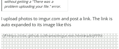

  18. sylvaing
    sylvaing Senior Member
    Jul 15, 2023
    1,221
    517
    I upload photos to imgur.com and post a link. The link is auto expanded to its image like this
    Plus it allows me to use the image somewhere elses.
