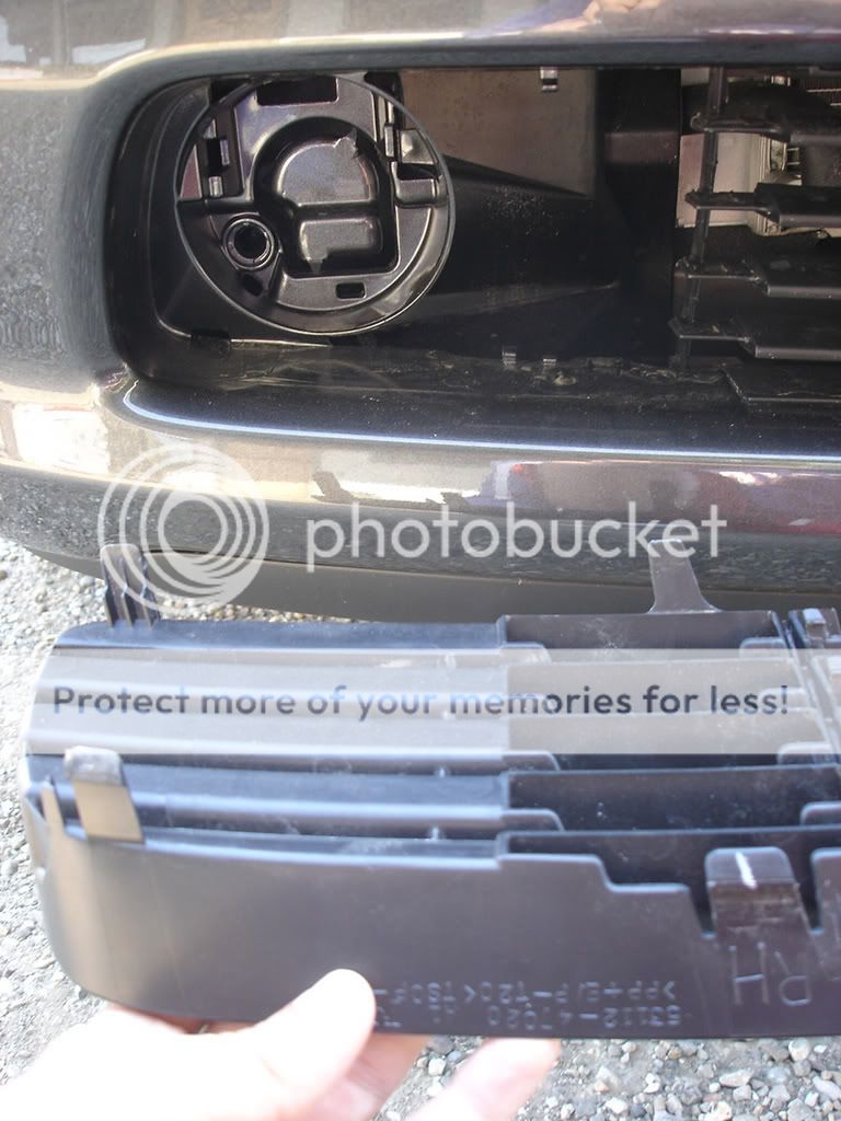

    If you haven't looked yet, as shown in artrockets picture, you will have to remove the back part where the lamp assembly mounts. It just has a couple of tabs to twist or cut. And I left the lamp in the assembly so dirt would not get inside. I also bought pigtails to plug into the lamps to protect its sockets.
