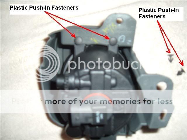

    During the install I noticed that the lights were a little wobbly from being attached to the cover with only one screw. I was able to eliminate the wobbleness by drilling 2 small holes in the cover at the 2 points where the black half-round inserts are inserted into the cover. Then I used easily available black plastic push fasteners through these holds, and they hold the foglight assemblies tighter onto the covers. (See the following 2 photos)
    As for recommending that others take on this project. I won't. It is a lot more difficult than it first appears, even though many participants of this thread were very, very informative and helpful. If I had it to do over again, I would just hire a Toyota dealer to do the entire job. My arms and hands wouldn't be full of bruises - and my neighbors wouldn't be aghast at the loud expressions of my frustration.
