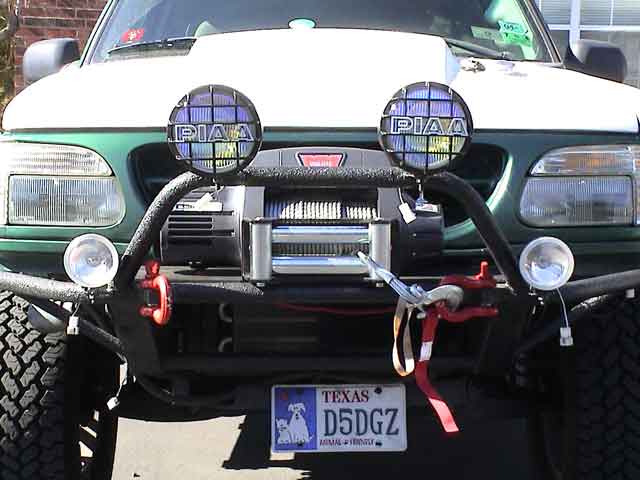

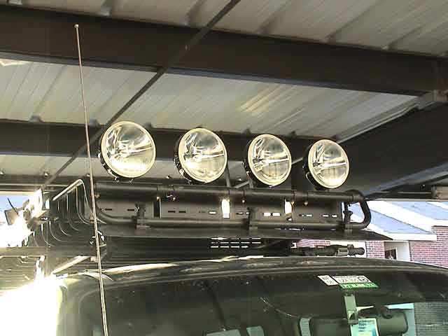

    I know a thing or two about lighting. Here is a picture of my Explorer, it's got a few. Those are 120 watt lights up top (two flood, two pencil), 85 watt (REAL) fog lights on the bumper, and some 85 watt driving lights, not to mention my upgraded headlights. What you can't see is the 200 amp alternator to power them all! I would have converted the headlights to HID, but the 9007 is a dual filament bulb, meaning I would loose the high-beam function and wouldn't pass the Texas inspection. Of course, now I'm in Florida, and have no inspections...
