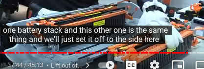

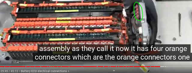

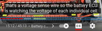

    Toyota's NiMH batteries since day one have had "the" voltage sense harness you are thinking of. As in, one.
    And of course when you looked at the video of Toyota's non-NiMH Prius battery, you saw that one has four voltage sense harnesses.
    Why so many more sense wires, d'ya think?
    I'll help: because with NiMH it is safe to monitor every twelve cells (that's every pair of Toyota's six-cell modules).
    The non-NiMH battery has so many more sense wires because it has to monitor each individual cell.
    You could package it that way, or you could do what Toyota did and just use enough sense wires for a single BMS unit to see the voltage of every cell (not just every twelfth cell like the NiMH version).
    Or just maybe, there already is such a video. Say, here's even you linking to the same video I linked for you in #13!
    So you've already learned from it yourself, right? Right?
    Here is the video you just linked showing the two Toyota lithium blade modules that make up the battery:
    Toyota's packaging choice was for each Li module to be 28 Li cells, and the battery is two modules (a Prime battery is five modules). Each module has all the sense wires it needs for the BMS to see the voltage at every single cell.
    Why is it like that, when their NiMH version just has one sense wire every two modules (twelve cells)?
    Because Toyota knows with some chemistries (NiMH), you can safely get away with monitoring every twelve cells, and with some chemistries you can't.
