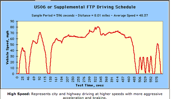

    This is the EPA test:
    Over the ~ 600 seconds of the test, deceleration occurs for about 100 seconds, or 17% of the test. The steady state driving in the low 60's mph would only be an efficient glide in a Ford hybrid if excess SOC was available to use in a power-glide. Even in an optimistic scenario the excess SOC would be used up after a minute, so ICE-off during this test for a Ford hybrid is at most 160 seconds of the 600 second test. That works out to a 3% fuel economy bonus.
