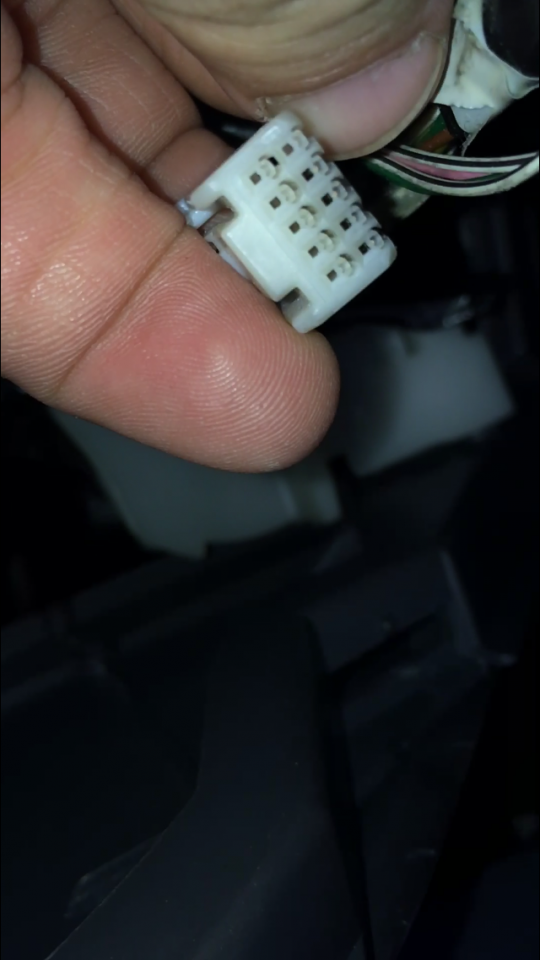

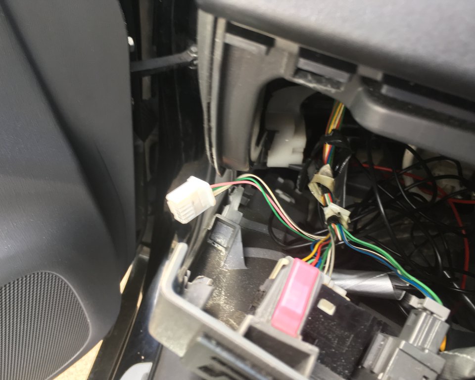

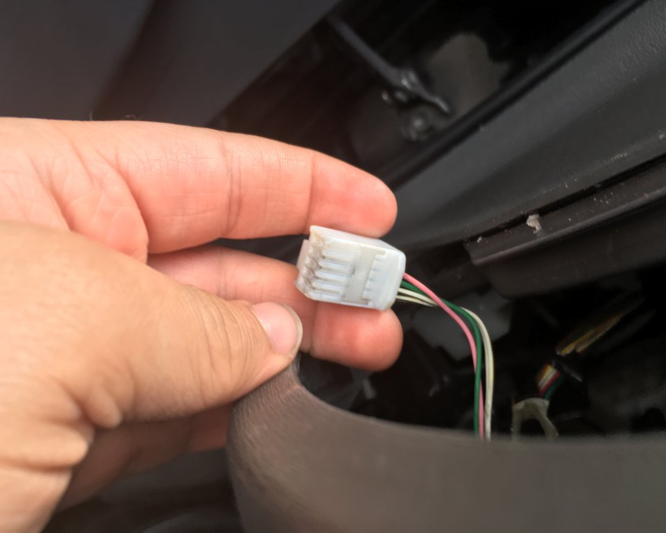

    Hey, im wondering if any of u guys can help me here, i was messing around under the cover where the mirror adjustment and front light washers is and all that (for my aftermarket parking sensor button and front camera button will be there), but in there i found a wire tucked in with a connector. Like a button connector, so im wondering if any of u guys can help me find out what it is for? Im wondering if it is a connector for manual headlight adjustment, ive seen that in some priuses, but mine doesnt have it, can that be it?, should i just buy a random switch for that connector and try and turn it on and off and see what it does?, LOL
    115,530
    52,915
    it must be for an option you don't have, is there a package higher than 5? we don't get front light washers, so it's probably a euro spec option.

    we need a euro member to chime in here. one thing i know, toyota uses the same wiring harness for all the different packages. so if you're missing an option(s), the wires are still in there.

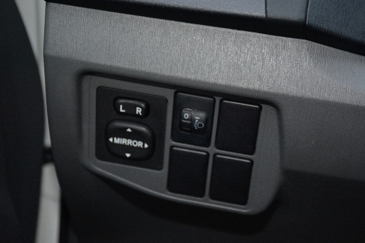

    i think im not missing an option, i think its for one of the cheaper packages. its the manual headlight adjustment button thingy for prius two (comfort) and three (advance).
    [​IMG] [​IMG][​IMG]
    like these ones, this is the prius comfort, which is prius two, and the prius advance which is prius three, here u see the thingy for the headlight adjustment for the halogen lights.
    Zulat likes this.
  8. bisco
    115,530
    52,915
    gotcha. you are missing that option.:p
