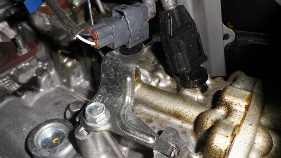

    I was changing the ATF fluid for the first time and noticed a film of oil on the backside of the engine right above the oil filter. It appears to be from a sensor, but, not sure what it is. Anyone know or seen this before?

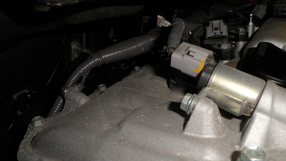

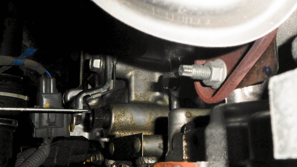

    The third photo seems to show the oil leak is coming from a point at least as high as the exhaust manifold. Who changes the engine oil, and is it possible that person spilled some oil during the process, which dripped down the back side of the engine?
    You can apply some degreaser to the area, wash off with water, and see if the oil stain reappears.
    Or, if you are sure the oil stain is not due to a maintenance error, and assuming your car is still covered under the 5 year/60K mile powertrain warranty, let your local Toyota dealer figure it out.

    It could be from one of the sensors there or it could be the seal for the timing chain cover.

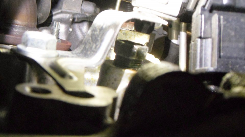

    I can rule out oil spilled during an oil change since I've done it myself since new and photo shows a clean area back of the oil cap. I closer look does show the leak is likely above this area. Attached is one photo from the top. Car has over 81K miles so likely not covered by warranty?

    OK, since you would have to pay for the repair yourself I suggest you start by cleaning off the oil stain with engine degreaser and hose down with water. Then see how long it takes for the oil stain to reappear, maybe it will be easier for you to locate its source when you start fresh.

    There has not been any noticeable oil loss between changes and no oil dripping on the ground. The area of the leak is not easy to see and the bottom engine panel needs removed to access it. Others could have the same issue and never see it. Plan is to degrease as suggested then use a digital inspection camera to monitor and track down the source.

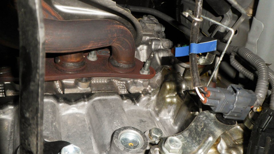

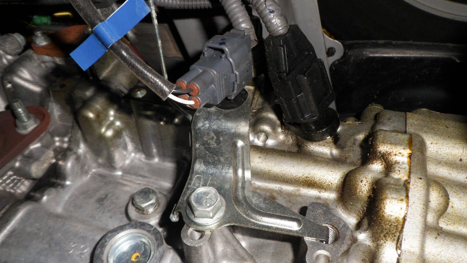

    From the pictures I can tell it is not coming from the engine block or cylinder head or valve cover. I am pretty sure that it is coming from the seal between the timing cover and the block/cylinder head.
    I will attach some photo's so you can see what exactly I mean.
    I doubt it that it is from the two sensors on the timing cover. The bottom one has an o-ring inside the timing cover. The other bigger one on top of it is for the crank position which has a metal gasket.
    That timing cover is sealed with some kind of brown/grey silicone not with a gasket. I was pretty worried when I was planning to close it.

    Is the black connector the crankshaft sensor?
    Leaks at that sensor are not uncommon.
    If timing cover suspect, get a socket wrench
    and check the bolts in that area. See if any
    are egregiously loose.

    I had a similar leak on a Prius v wagon that uses the same engine, at around 40K miles. in my case the leak came from the timing chain tensioner cover gasket, which is the diamond-shaped rusty-looking cover secured with two nuts, visible in pictures 1 and 3 of the OP's first comment. in those pictures the cover is partially obscured by the blue tape on the sensor wire.
    This cover is at the same level as the exhaust manifold, which could be why no sign of oil leak existed above this height on the OP's engine, as was in my case. the gasket on my car was replaced under the 60K mile powertrain warranty, and the leak has not returned now at 47K miles.
