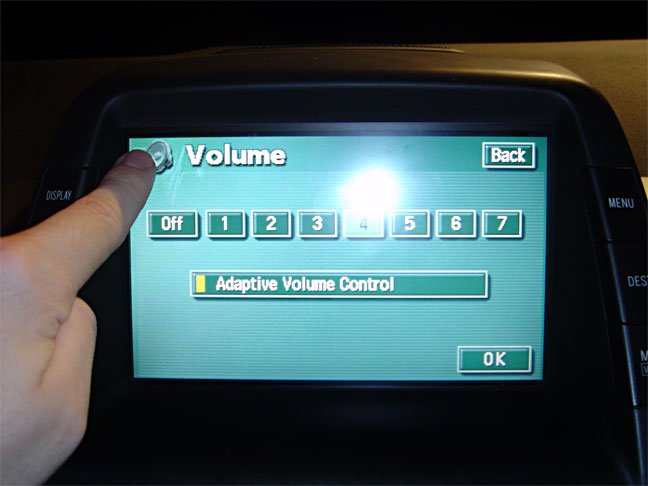

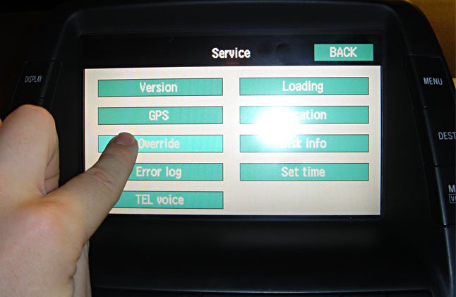

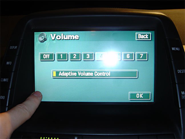

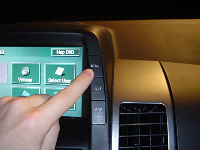

    Back on topic... I took some photos of the sequence. Feel free to use them however you like.
    Thanks for the great tip driverx!!!
    1. Press Menu
    2. Press Volume
    3. Touch upper-left corner
    4. Touch lower-left corner
    5. Touch upper-left corner again
    6. Touch lower-left corner again
    7. Hold down Override until it beeps
