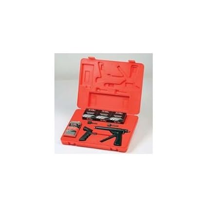

    The other thing I bought was a real tire repair kit. This one in fact:
    which I keep in a tool bag together with the compressor in the back of the car.
    In any event, I noticed the tire pressure warning light come on when I was driving my daughter to soccer practice last night. When we pulled into the school parking lot the tire was completely flat. I pulled it off the car, nervous of what I would find and there was a big hole on the tread that looked like something a large framing nail would make. I'm guessing I hit a nail driving through the many construction zones around here and it finally flew out at some point. So I pulled out my repair kit, followed the instructions to ream the hole and install the plug. Then pumped the tire back up. 24 hours later the plug appears to still be holding so I'm happy about that. Hasn't lost a drop of air. The Tsunami compressor also pumped those low profile tires up to 35 psi in about 1 minute. Very fast. Took me exactly 25 minutes to jack the car, pull the tire off, patch it, inflate it back up, and re-mount it back on the car. And I wasn't really hurrying. Honestly not really any more time than it would have taken to pull out a spare.
    So the compressor and professional patch kit turned out to be an exceptionally good purchase for this car. I'm extremely glad I had them with and didn't have to coat the tire with a temporary goo patch that might or might not of held up and certainly would have made me nervious about going to work this morning. I don't have time to mess around going to tire shops during the week days.

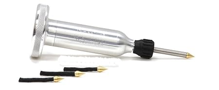

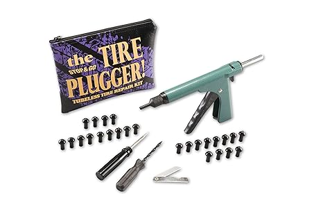

    Has anybody got experience with the mushroom-insertion style of plug repair kits?
    There seem to be two main flavors going around. One is this kind, which uses vulcanizing cement, and the other is this kind, which doesn't.
    The first kind, for a bit more money, includes an 8 ounce can of heptane/latex vulcanizing yuck in the kit, and also uses mushroom plugs that are coated in some kind of orange reactive goo.
    The second kind comes with no can of yuck and plain black rubber plugs, apparently counting on them to stay put just because of their shape.

    I don't know about those mushroom type plugs. The process is similar to the simple plug that I installed with simpler tools. Presumably they work fine but might be overkill for an emergency kit that you might never use. The machine looks pretty expensive and professional.
    For all these plug systems it is basically the same process.
    Step 1, Remove the item (nail, screw, wire, etc.) for that process it is probably good to make sure you have a good pair of needle nose pliers.
    Step 2. Ream out the hole with a reaming tool which is supposed to also push the steel belt wires out of the way so they don't snag and tear the plugs when inserted.
    Step 3: Insert the rubber plug with some kind of applicator tool. Mine is just a simple slotted push rod and the plugs are these sticky rubber adhesive strings that you push in and then trim off flush with the tread.
    Seems to work. It is the same basic approach used by the tire repair shops except they have fancier tools because they are doing it all day long. I was happy with how easy it was to do and the tire is still holding air.
