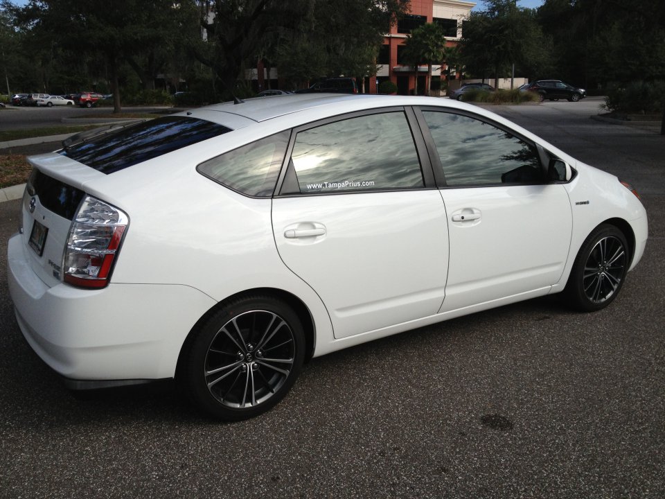

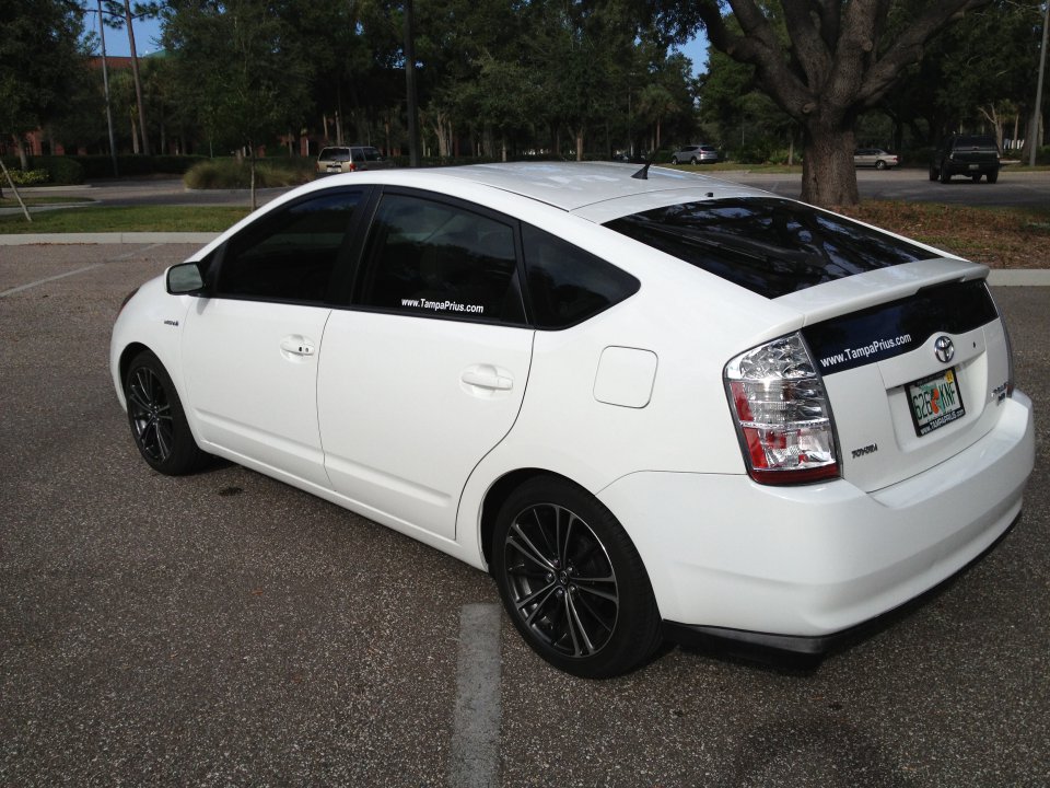

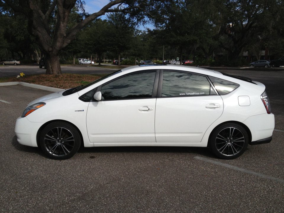

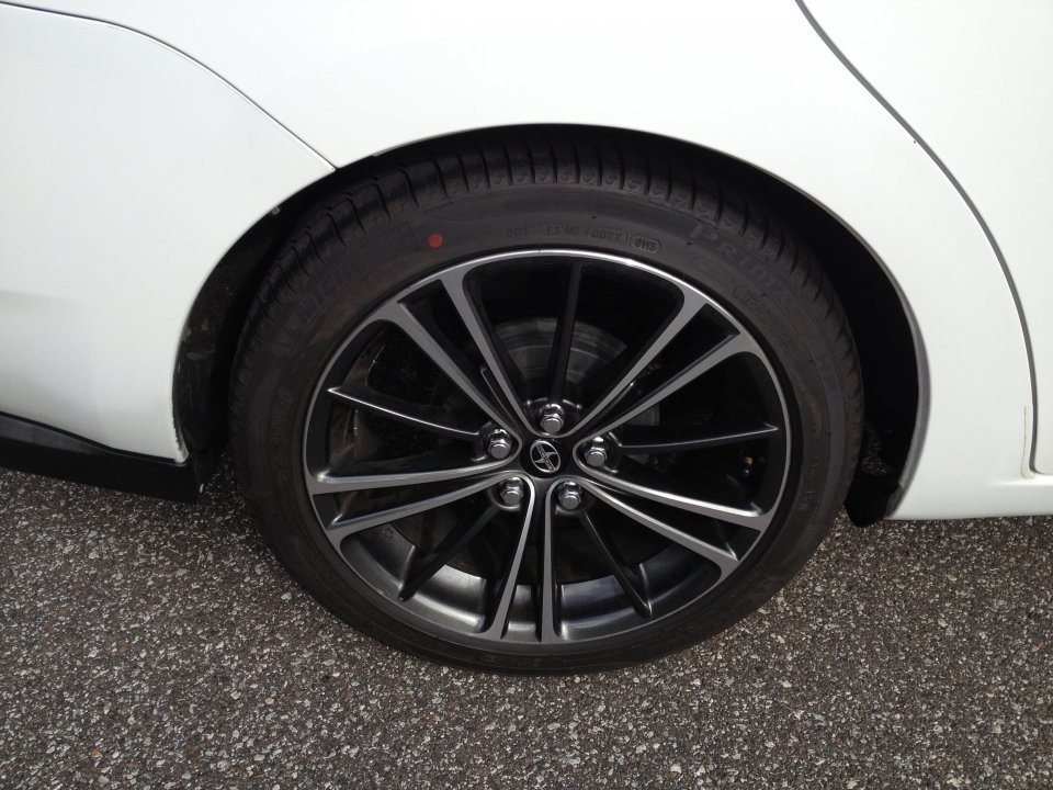

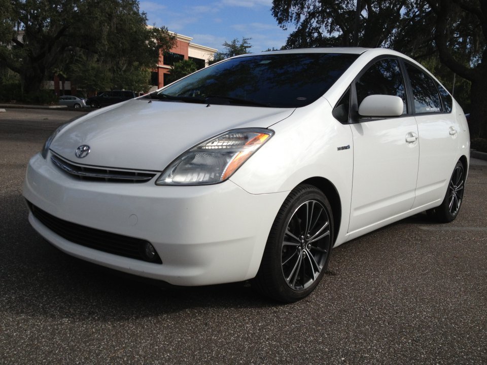

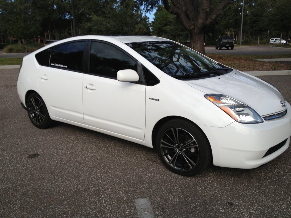

    I just got a set of Scion FR-S wheels and tires and put them on a 2008 white Prius. What do you think? IMG_7151.JPG IMG_7152.JPG IMG_7155.JPG IMG_7159.JPG IMG_7151.JPG IMG_7152.JPG IMG_7155.JPG IMG_7159.JPG IMG_7162.JPG IMG_7151.JPG IMG_7152.JPG IMG_7151.JPG IMG_7152.JPG IMG_7155.JPG IMG_7159.JPG IMG_7162.JPG

    sure looks better than oe, but how much they weigh?

    I didn't weigh them but avg MPG went from 60.4 last 2,000 miles to 52.4 this tank.

    look nice. what is the ride like?

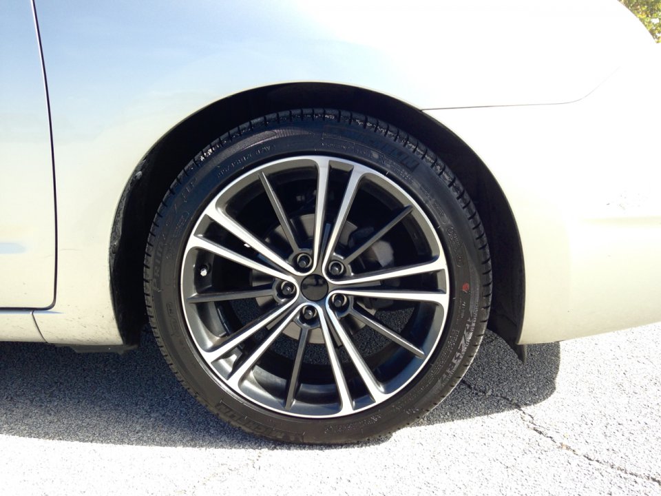

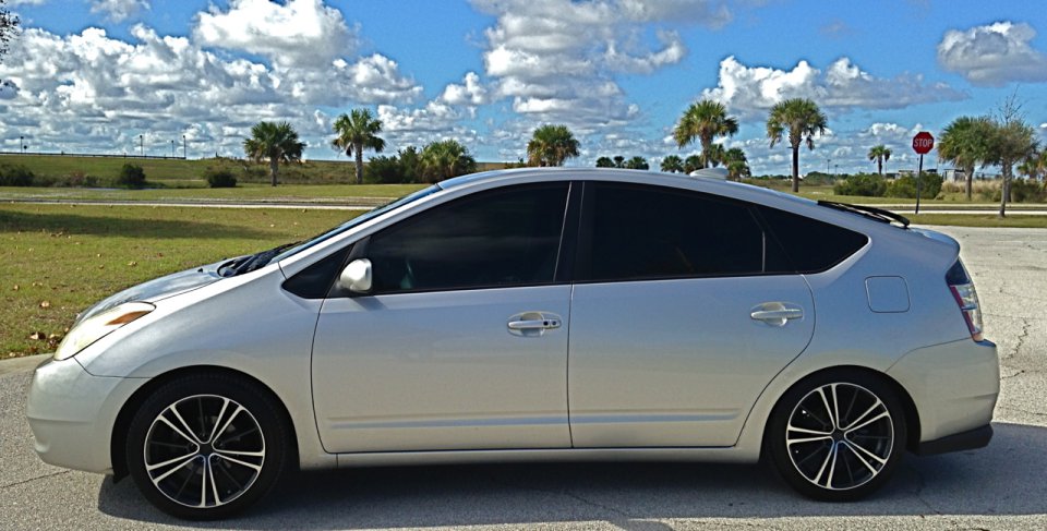

    Nice! looks really good on the white Prius. I just scored some as well last week on Craigslist for $350 with the Michelin Primacy's included (y) They ride very smooth and the car feels more stable when cornering. I've been noticing about 3-4 mpg less the past 5 days and thats with a loaded car with a bunch of music gear. Just make sure you get a pair of 3mm spacers up front.

    Nice! No clearance issues? The Gen3 has clearance issues with the brake caliper holders, need a 3mm spacer.

    No not that I've noticed. Yep, I had the guys at Cruisin Gold here in Melbourne add 3mm spacers to clear the calipers. I get about 45-48 mpgs but Im a slow driver ;)

    I had mine on without spacers but couldn't get the front caps on. Ride is very similar, maybe a little bit stiffer. I sold the car yesterday without the wheels so I will put them on a different one with spacers this time.

    Yes they won't fit without a minimum 3mm spacers at least for Gen II. I honestly don't feel the weight of these wheels and tire combo upon acceleration but the 3-4 mpg loss is definitely there but is pretty insignificant with the better handling and looks of the car.
