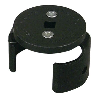

    So I went to the local Walmart, bringing the new oil filter along, to see what oil filter wrenches I could find. The Fram FA102 is priced at $5.97 and is an adjustable wrench which is supposed to fit 64 mm to 80 mm sizes. It is driven by a 3/8" socket extension and ratchet wrench. I decided to try that since the Toyota oil filter fits the 65-67 mm cap wrench.
    As an alternate, I also bought the Fram FM101 cap wrench which fits 65-67 mm sizes, although I was less optimistic that would help since it functionally is the same as the cap wrench I already owned.
    I found that the FA102 wrench works really well to grip the filter canister. As you turn the wrench counterclockwise, the sides of the wrench contract and therefore dig into the filter. In fact the wrench made a slight dent in the canister wall. Hence, there was no problem removing that balky filter.

    There are actually several different versions of the spacey wrench I found on Amazon -- some with rubber "grippers" over the jaws, some not. Here is one of the cheaper ones:

    Steve, that image you have is the FM, not the FA102, which apperently, is very elusive out in the interwebs. A Google search only turns up a small image from an old eBay listing. Perhaps Patrick will post a picture of the one he has? ;)

    Yes, I put up the wrong model number....and the FA 102 is even harder to find than the one I posted. I found that EBay pix. Not a lot of help, but I wonder if this Matco is a close match? Patrick?
    ADJUSTABLE OIL FILTER WRENCHES OF636 | Matco Tools

    Yes, I owned one of those in the distant past and it broke, so I do not recommend that design.
    Steve, that is exactly the same wrench as the one that I bought, except the Matco price is 2.5x the Walmart price... In case it is not obvious by looking at that photo, the curved steel "bites" into the filter at four places as the filter wrench is rotated counterclockwise, to secure a good grip on the canister.
