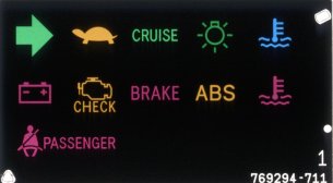

    ok so after driving the vehicle a couple hundred miles in a few days here is an update on the vehicle. The vehicle has no problem starting or staying running no more P3191 code. I did nothing it just went away (y) and starting running great. Maybe Frankenstein just needed a couple days to wake up from the dead. I am still throwing Fault codes P0141 and P0125. P0141 because the second o2 and cat are missing. P0125 insufficient coolant temperature i think is because its been cold out 10-20 degrees and the vehicle does not warm up fast enough so the ecu throws a code? Vehicle runs around 190 degrees and has super hot heat. I am going to replace the thermostat soon to see if that helps it warm up quicker and if not then i will just leave that code alone and forget about it. The power steering only shakes when turning tight left at very low speeds. I am going to leave it for now but if it becomes an issue i will just unplug the power steering computer behind the glove box, this will disable the electric power steering but should still be manageable to drive.
    The last question i have is when its very cold out and i start the vehicle the coolant light comes on the dash and once its warm the coolant light goes off. Is this just telling me the vehicle is cold and once the light goes off its at operating temperature? :confused:
    I am very happy i got this vehicle running as it will help me with gas mileage to and from work. Thanks to everyone that chimed in and taught me some new things about these unique creatures. I am a prius fan now (y)

    Yep, exactly. this is normal operation, at least for my vehicle.
    I'm skeptical the P0125 has to do with the speed of the engine warming up because the repair manual suggests the conditions that trigger it are tested only after the engine is "warmed up", although it doesn't mention a specific temperature.
    Looks like the primary thing it's detecting is that the upstream sensor doesn't report the exhaust is rich for a prolonged period, which corresponds to a high voltage from the sensor. This could be caused by a problem with the sensor itself or a short or open circuit (according to the manual), or it could be the fuel system, since I suppose this would also happen if the engine were just constantly running lean for some reason.
    The manual has some more diagnostic instructions, like reading the sensor voltage directly using a scan tool.
  15. ChapmanF
    28,750
    19,054
    If the coolant light you mean is the blue one (top right), yes, that's exactly what that one means.

    perfect ya its the blue one i was seeing only come on when cold. So i assumed it was indicating the engine is cold and not to operating temp yet. The only reason i thought this is because other toyota vehicles i have owned before always had a cold light of some sort. So thats a relief to know its nothing serious
