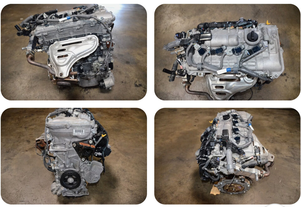

    Did Gen3 continue into the later years in Japan? Trying to discern how to tell whether an offering fits the bill. Goes along with the question, "Who are reputable sellers of JDM engines?"

    Yes and in Europe and Australia. There are specific JDM Engine Distributors in many big cities.
    The engine looks just like yours except the id plate and injector colors.
    Look for X2ZR-W20 on the engine instead of your engine’s X2ZR-W25. The injectors should be tan rather than blue. the US engine's pulley is grooved for a serpentine belt (w no belt used), the JDM's is smooth. A JDM engine's flexible fuel line is a smaller diameter at one end. Replace it with the original line.
