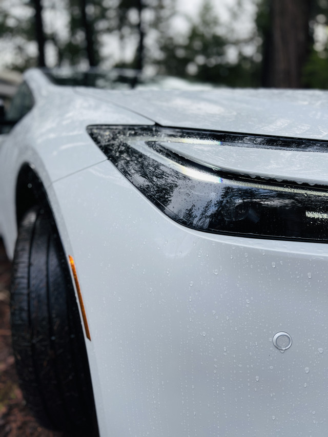

  1. Chi_weezy
    Chi_weezy Junior Member
    Feb 11, 2024
    35
    18
    Sacramento
    2024 Prius Prime

    Looking good!

    I have a limited white but I plan to go a bit darker with my tint. Maybe 20. Here is my baby!
