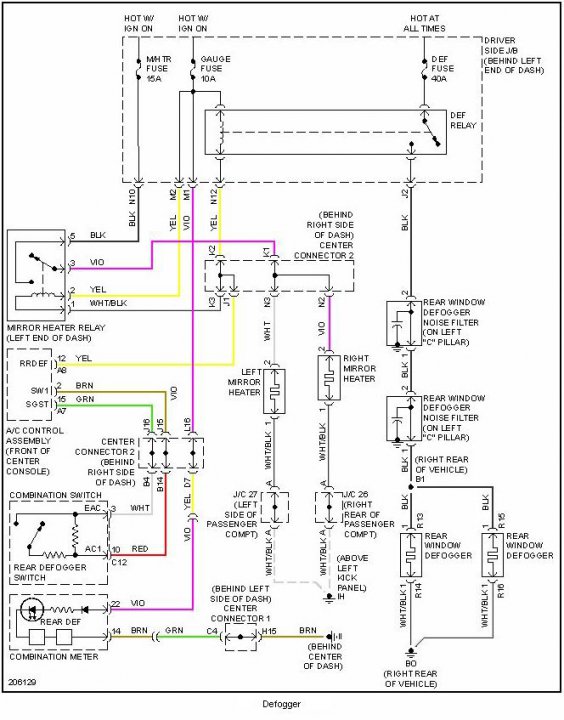

    i am able to have the front glass heater to come on like it was when i turned the car off, however every time i start the car, the rear has to be re-activated. is there any way to have it come like the front does with the starting of the car?

    If you connect to chassis (ground) the yellow wire in the center left of the diagram above marked (RRDEF) either directly or though a switch the rear defrost and mirrors will come on when the ignition is on and stay on till the ignition is turned off. (no timer)
