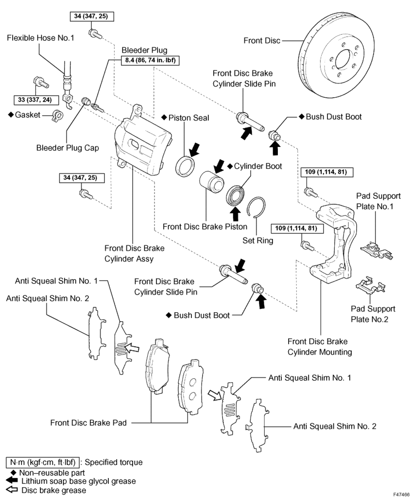

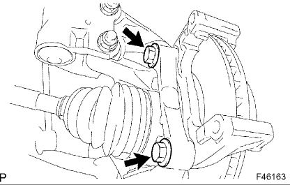

    This is the caliper assembly
    You *must* wait at least 2 mins after powering down the car, before attempting to remove the two bolts and caliper slide pin assemblies. If you fail to do so, the brake boost pump may run and the pistons will be forced out the caliper
    The slide pin will probably rotate when you attempt to remove the bolt. A skinny wrench - IIRC 10 mm - can be put on the machined edge of the slide pin to keep it stationary

  15. jayman
    jayman Senior Member
    Oct 21, 2004
    13,439
    641
    Winnipeg Manitoba
    I dunnu. They're paper thin, I wonder if you could grind them once?
    No, that is in the hub assembly.
    Sounds right. You may set the brake diagnostic codes I mentioned

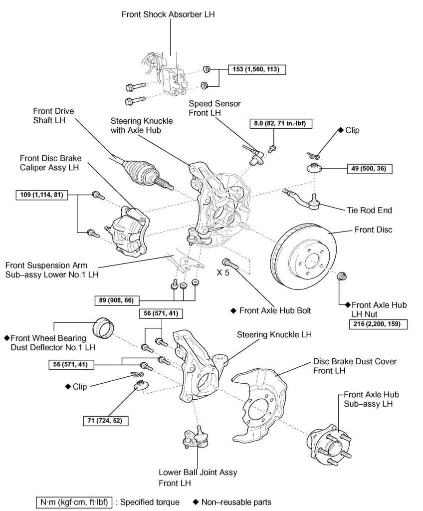

    After you get the caliper bracket off
    you must remove the axle shaft nut before the disk can be removed, to get to the hub bearing if need be
    I guess I should mention that you're taking on this job with no guarantee on my part. I'm providing the information "as is" with no specific guarantee of merchantability, fitness to task, etc
    The problem with the Prius braking system is the various sensors involved
    Get any of it wrong, you could lose all braking. There are various failure modes
    Only the dealership scantool can command the system to properly bleed the brakes
  16. richard schumacher

    Anybody able to tell me the tightening torques for the front caliper bolts, the slide pins, and especially the axle nut?
