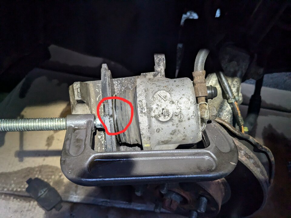

    I potentially have the same problem here, but I'm not fully certain that the piston is out. How can one tell? I am changing the wheel bearing and got in the car and accidentally started it, not realizing about the brake issue (should have read more). The piston moved out enough to push the pad out, but I can't tell if the piston is out of its sleeve.
    Also, if I were to open the solenoid using techstream (which i have), where can I find that in the software? Thanks!!
    blaisep likes this.

    You should have brake fluid leaking if piston is out of sleeve...
    I'm not too familiar with software, and not able to help you with that. But you could do it the old fashioned way, open the bleeding valve and press it back in and manually bleed any air out..
    blaisep likes this.

    @ttou68 You are a star! I can try the old fashioned way.
    It's amazing how such a small comment can solve a huge problem years later!
