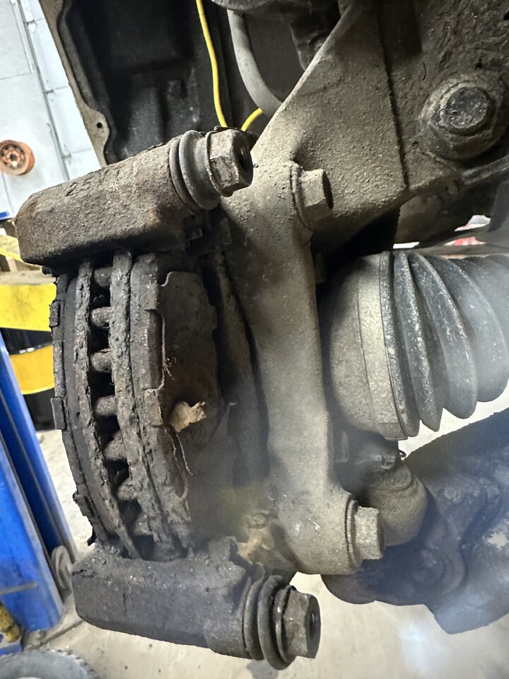

    Your tip with needing to remove the wheel bearing was perfect. That I did not forecast. The car I am going to work on is very rusty and should make for a fun time.
  19. lindylex
    lindylex Junior Member
    Mar 24, 2025
    Earth

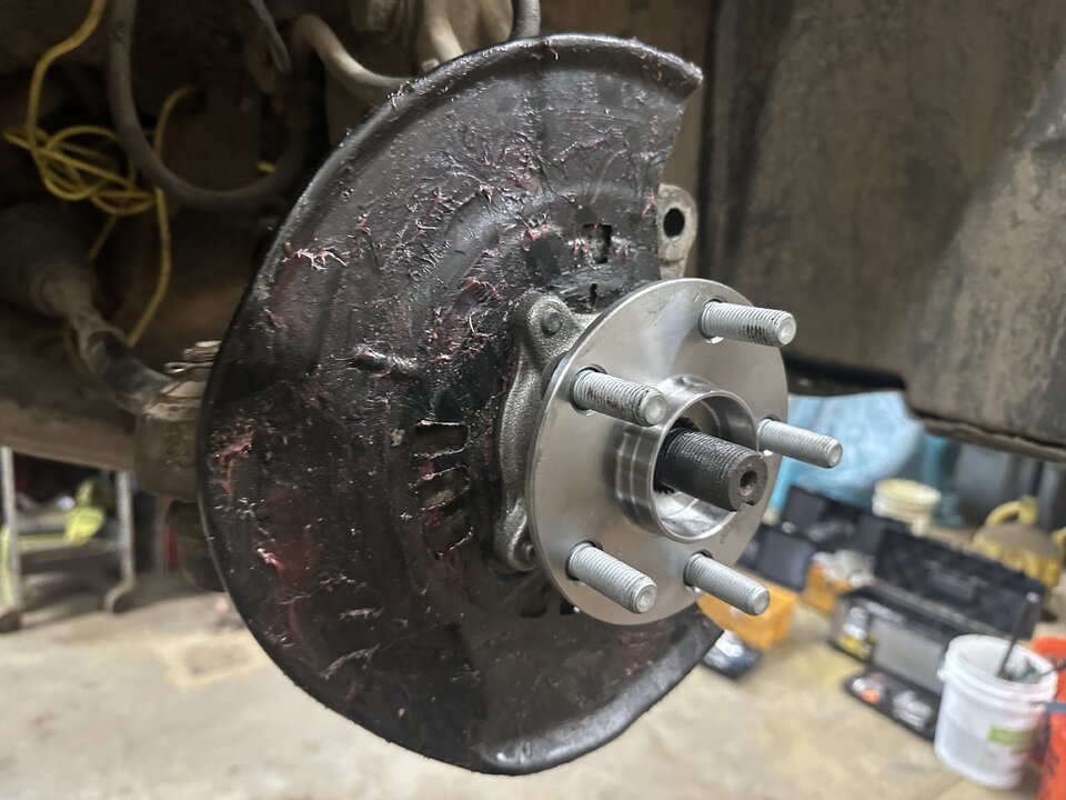

    All done and the first time around I tried to save the front wheel hub. I was successful but it took to long. I used a combination of heat, air hammer and final resort partial hub removal tool. The second time around with the same vehicle different weekend I continued this job. Instead of fighting I replaced both front wheel hubs and with the hub removal tool it took 5 hits and under 3 minutes to setup the tool and remove a wheel hub verses 90 minutes of being kind to the first hub trying to not remove it.
    Attached are before and after photos. I coat the brake backing plates with high temperature grease to create a barrier that protects the metal from the corrosive effect of salting the streets.
  20. ChapmanF
    28,689
    18,994
    The idea of that much grease that close to some brakes makes me anxious.
