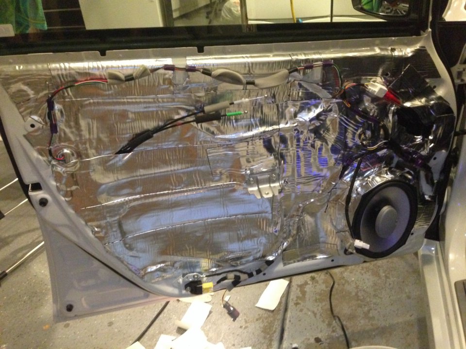

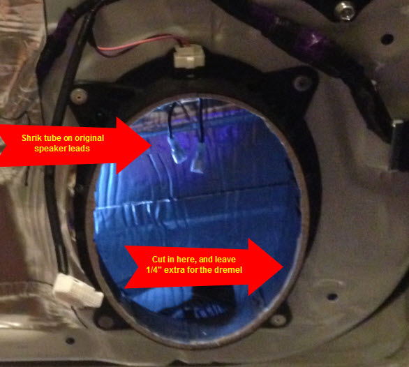

    Here are some pics for the door speakers though. I did not use any brackets or spacers. Just dremeled out the old speaker using the following method. Note this will fit the infinity 9632x9633 6x9 like a glove, but I'm not sure on any other speaker.
    1. Punch a hole in the paper speaker and start ripping it out as much as you can. SAVE as much of the copper leads from the OEM terminals, as possible as you will reuse those.
    2. Use a flex blade flush-cut saw or mini hack saw to cut out old speaker reinforcement brackets which is the actual oem speaker body. Do a rough cut first leaving about 1/4" space b/t the lip and the inside wall of the bracket
    3. Use a dremel tool with 1/2 sanding band 60grit to grind down the inside bracket lip until you get a nice snug fit with the new infinity 6x9. It should be as tight as possible so check a lot and don't sand too much. I have about 2-3 mm all around. Remove the old foam as you will use the one that comes with the new speaker.
    4. Put some shrink tubing on the original speaker leads and female terminals.
    5. Apply foam that comes with the infinity on the back of the speaker on the outer edge.
    6. Dry fit the speaker, it should be flush with no movement. (do not attache wire yet). Drill 1/8" pilot hole slight at an angel towards the metal of the door or away from the bracket so as to hit some metal.
    7. Hook up speaker with terminals and screw in with 2" #6 sheet metal screws or 2" drywall screws. If you stopped here you would be a happy camper.
    8. Optional, Add some Peel and Stick, it does make a difference and the speaker sounds 25% louder for bass and gives you a little more insulation from the road noise <10% effective though for noise. I did the inside and outside skin and used a little over a role per door. The door is about 6-7lbs heaver and closes like my Lexus :)

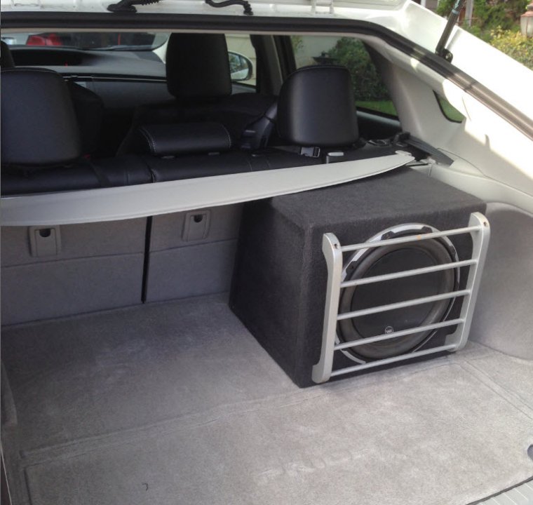

    And my new soon to be addition.... goes right under the sun shade and allows me to get to the hidden storage....why not use it :)
