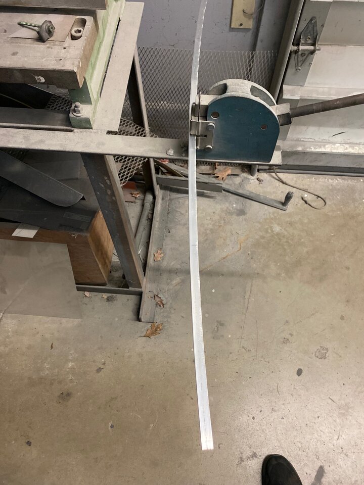

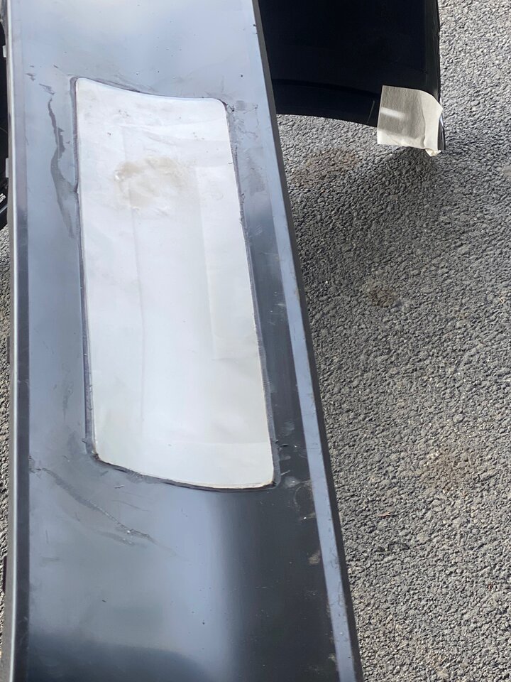

    I couldn't stand the buck tooth front license plate bump. I made a 3 dimensional mold and then thermoformed a polypropylene plate the same thickness as the bumper cover to bond to the bumper cover after I cut off the front license plate buck tooth. Bye bye buck tooth! I also made an aluminum moulding to cover the wide gap in the rear hatch where all the wind noise comes from, it's now as quiet as my Lexus LS 500. I trashed the foam in the trunk and lowered the floor 6 inches. I covered the front end noise speaker with duct tape and muffled the sound. I added 2 horns, hi/low and got rid of the squeaky horn. Then painted the lower sill cover to match the wheel opening black which gives the impression of a narrower car shape.Then added the stainless steel window mouldings and lower chrome trim, tinted the windows and blacked out the rear window since I have the digital rear view window. All this was done when I had 42 miles on the odometer!
    Cheers

    The original black plastic plate holder can be screwed back on in place over the bumper cover as the contours are exact.
