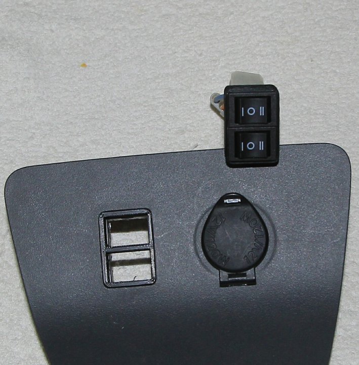

  2. GregP507
    GregP507 Senior Member
    Apr 5, 2014
    3,002
    481

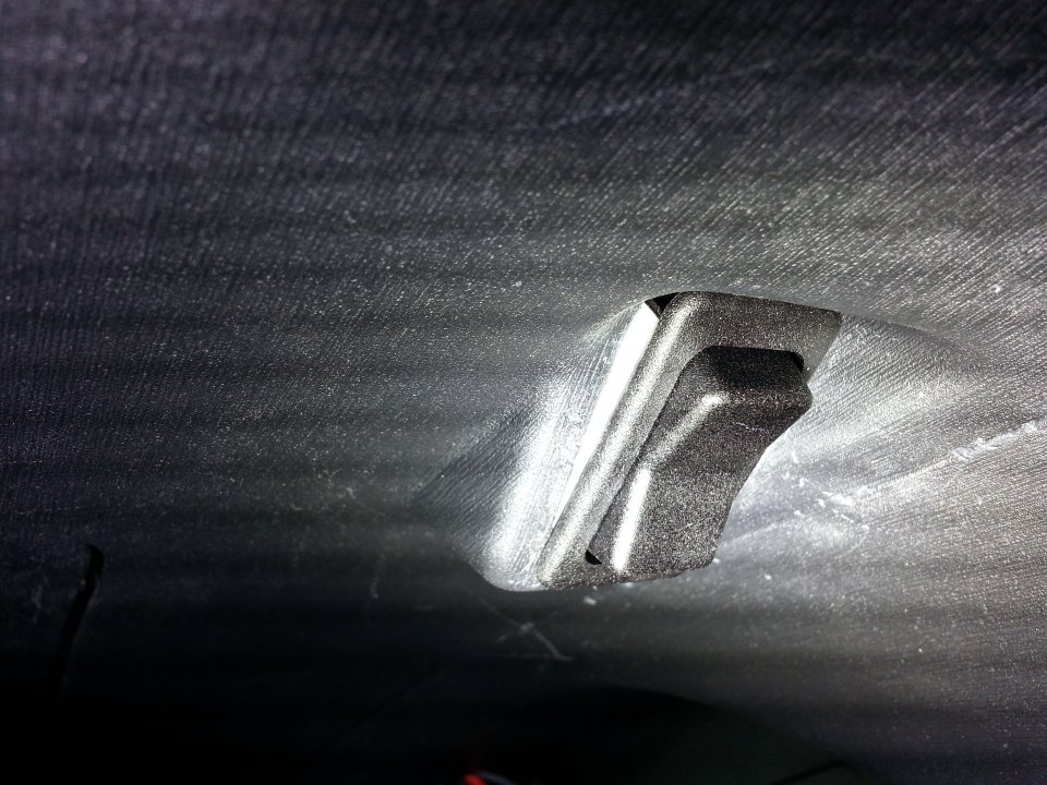

    I was looking to buy a switch that would fit in the existing blank to the right of the steering wheel. I also wanted a 2-color illuminated switch. As it happens I won't need the center-off position, because power will be supplied when I tap the parking brake. I wanted to make it as simple as possible, so once I get it wired, it will be a simple matter of selecting the VTR input, and pressing the parking brake lightly. The red or green light in the rocker switch will light up, telling me which camera is on, and I can select between the two.

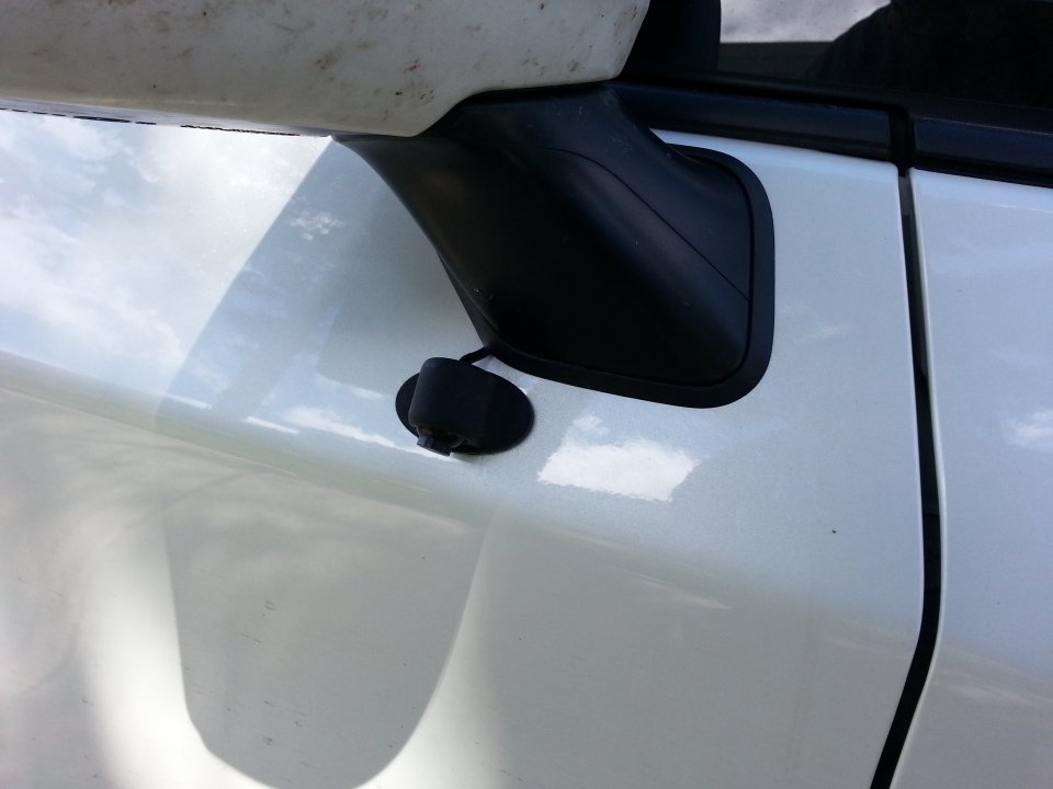

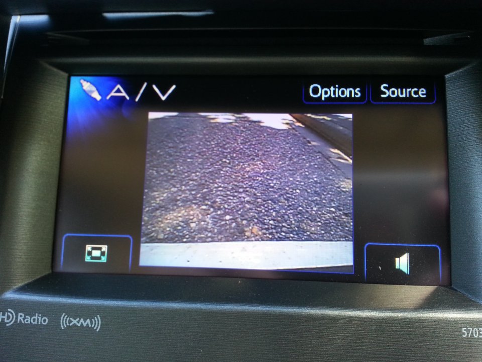

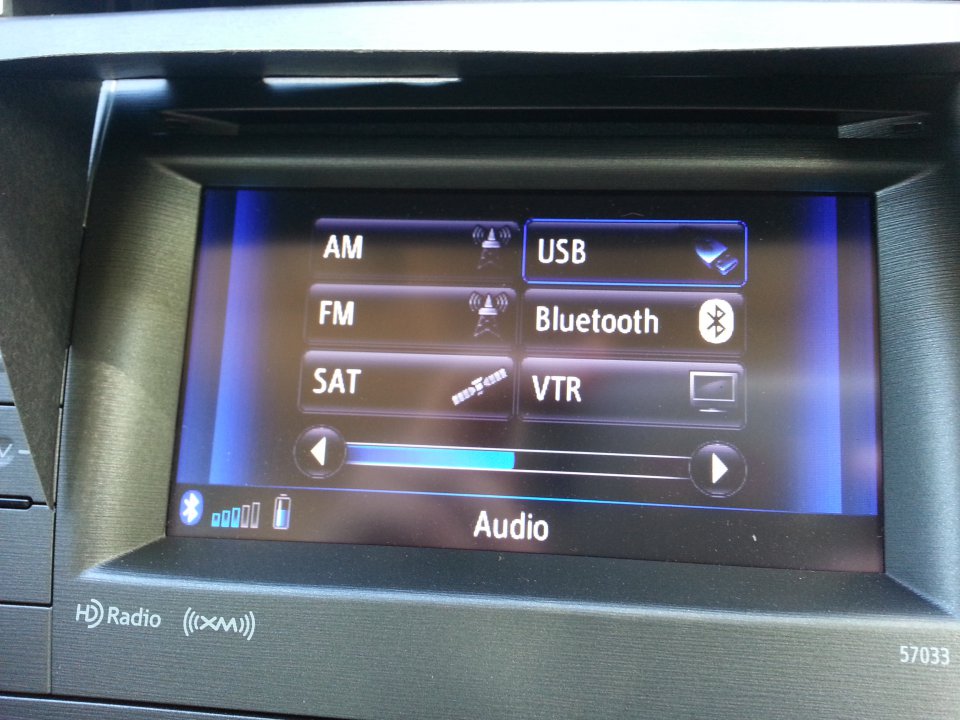

    I'm now finished the project for all intents and purposes. I now have two cameras in addition to the backup camera. To activate either one, I must be traveling slower than 5 mph, and tap slightly on the parking brake pedal to enable this feature. From the "audio" menu, I select the "VTR" source. A two-way rocker-switch is mounted in the dash to the right of the steering wheel, which selects either camera, or in the center position, both are off.
    Both composite video leads are teed together into the auxiliary video input of my head unit display. The rocker switch supplies power to one or the other, or neither in the center position. This works very well for turning on either camera. The side camera is mounted under the passenger mirror, and the cable feeds into the bottom of the mirror mount, past the rubber gasket. It looks very neat and almost factory-issue. The double-stick adhesive supplied with the camera was almost useless, therefore a bit of urethane glue held it in place. It also makes it easily removable without affecting the paint. All the wires are tucked away behind the dash and tied out of the way. The main power for both cameras comes from the lighter-socket in the lower center console. The cameras are easily adjustable, as they are basically like an eyeball in a rubber socket. I had to turn the image 90-180 degrees, which was very easy to do by turning the camera in the socket. Both cameras have jumper-loop wires which can be snipped to provide parking lines, and to flip the image to mirror-image, but I saw no reason for doing so.
    It's probably not a big deal, but I may eventually install indicator lights in case I leave the rocker-switch on, but in any case, all power to the cameras is off when the car is shut off.

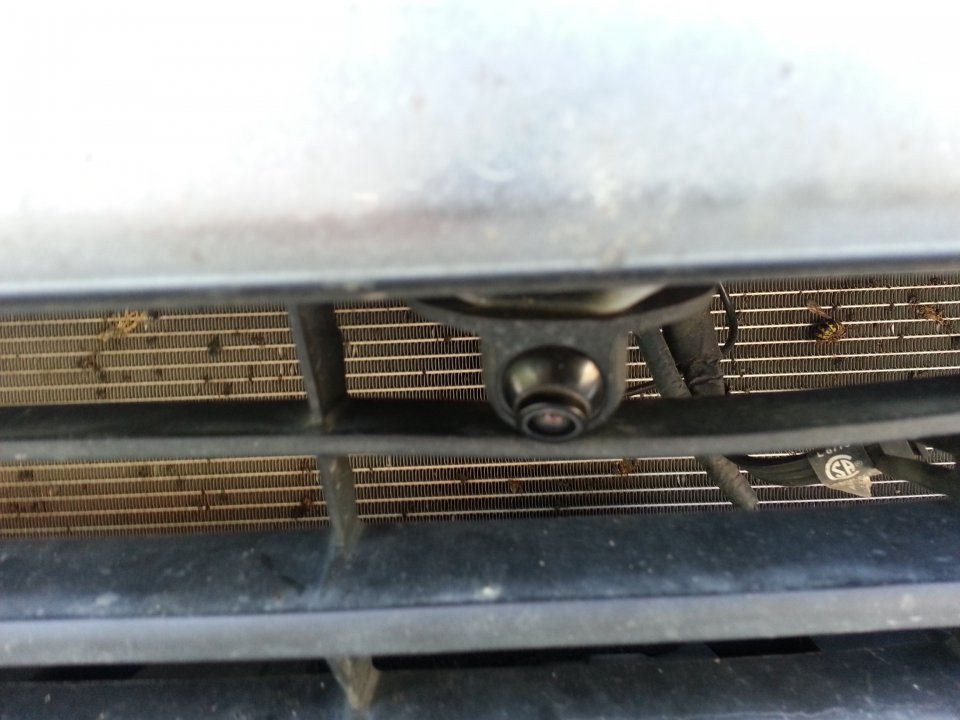

    The original problem was that in spite of my best efforts, the front spoiler on my Toyota Corolla would collide with obstacles when I parked. It was very difficult to judge distances, and to judge heights. The result was that after a number of such contacts, the spoiler was broken and scuffed, which significantly affected its trade-in value.
    A parking sensor would have beeped to tell me the object was there, but I already knew that. The problem was determining whether the spoiler was high enough to clear it or not. I didn't want the same thing happening to my Prius. I've used my front camera now on several occasions, and I'm very pleased with the results.

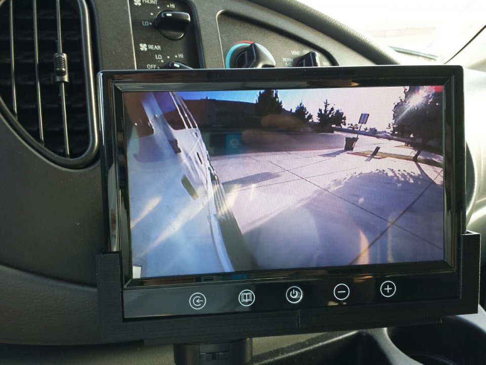

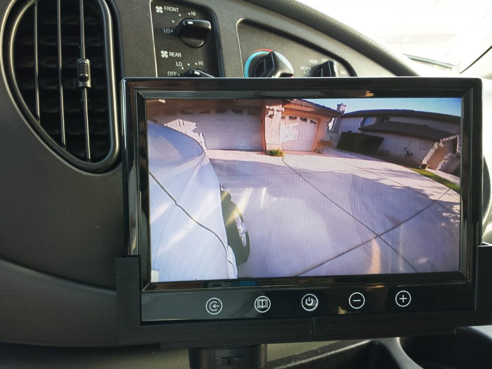

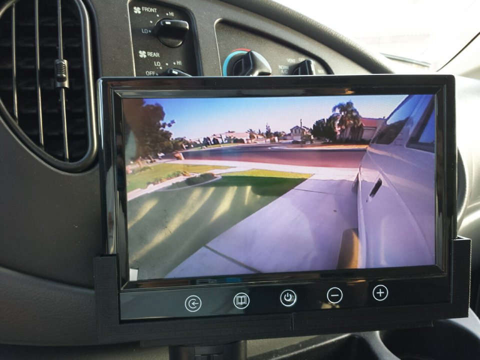

    Another update: Both cameras are working exactly as I expected, and I use them frequently when I'm parking. The passenger-side camera doesn't provide a field of view useful for traffic, and only shows a few feet out from the side. It would require some extensive modifications to be incorporated into the right-turn signal, for viewing the blind-spot (as in the Honda) as I had initially conceived.
    And the video screen is not disabled over 5 mph as I originally thought; it's more like 1 or 2 mph. To use it for parking, you have to be moving very slowly.

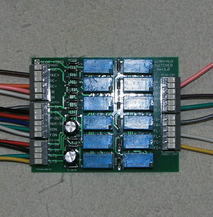

    I have a completed and test my video switcher on post 17. It works exactly as I designed including turn signal switch just like the Hondas. It uses the rear camera video input instead of VTR so there's no speed restriction. It works at any speed. I'm looking to get $150 for it if you're interested. Unfortunately, I have no wiring diagram for the rear camera for the head unit. I'll post a picture of it when I get a chance.

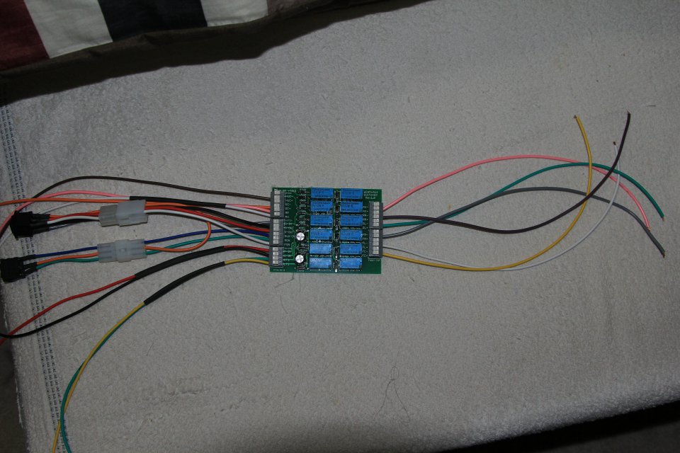

  8. cproaudio
    cproaudio Speedlock Overrider
    Jul 7, 2010
    2,401
    762
    CA
    Reverse camera is speed independent. It operates regardless of speed. Feeding the reverse signal wire with 12V to the radio (does not effect rest of car i.e. reverse light, R indicator on dash, reverse beep), activates the factory rear camera. It also supply power to the rear camera.
    There are 3 wires that need to loop into my switcher then loop out to the head unit. the reverse wire, the rear camera signal + and -.
    My video switcher has an "active out" positive 12V output. It is intended to activate my speed lock bypass. However, you can use it to feed power to all your cameras.
    For your application, you'll only need to connect the turn signal that you have the camera on. In your case, it's the right turn signal. The only time you'll get a black screen is when you activate the front camera and you turn the right signal on and it's only because you don't have a right front facing camera.
    If you want to tie multiple camera's signal wires together and control which camera receive power, you'll still need a power distribution switch. If you build you own, you'll end up with a schematic like my switcher. If that's the case might as well do it the right way and switch the signal wires only.
    Pictures below are what my video switcher and the dual switch look like.

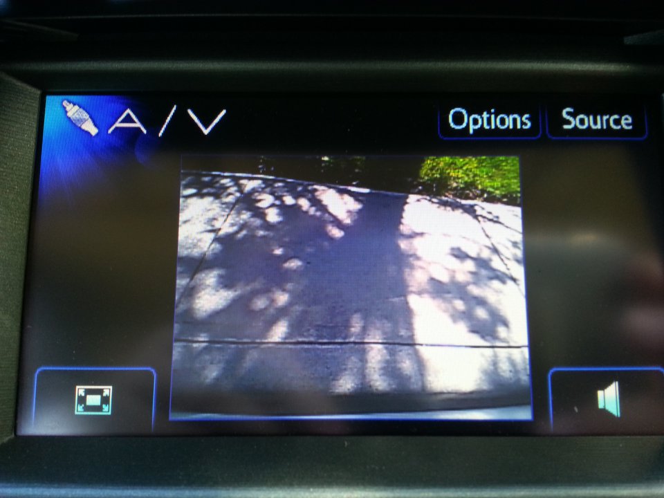

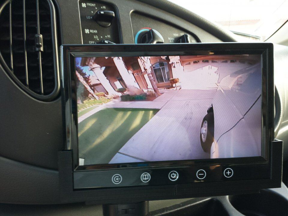

    I'm looking for cameras. The one you listed shows 170 Degree viewing angle. But, the image on your head unit don't even look close to 170 degree. It looks less than 90 degree.

    When you order direct from China through AliExpress, you never know if the descriptions are accurate, or if they simply don't understand what they are describing. It's always a risk, but you do have a 100% satisfaction guarantee, and the prices are usually extremely low.

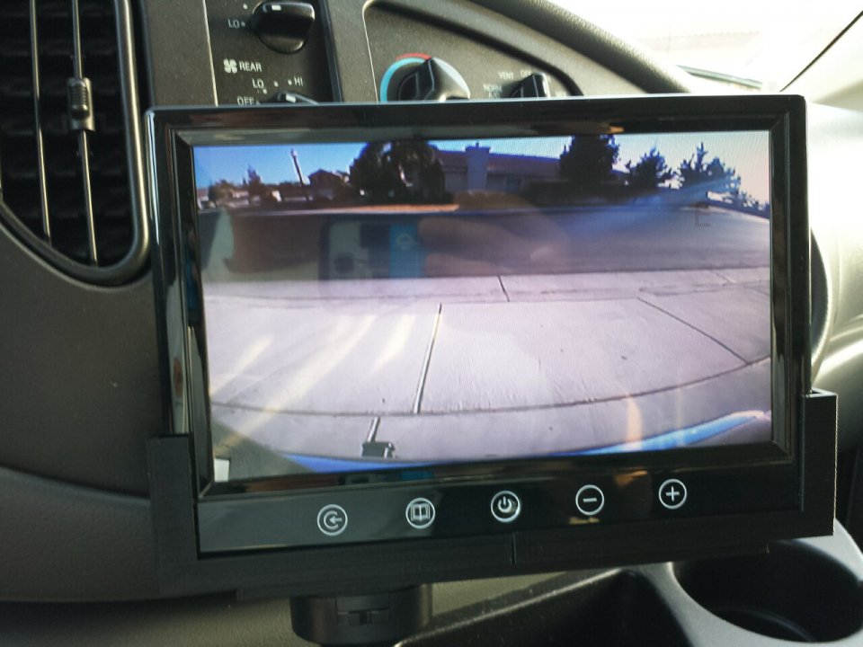

    Can you do a test of what coverage angle the camera has? The camera you ordered seems to be the most versatile as far as application and installation.
  12. GregP507
    Apr 5, 2014
    3,002
    481
    M
    My best would be about 100 degrees.

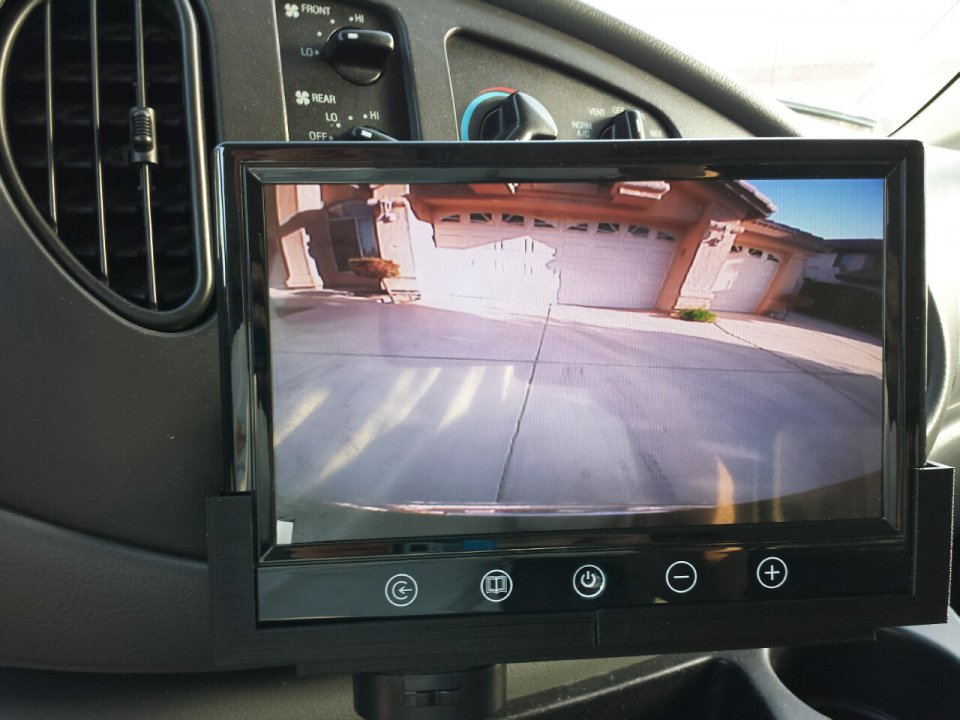

    Got my 6Cam Switcher project done. I removed the radio to mount the 9" LCD. I can manually switch to any of the side views or use the turn signal to switch the view. It makes parking and U-Turns a lot easier.

    I used this camera. I don't recommend it. The video is not as good as the stock Toyota camera. The only reason I bought it is because it features selectable mirror image and it allows for adjustment in just about any direction once it's mounted. Also because it's rotates 360 and no markings for top up, I had to do numerous adjustments to get the pictures aligned properly. As for multiplexing, you're looking for something that Nissan uses. My mod is switcher only hence the 12 DPDT relays on board. It has no video processing at all. It'd be nice to show all 6 cams in 1 video but I don't have that kind of knowledge.
