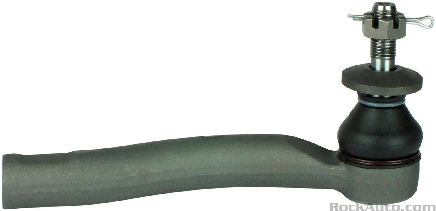

    My new tie rod end came with this style of nut:
    Will this cause issues?
    The factory ones have more of a "flange", I think.
