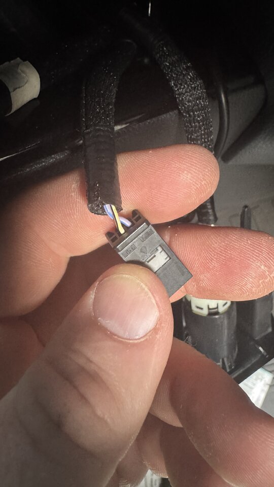

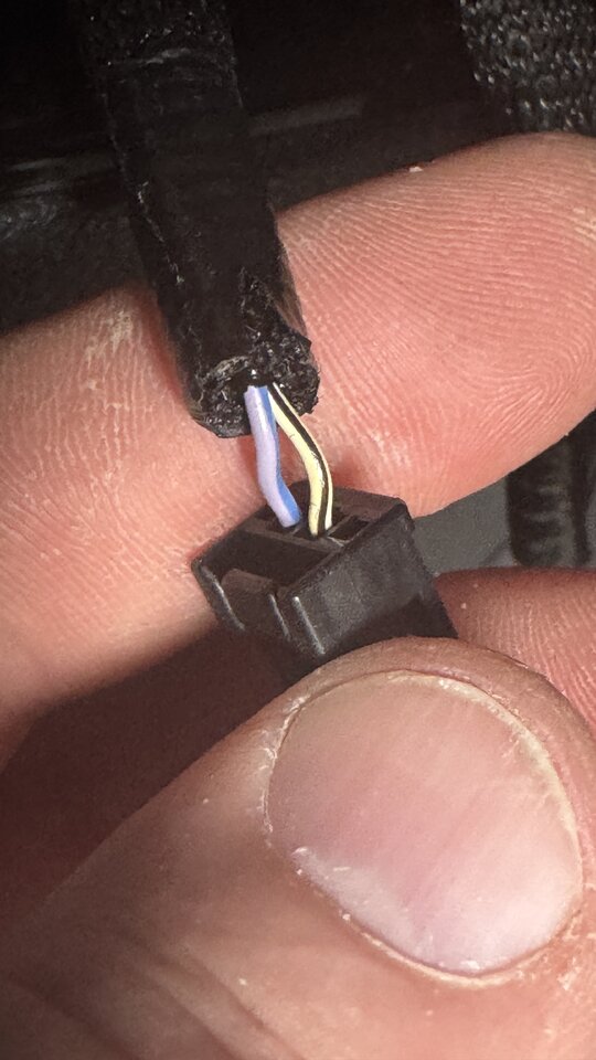

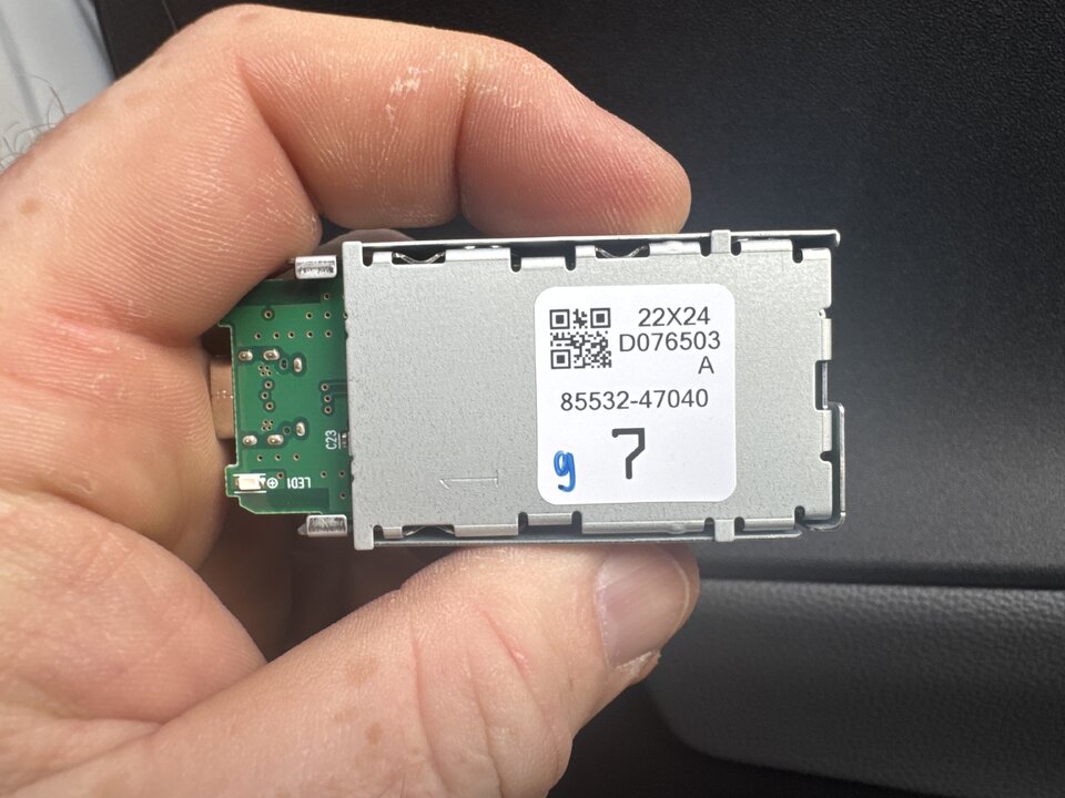

    Took the unit out, inspected the color of the wire and it showed that I have a..
    Purple with blue stripe. Absolutely NOT the blue wire I was looking for.

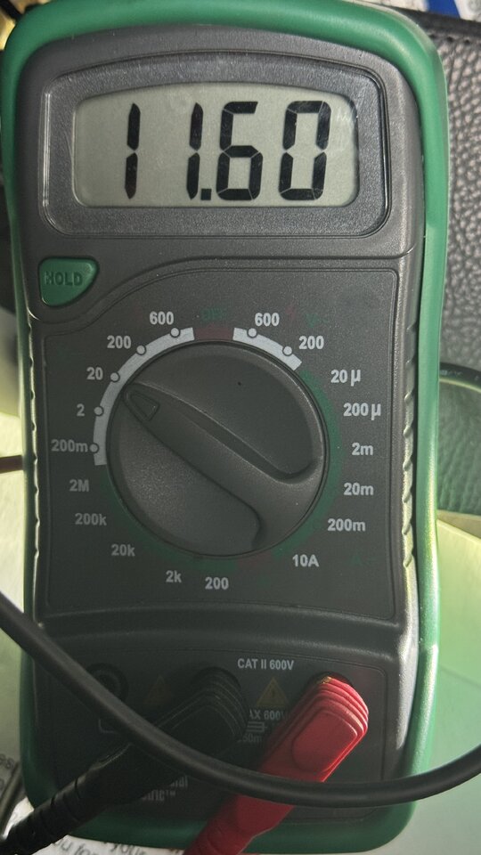

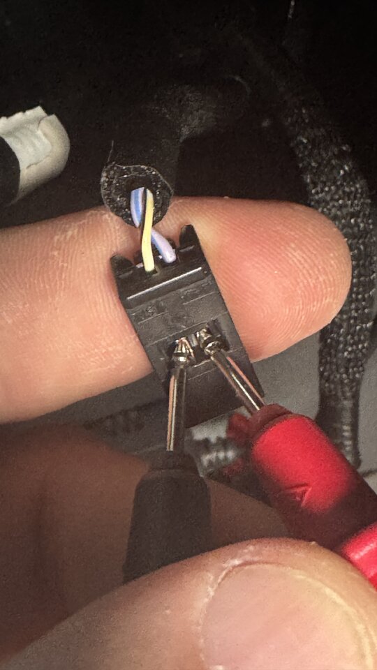

    Hmmm. So I popped the cover off the plug and did a voltage test on it.
    I’m getting 11.6V. So there is power to the plug.
    Hmm I says.

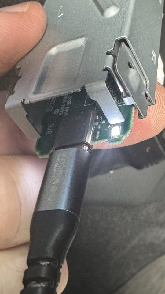

    plug the USB-C port back into the harness. Light comes on.
    Now wait a hairy second.
    Plug my phone into said USB cable. Now it’s charging.
    I blew out the usb plug and inspected everything. I can’t find anything wrong with the 12-5v adapter on the circuit board, plugs etc.
    Maybe dust in the connector?
    Either way, here we are with a fixed outlet.
    For reference: the PN on the back of the plug:
