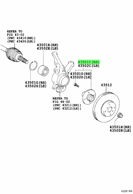

    There's this Toyota part number 43502-52030 that I think may be just the hub itself. (Earlier this very day I was thinking it was a whole knuckle/bearing/hub assembly, but now I'm thinking I was fooled by a misleading photo.)
    One remaining question might be whether a genuine Toyota hub would perfectly fit to replace the hub in an aftermarket knuckle/bearing/hub deal.

    Looking at the parts breakout you posted…..where (which part) does the speed sensor read off of?
  6. ChapmanF
    28,720
    19,019
    If I understand things right, the magnetic strip should be incorporated into 43502K.
    At least, that's what I take away from that earlier thread where it was discussed. Maybe there's more detail in that discussion.

    I’ll try to find that old thread. The “K” in the part you provided is the entire assembly. I’ll try to find out which individual part carries the magnetic ring. Thanks Again
  8. ChapmanF
    28,720
    19,019
    The blue words "that earlier thread" in post #5 are a link to that earlier thread, to make it easy to find.
    From this diagram, I think I meant 43502E—the donut-shaped "generation 1 hub bearing unit". That's the thing that (I believe) includes the magnetic strip.
    Before I zoomed that image to full size, the E was looking to me like a K.
