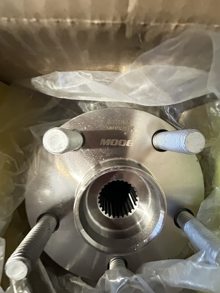

    Here is the Moog. from asia ..
    I am holding off for clean up and anti-seize
