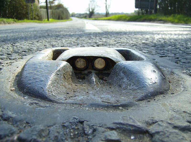

  11. Former Member 68813
    Oct 3, 2010
    3,524
    983
    US
  12. El Dobro
    El Dobro A Member
    Jul 12, 2011
    7,103
    3,282
    The UK ones look pretty big.
  13. David Beale
    David Beale Senior Member
    Jul 24, 2006
    5,963
    1,990
    Edmonton Alberta
    Well you're not supposed to be driving with your wheels on the centre line! And when you cross it the game is to do so while missing the reflectors. ;)
