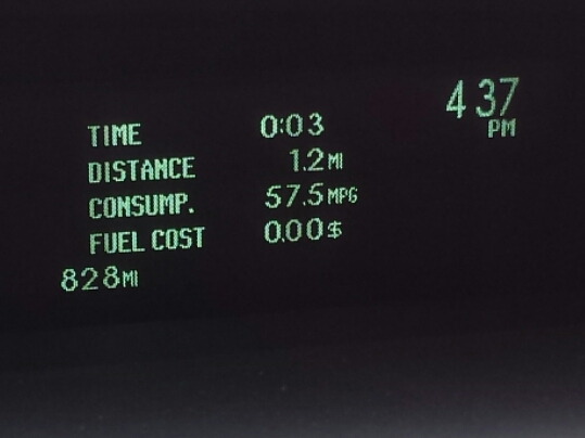

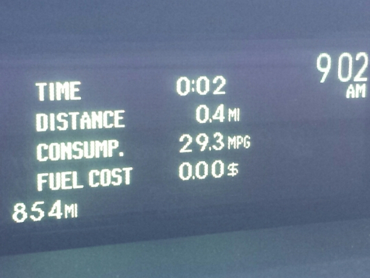

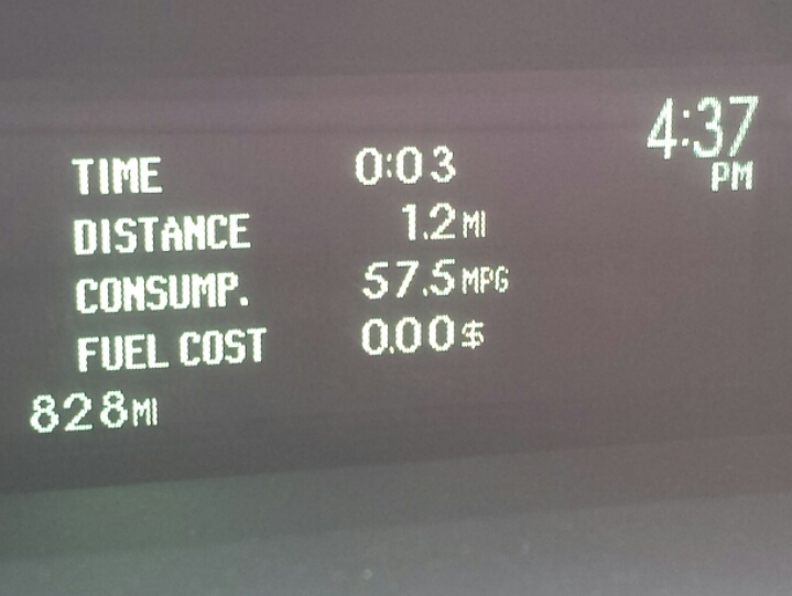

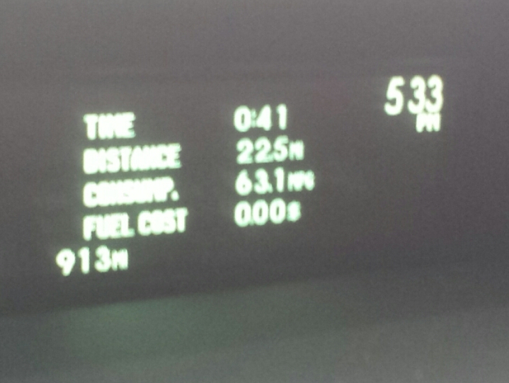

    I take it this is something that the dealership needs to fix. Is anyone else experiencing this problem?

    Did you bring up the settings menu on that display? Cycle through the displays until you get to the settings. Fuel cost is a sub-menu item.
  3. drysider
    drysider Active Member
    Apr 14, 2008
    823
    332
    Liberty Lake WA
    Press Disp on the steering wheel until Settings comes up. Then press and hold the Disp button on the steering wheel. The first choice will be gasoline cost.
  4. SquallLHeart
    SquallLHeart The Techie Guy
    Mar 10, 2012
    826
    247
    San Jose, CA
    you need to input how much gas per gallon is for it to show you how much your trip cost.
