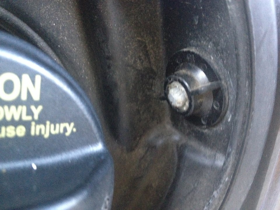

    I thought I uploaded this picture yesterday -- it does not seem to have stuck.
    I looked at the pin that is operated by the cable into the fuel door well. Could it be broken off? It is very short, protrudes only about 1/8 inch, and barely moves when you pull the lever in the driver's compartment. Here is a picture:
  9. Mendel Leisk
    61,429
    42,271
    Yeah that's not right. Took a look at ours; it's sticking out a bit more than 1/4".
    In your pic it looks kinda chewed up: maybe someone pried it open to siphon gas, sheared it off??
  10. bisco
    115,323
    52,784
    from the picture, it looks broken off. mine is about half an inch long.

    My pin looks that way when it got stuck in the open position, I used a needle nose pliers to pull it out, then used some dry lube spray, but it happened again. I then bent the flap on the fuel cover door in a little bit, until it just barely would catch on the pin, and now remember not to pull all the way on the fuel release lever, just enough to release the flap and haven't had the problem again.

    Okay I will try with needle nose plier. I used a long nosed plier but that did not grab the pin.
    Is it possible to trace the cable? Where do I have to look?
